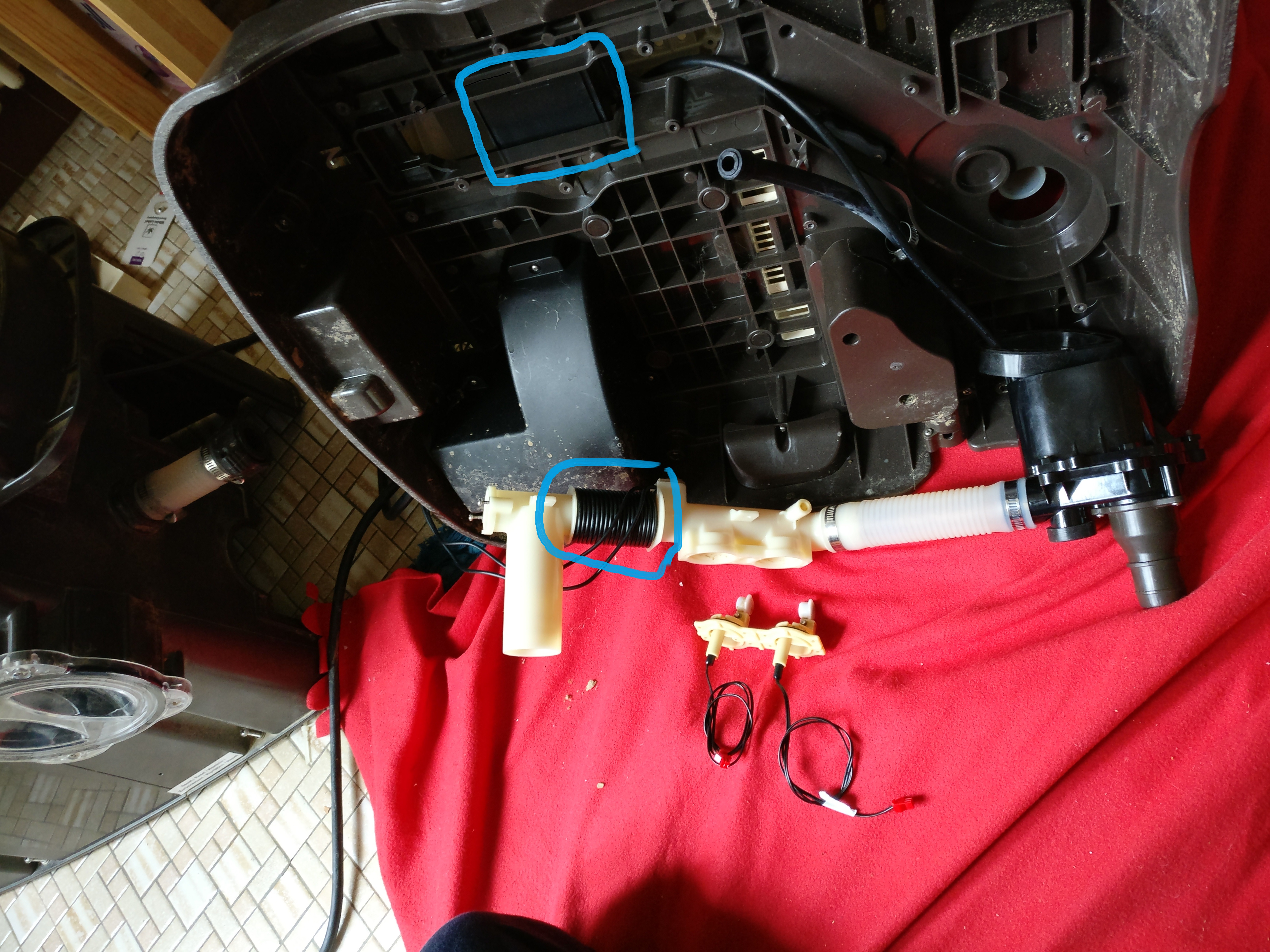

    bipuk
    Posts: 28
    I have a problem with the jacuzzi pump, error E90 is displayed when the filter pump is turned on, which, according to the instructions, means the lack of water in the system. The pump connected "shortly" to the power supply works ok and filters the water. I was looking for a sensor that is responsible for checking the water level and after dismantling I found a system as in the picture. Two magnetic sensors (signed on the motherboard as flow1 and flow2) when the water flows are raised and close the system, causing the resistance to increase to ~2.2 Ohm, and a bit further a wire is wound in insulation (braid) forming a kind of coil, which is located directly under the AC transformer, on the board the connection is signed as scale + and scale -. I don't understand what is the task? is it related to flow sensors? Sensors after permanent contact (as if creating a full flow) and switching on the device display another error e96 (system error) Can anyone help?

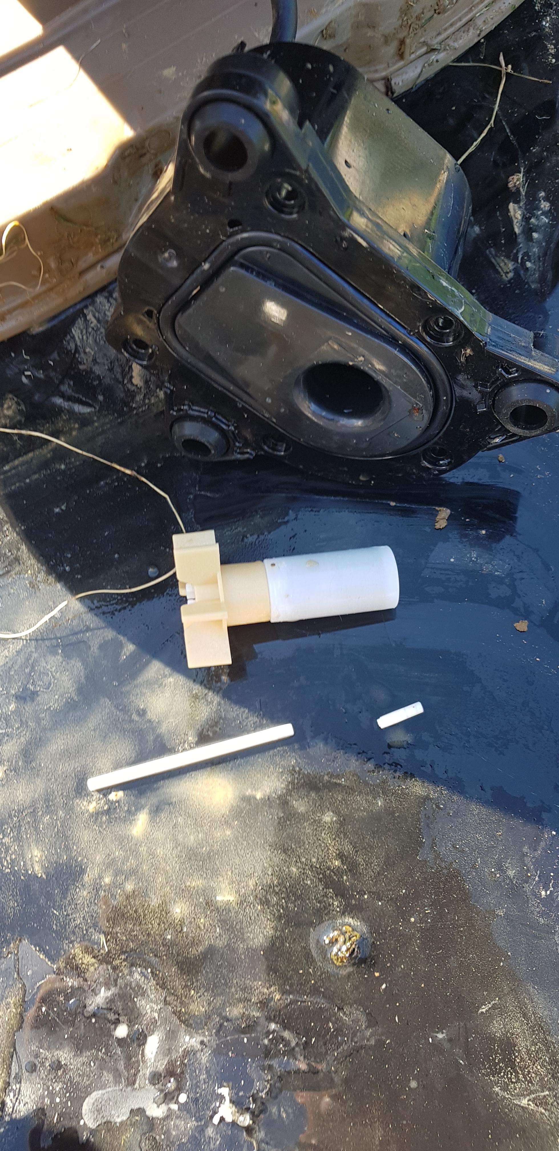

    I have the same problem as before the speaker.
    The water filter pump will not turn on. After 10 seconds error E90 pops up and squeaks. Papa checked briefly works.
    You have a solution what is the cause of this problem and how to solve it
    Added after 24 [minutes]:
    I found the reason for the filter pump not switching on. And error e90. The reason is a broken rod holding the impeller in the pump. After replacing the rod, the pump became dead and the error disappeared

    This is unbelievable. I have been using the e90 for 3 years and it has indeed failed twice. The problem is that the rod in the rotor axis is made of poor materials and breaks. I explain this in a video on my youtube channel @iroexplorer. Please see. It makes no sense to convert the heating in such a cheap jacuzzi in my opinion. This rod together with the rotor are penny issues and the replacement is very simple.

    >>20680738 There is no need to replace the entire pump. The repair kit, i.e. impeller, stem and guide pre-cup is 95% of the cause of the E90 error. Replacement is trivial. Anyway there is a YouTube video about it my @iroexplorer
