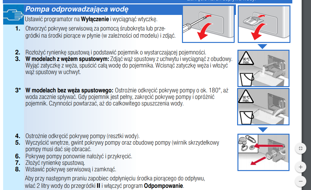

    Hello, during the spin cycle, the washing machine started to make strange sounds, it did not drain the water, it stopped and this error appeared, there is nothing in the manual about it, also on the Internet ? anyone knows what could have happened?
    I found. There is probably something in the filter and here is another problem, because we've tried to take it out before and it's simply impossible to use China, is there a "trick" for it?

    This is what I found in the manual.
    • Siemens WM14T6A2 / 01 IQ500 Washer - Error E36-10, Drainage Issue, Filter Removal Tips Filtr.PNG (331.63 KB) You must be logged in to download this attachment.

    Yes, I've seen it before. But the filter can't be unscrewed, it's twisted but won't go out ..

    From what I've been working on, the insert is often blocked by the stone that is deposited on it. The only thing I can do is try to descale it with household appliances. So drain the maximum water from the washing machine and pour a few liters of diluted agent and wait for half an hour and try to remove it again. Unless it is blocked by something like a wire from a bra - then only disassembly of the whole thing and then you will know what and how.
