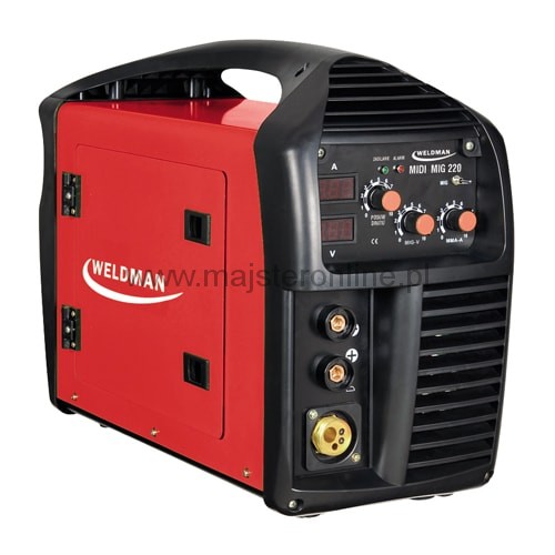

    Hello all
    He purchased an inverter migrator for small home work MIG / MAG WELDMAN MIDI MIG 220 MMA
    There are two knobs for setting the MIG welder, one is the wire feed, which also regulates the welding current (at least I think) and the second knob setting the welding voltage. What is the relationship between these knobs, how to set the welding voltage ?? At the moment I am setting the voltage by trial and error.
    I am asking you for a brief instruction on how to set up such a welder.

    Voltage (and indirectly current) depending on the thickness of the material being welded. Advance so that your pipe does not repel, because if you give it too big you will feel clearly that it repels you. If it's too small, the wire in the husk will burn you. Wire the wire no further than for 8mm (between 5 and 8mm), gas 8-10l / min (but it also depends on the diameter of the husk, with larger diameters more gas).

    In this welding machine you have two knobs from MIG / MAG and one from MMA. Extreme on the right is the MMA knob and you set the welding current there. The middle knob is the MIG / MAG welding voltage and the extreme left is the feed rate. The rest, as the colleague wrote above, the wire would not repel and not burn him, and the tension depends on the thickness of the material. V / mm tables are available, which will help you to start adjusting the tension to the material thickness.

    Hello . Buddy, do not bother with the tables. The tables are for theoreticians who have practical knowledge about welding like wolves about stars. Collect different bald thicknesses from 0.6mm to 6mm. Then start with the thickest ones. Set the MIG / MAG welding voltage to half of the range and the wire to the middle of the range. Pave two pieces of sheet metal. If the wire will repel the handle, increase the voltage but if the edges of the weld are flooded, reduce the wire. I will tell you only that practice and once again practice. After some time you will know how to set the material thickness for yourself and nothing will happen to the tables.
