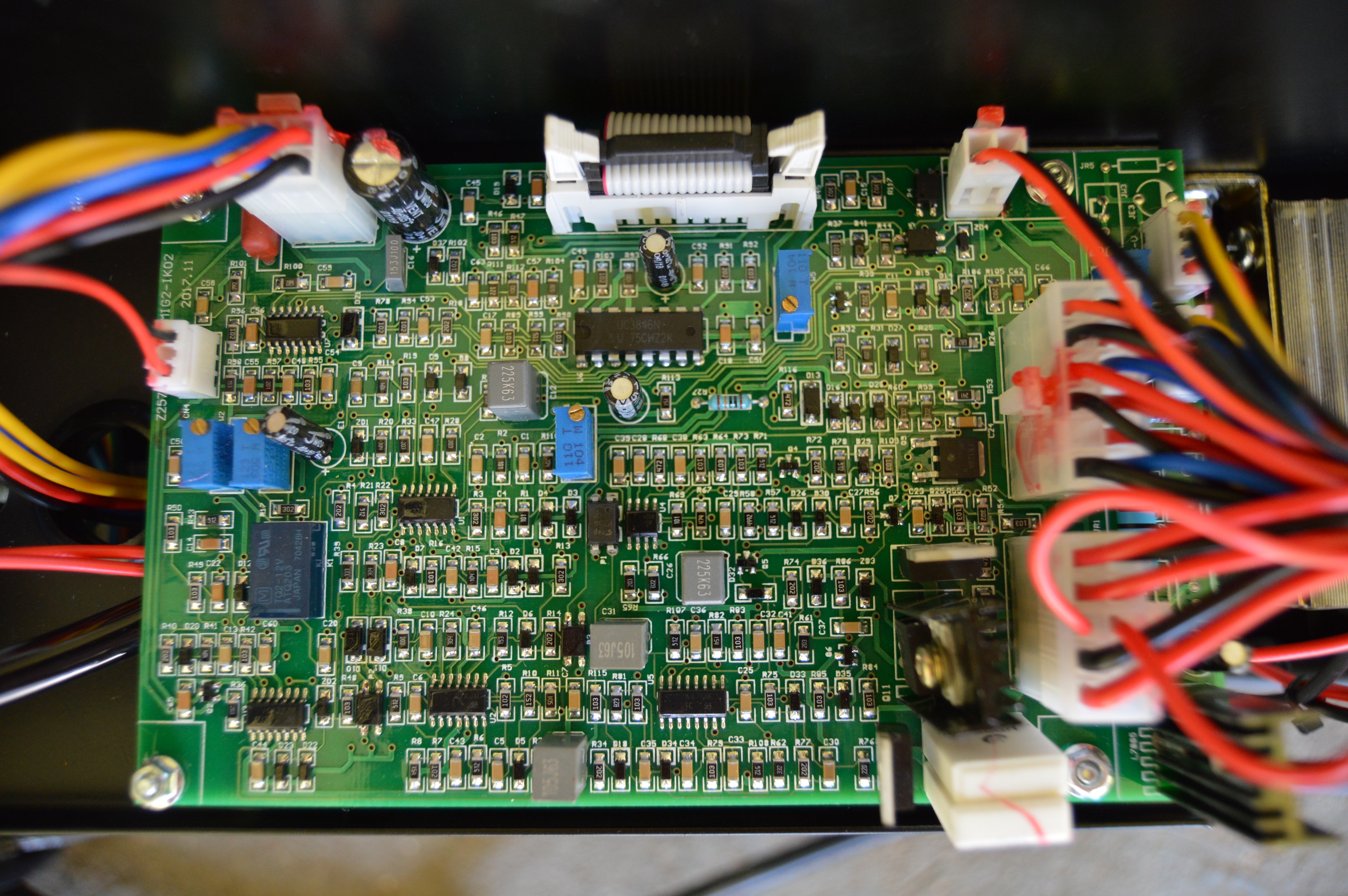

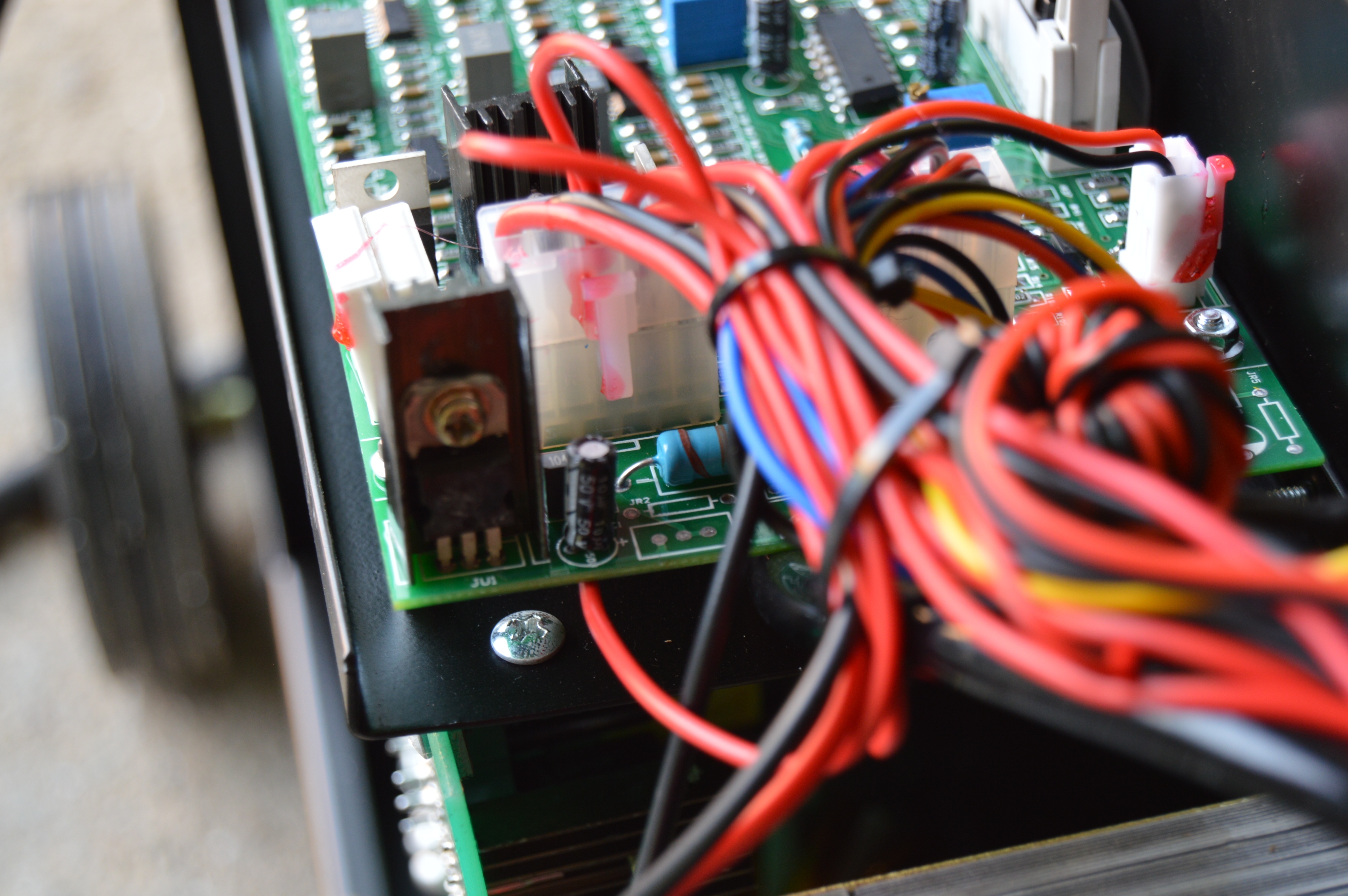

    Hello. I just bought a MAGNUM MIG-MMA 220W IGBT migomat and noticed that after welding (the button was released), gas was still coming out for a good second or two. This is a waste of spot welding! Is it possible to accelerate the closing of the gas supply valve in this blinker? I would be grateful for your advice.

    Insert photos of the board, I will tell you where to put the resistor.

  • #7 17360245
    metallhead
    Posts: 7

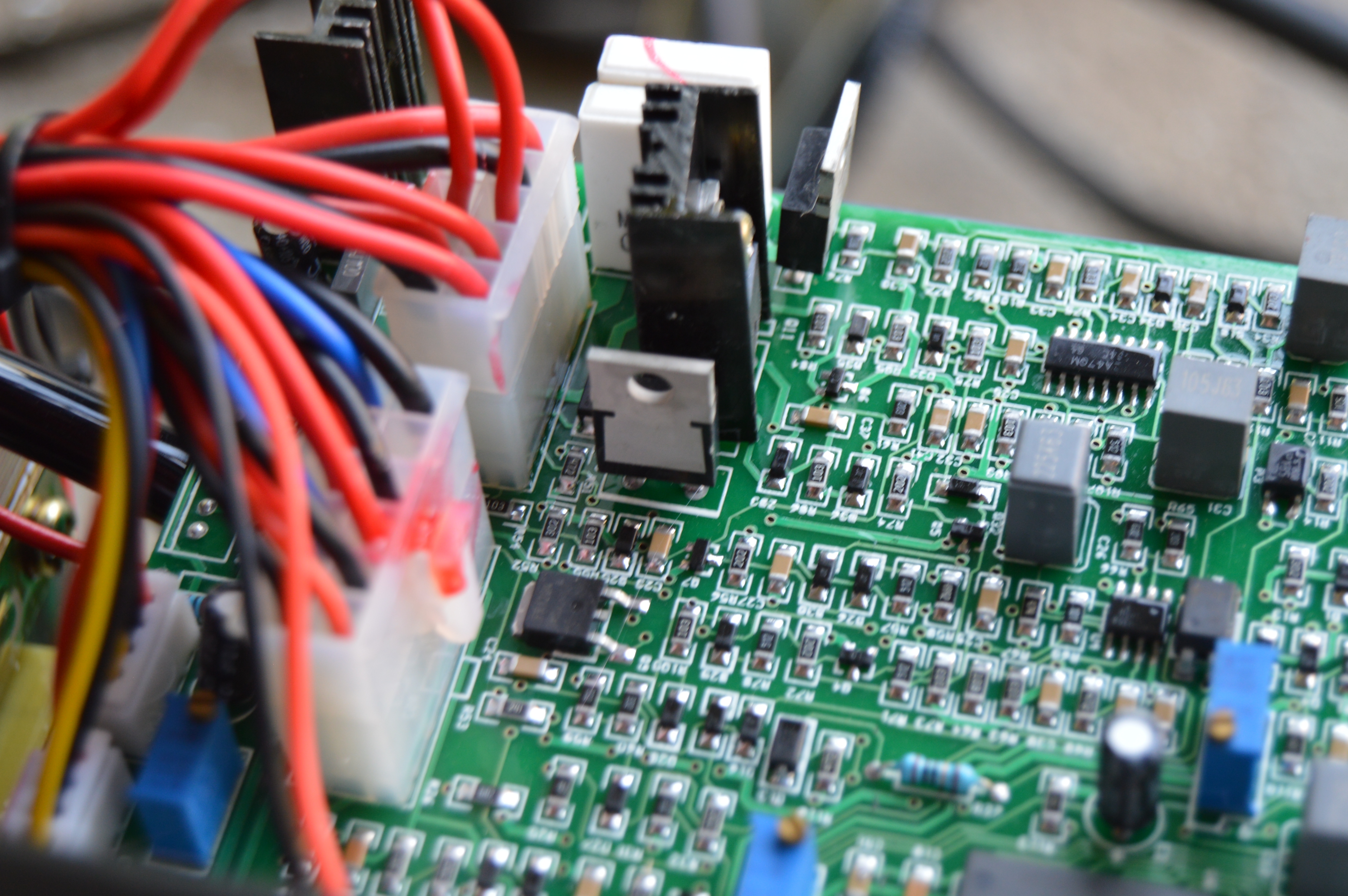

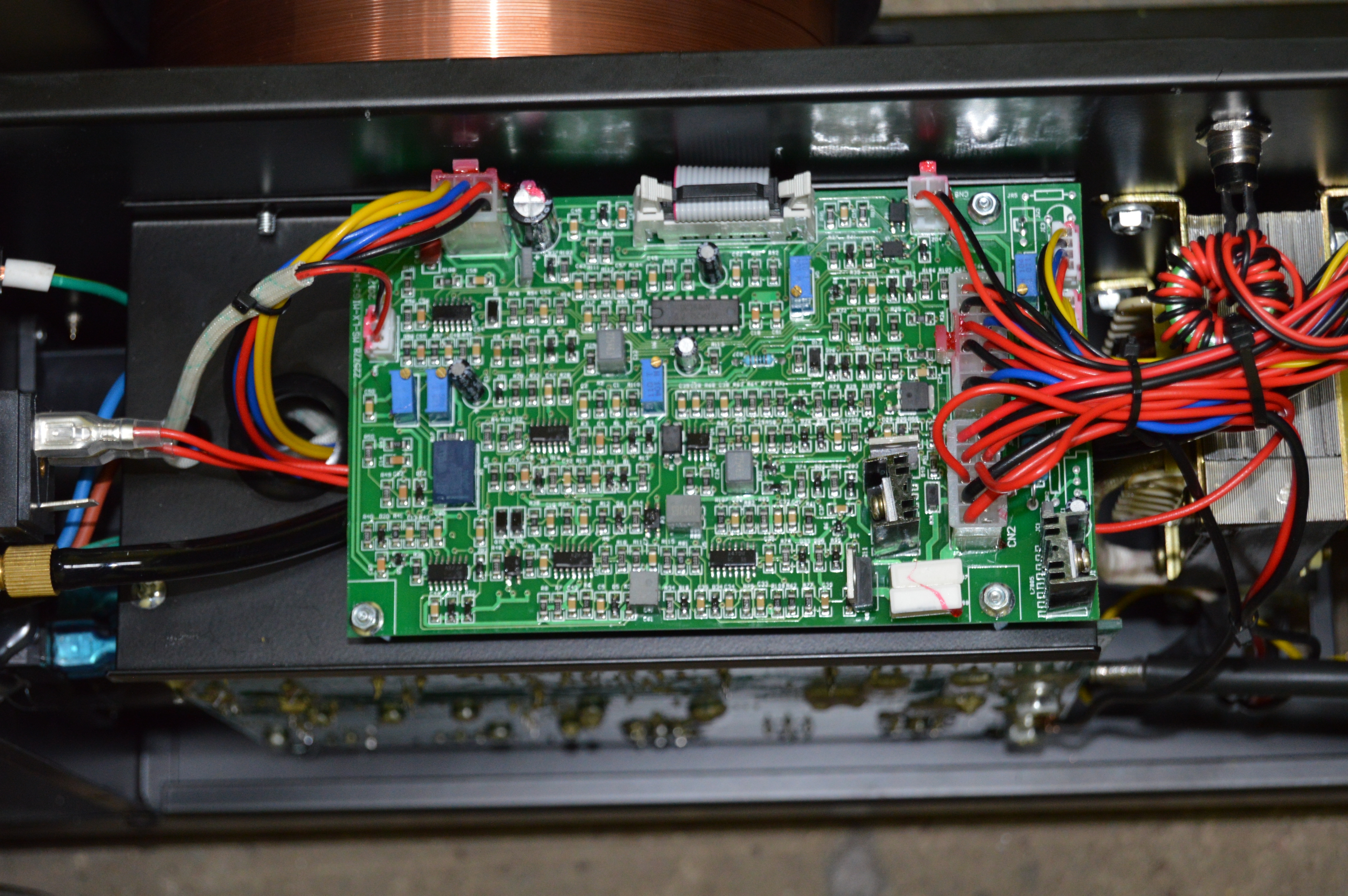

    @ stasiekb100 Is a photo on this side enough or on the other side too? I will post a better quality tomorrow. The two red wires are bent over from the solenoid valve.
    MAGNUM MIG-MMA 220W IGBT Gas Flow Delay After Welding
    Krzysztof Reszka wrote:
    metallhead wrote:
    I would not like to lose my guarantee
    Think carefully. Any interference is a loss of warranty.
    I know, I know, but maybe I'll have to make up my mind. Thanks for caring.
    Added after 12 [hours] 32 [minutes]:

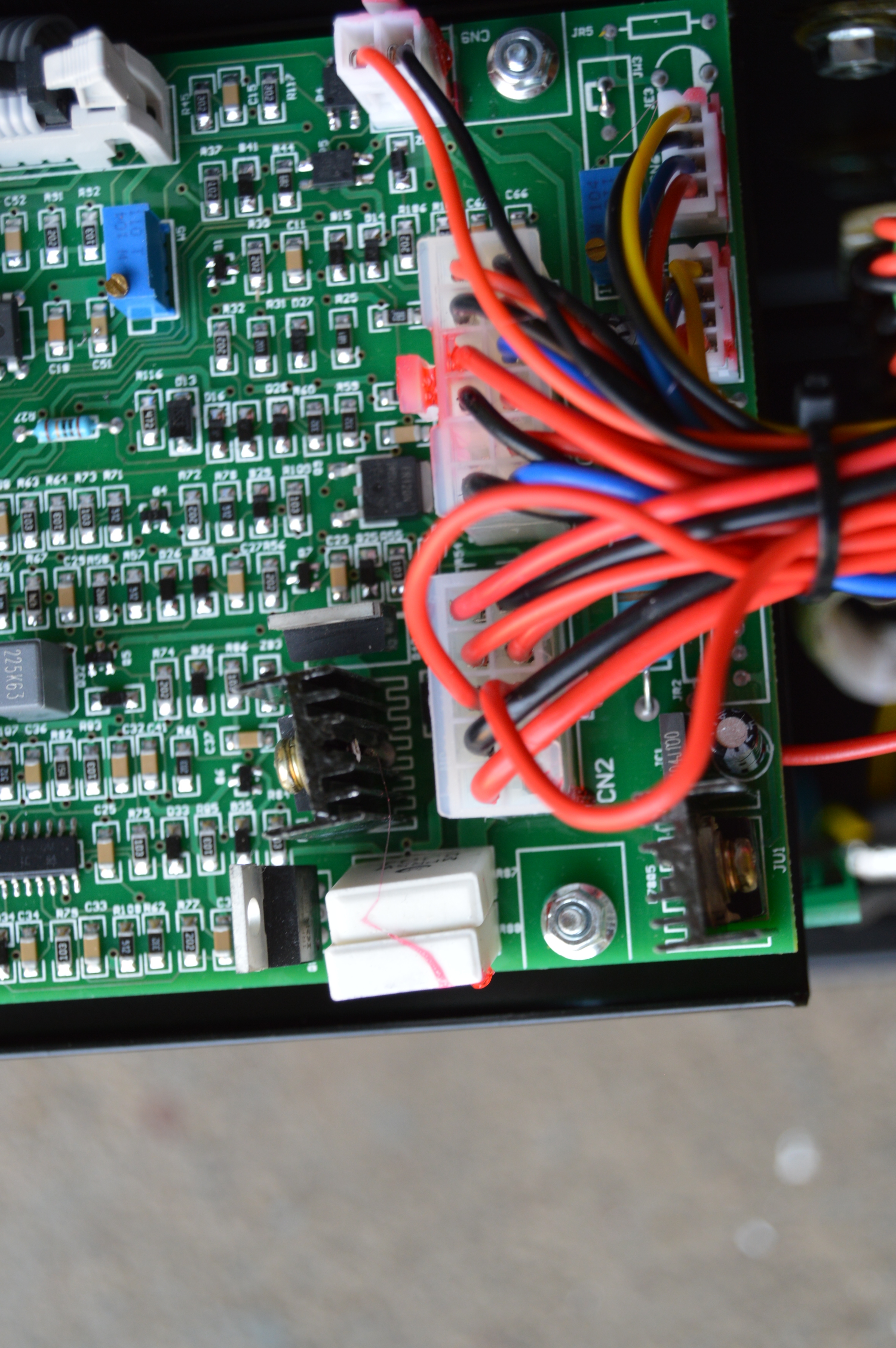

    @ stasiekb100 now I put pictures of better quality
    if other photos are needed, it is enough to say.

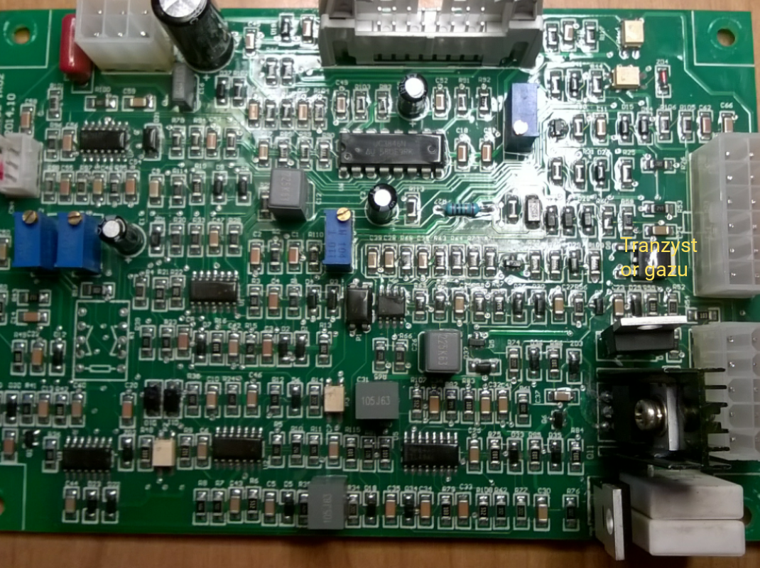

  • #8 17361515
    stasiekb100
    Posts: 2126
    Help: 118
    Rate: 459
    Good pictures, I know this board, but in it I changed the igbt switch-off current, the gas always worked properly.
  • #9 17362535
    metallhead
    Posts: 7

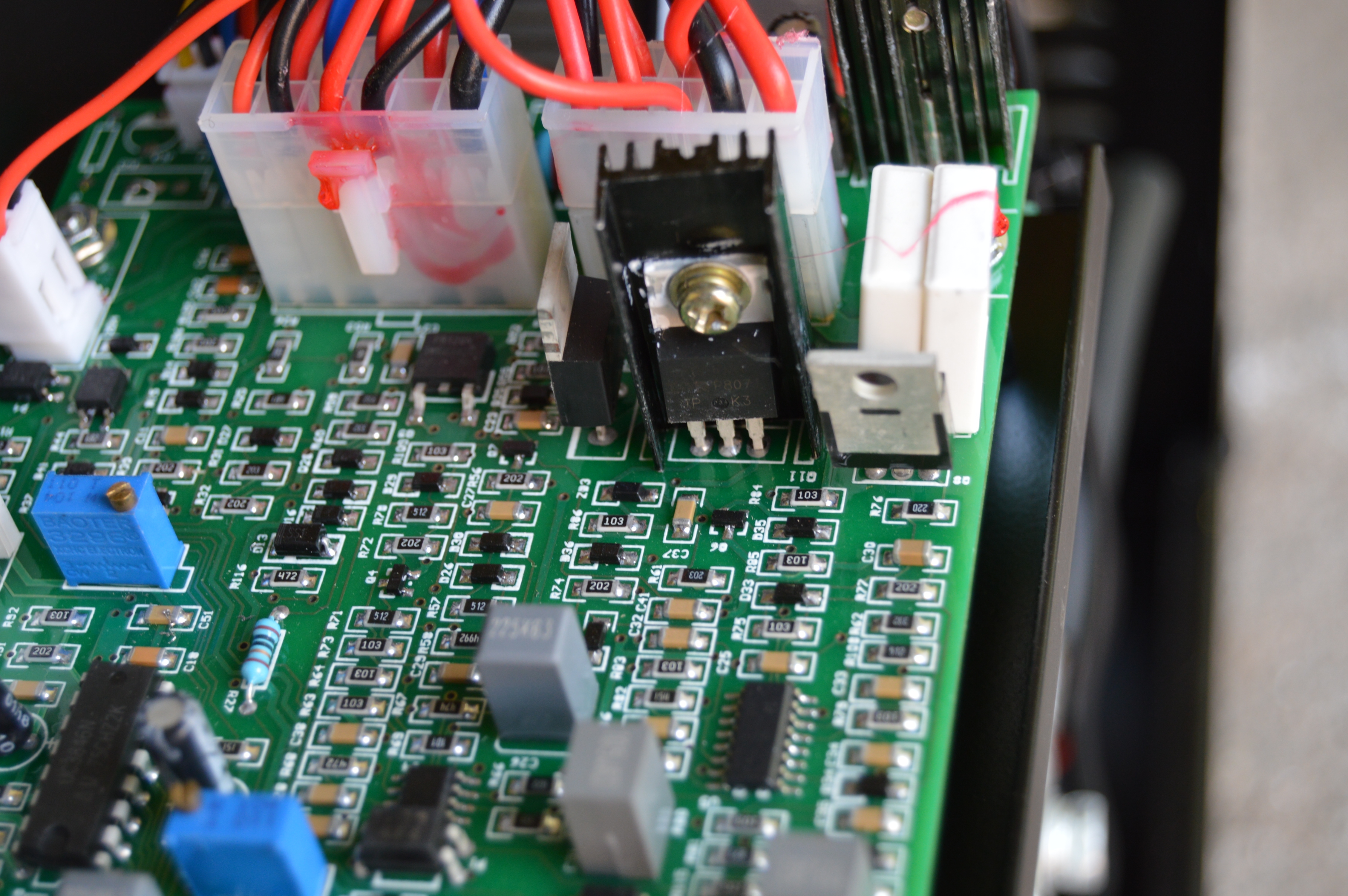

    @ stasiekb100 The gas can and works properly, but I am annoyed by the delay with which its supply closes after releasing the button in the handle. In my opinion it is way too big. With spot welding, it will practically come out all the time! And that is what I would like to avoid.
  • #10 17362629
    stasiekb100
    Posts: 2126
    Help: 118
    Rate: 459

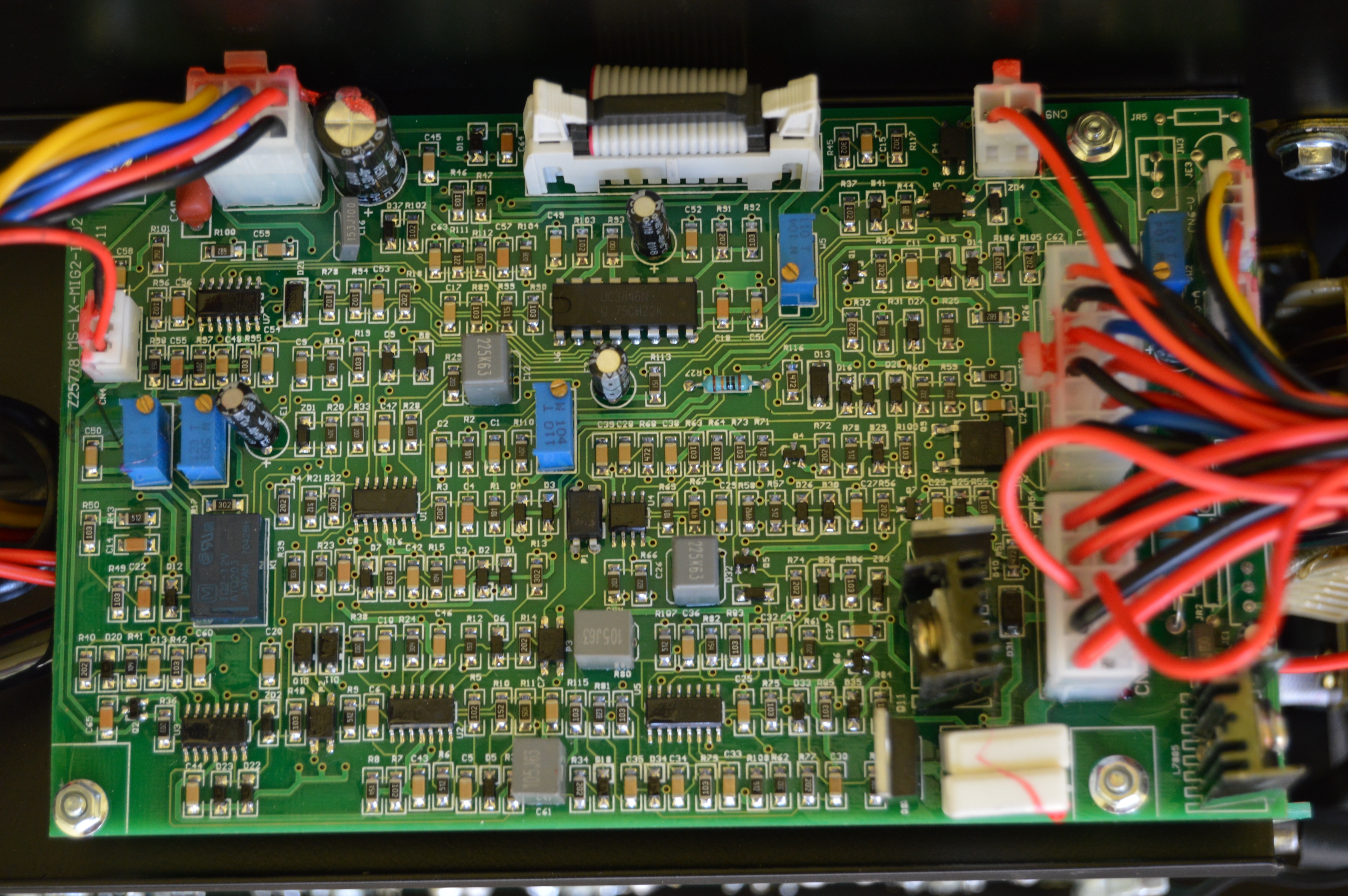

    A 1k resistor between the source and the gate can be installed on the gas mosfet. If this does not help, something needs to be changed with the 358 amplifier.
  • #11 17366508
    metallhead
    Posts: 7
    @ stasiekb100 and can you explain so more vividly in which place ??
    MAGNUM MIG-MMA 220W IGBT Gas Flow Delay After Welding MAGNUM MIG-MMA 220W IGBT Gas Flow Delay After Welding MAGNUM MIG-MMA 220W IGBT Gas Flow Delay After Welding MAGNUM MIG-MMA 220W IGBT Gas Flow Delay After Welding
  • #12 17366835
    stasiekb100
    Posts: 2126
    Help: 118
    Rate: 459
