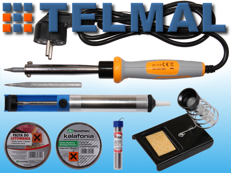

    Kraniec_Internetów wrote:
    I will ask out of curiosity: https://obrazki.elektroda.pl/9445448400_1406894720.jpeg
    This set can be "bought" on an electrode or on a well-known auction site for PLN 25.
    The soldering materials themselves cost PLN 30. This soldering iron is suitable for pleasant soldering?
    In total, a set for which you will not buy 2 packs of pipes ;) hard to feel ... so in detail, in a better store, rosin from PLN 2, tin from PLN 3, suction device from PLN 5 :) the rest is the price of the soldering iron :)
