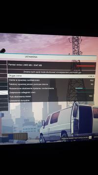

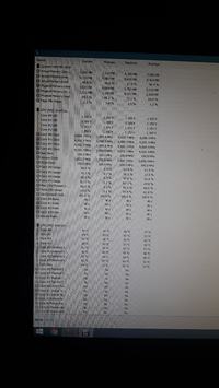

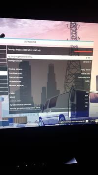

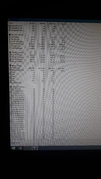

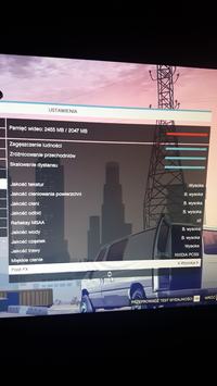

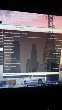

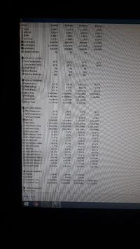

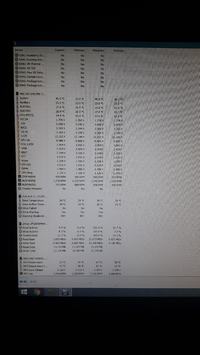

    The computer is not overclocked with me because I did not overclock it, I have only enabled in OC biosie OC so that the process is overclocked to 4.0GHZ and that's alone I did not overclock anything or nothing now I set GTA V on parameters are what are in the pictures and it comes in okey much better than then at 1600MB I have such a strange only stripes on the monitor they are also of lower quality when playing in GTA it is very annoying recorded video on which you can see how they fly these stripes and screen as if I move a little that I put on YT here you have a link: https://youtu.be/_CV4VOUsg08 I am sorry to have recorded it in your hand but otherwise I did not have it because I did not want to weaken my computer.
    I attach a lot of photos from the graphics settings in GTA V and from the program after playing 5 minutes on these settings.

    I see that you have a lot of graphical options enabled in the game that erase the video card's memory and are the graphics card.
    Come on all kinds of AA, turn tessellation off, turn off soft shadows or reduce their details because the graphics are not kneading and that's why you have such chops and, above all, reduce the resolution of textures.

    Insert screen from http://crystalmark.info/software/CrystalDiskInfo/index-e.html - from the entire smart table.
    Proceed does not make - that is exaggerated details, although on the graph, you exceed 2GB of the vram used, and the ram is also missing.
    edit
    on one of the photos I see 50Hz refresh - why not 60Hz?

    In this test you can see that there is no lag. The belts are "screen tearing" for yourself. Set horizontal sync to match the refresh rate of the monitor. What kind of monitor do you have? Native monitor resolution and native monitor refreshing check and set in the game.
    Later on, read what in the game settings requires CPU power as graphics. Lower everything so that you go smoothly.
    In HW you can see that the computer is a heavily loaded game but computationally. RAM is in stock (you have a minimum of 2GB free), CPU and GPU are not up to 100%, so it is theoretically good.
    Replacing the disk will not give RAM anything too. Learning how a PC works will help you the most. If you think that the knowledge about PC operation is unnecessary in your life, then sell this PC to buy game consoles and a cheap notebook for the rest.
