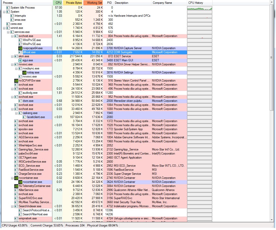

    Something is putting extra strain on the CPU during the game and therefore the FPS is dropping, the temperatures are OK.
    Start Process Explorer - before selecting: View -> Select Columns -> Process Perfomance -> CPU History.
    Start the game and post a screen from the program window when there are drops in the game.
    What is the complete configuration of this computer based on the make and model of the power supply?
    Attached you have charts - memory consumption, CPU, FPS and GPU usage.
    • Diag.rar (267.31 KB) You must be logged in to download this attachment.
    The question was or how exactly to do this scr?

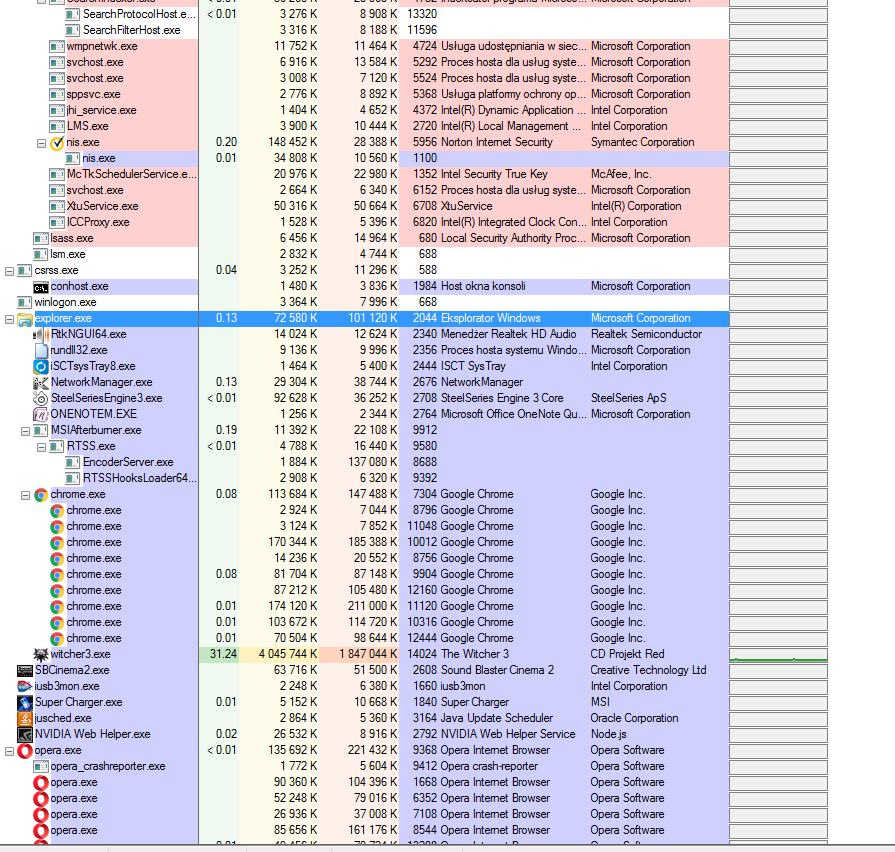

    • GPU Usage - When playing more demanding games, GPU Usage = 100% Bez tytułu.png (129.55 KB) You must be logged in to download this attachment.
  • #14 16568261
    Kasek21
    Posts: 45660
    Help: 4981
    Rate: 3547
    Yes, but so that you can see all the processes.
    Because the second option is too weak CPU!
  • #15 16568273

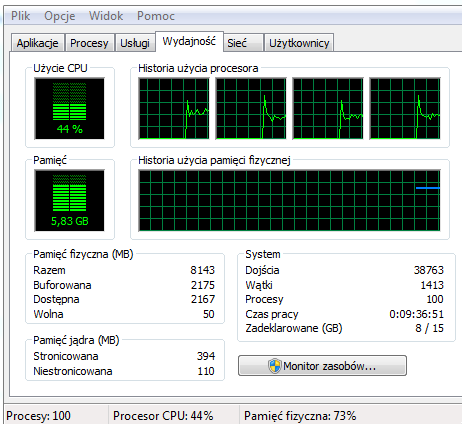

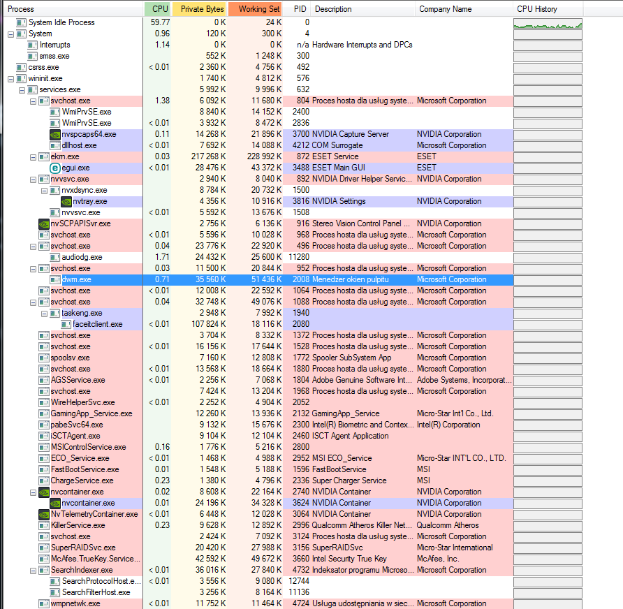

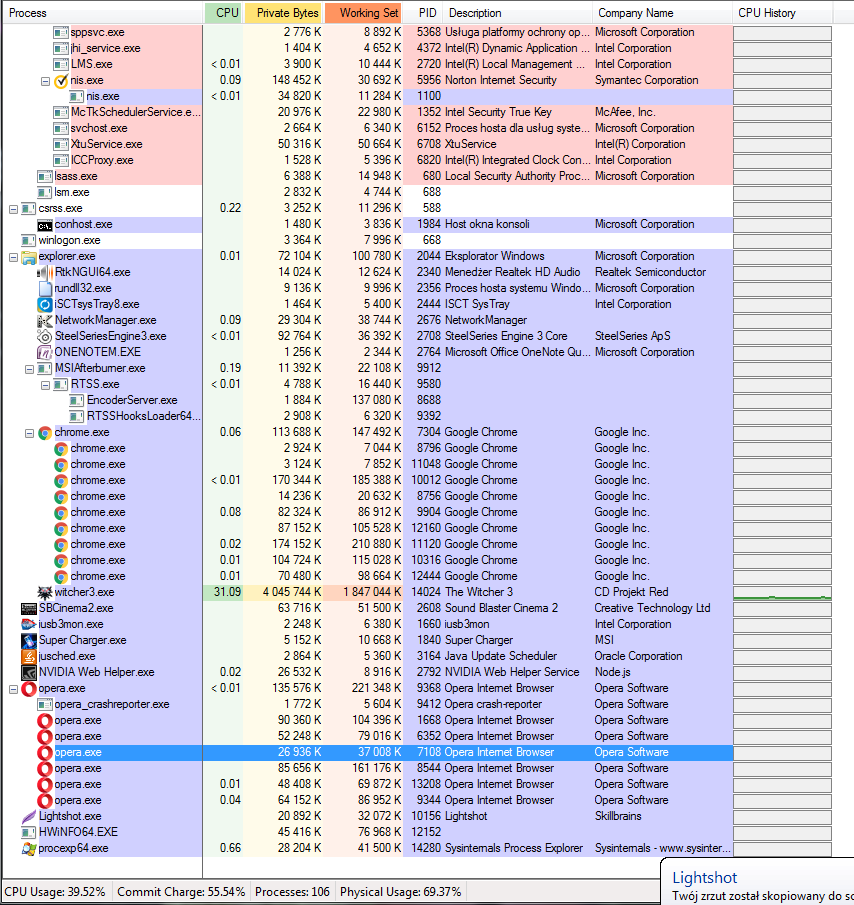

    1600MHz. Here you have all the scr
    • GPU Usage - When playing more demanding games, GPU Usage = 100% Screenshot_2.png (130.37 KB) You must be logged in to download this attachment.
    • GPU Usage - When playing more demanding games, GPU Usage = 100% Screenshot_3.png (141.21 KB) You must be logged in to download this attachment.
    • GPU Usage - When playing more demanding games, GPU Usage = 100% Screenshot_1.png (133.42 KB) You must be logged in to download this attachment.

    I understand these screenshots are after the FPS drops during the game, right?
  • #17 16568319
    Stakenxd1
    Posts: 28
    After the decline, I minimized the game, did screny nw if everything was well done and are they screny from the history after this spdku
  • #18 16568331
    Kasek21
    Posts: 45660
    Help: 4981
    Rate: 3547
    Well, there is no additional load on the CPU.
    The clock speed of the CPU and GPU is not dropping, the temperatures are normal.
    It seems that this is the CPU overhead that is caused by the game itself.

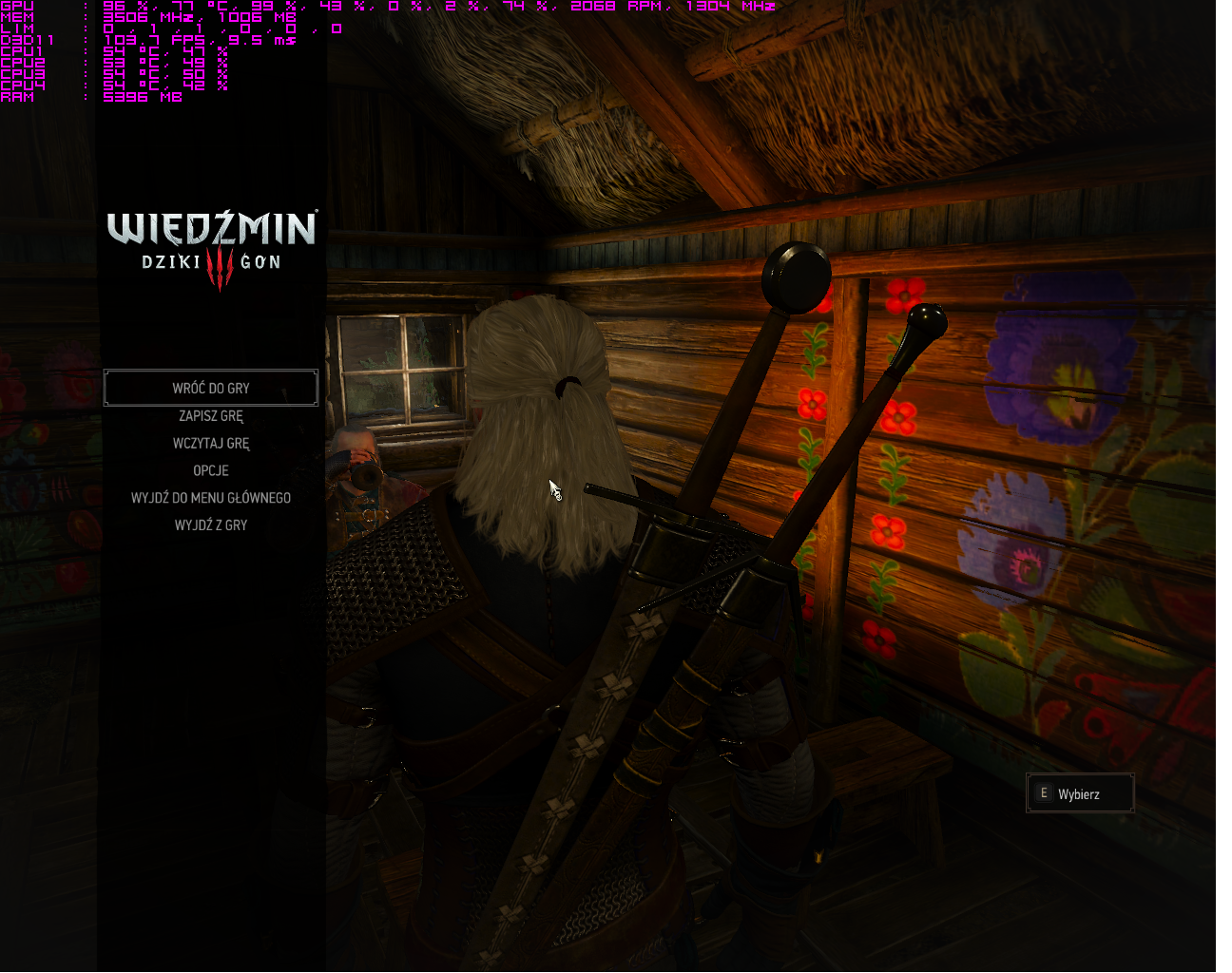

    Hmm, I did not add that I have already played The Witcher for six months - a year ago, there were no such problems
    Here it gives scr again right after the fps drop, the only thing that will change are these values.
    Additionally, after opening the task manager, the cpu usage shows up right at the start within 80 percent and after a second it drops to 30, which also surprises me at the bottom of the scr
    • GPU Usage - When playing more demanding games, GPU Usage = 100% Screenshot_6.png (20.64 KB) You must be logged in to download this attachment.
    • GPU Usage - When playing more demanding games, GPU Usage = 100% Screenshot_4.png (7.76 KB) You must be logged in to download this attachment.
    • GPU Usage - When playing more demanding games, GPU Usage = 100% Screenshot_5.png (2.99 KB) You must be logged in to download this attachment.

    From the hwinfo logo you can clearly see that the CPU does not work - and that you have 100+ fps and then it is no wonder to me because there are lighter and heavier places for the CPU.

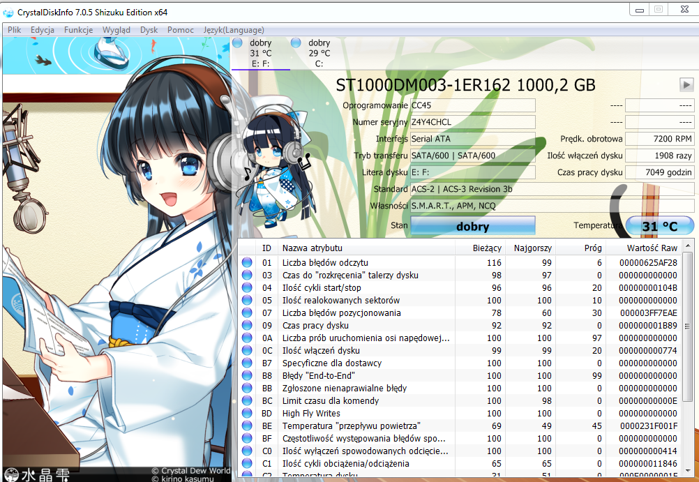

    You're right, I have 2 disks, you have scr here
    • GPU Usage - When playing more demanding games, GPU Usage = 100% Screenshot_1.png (715.14 KB) You must be logged in to download this attachment.
    • GPU Usage - When playing more demanding games, GPU Usage = 100% Screenshot_2.png (718.3 KB) You must be logged in to download this attachment.

    400! unexpected shutdowns on the plateau and did not respond to commands. Exclusions also on SSD, however, you did not include the lower part of the parameters. Anyway, to check the power supply in the first place, as I wrote (in terms of lags).
    Perhaps on 1 disk you can try to work, the other disconnect.
    I propose not the oldest drivers, but the newest ones, so that they work as well as possible.
    Try to turn off the largest processes yet.
    Use ADWcleaner additionally.
  • Suggest checking power supply and disk isolation

    Well, there must be something to it. Could you explain how to check this power carefully because I'm green at the same time.
    Processes turned off, computer beautifully cleaned.
