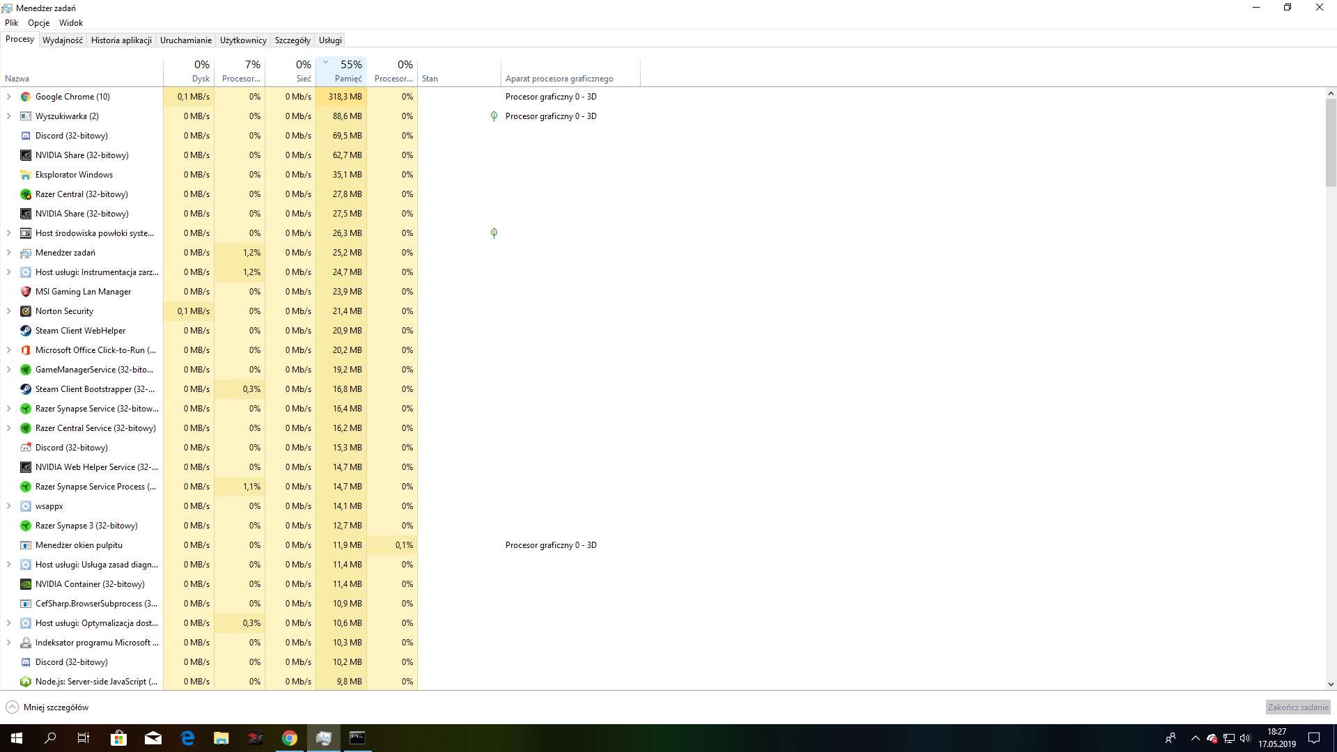

Why does my PC with an Intel Core i5-7400, GTX 1050 Ti and 8 GB of RAM stutter in games and show mouse lag when RAM usage gets high?
High RAM usage on this setup can be normal, but the stuttering and mouse lag are more likely caused by background load and the game’s settings/optimization than by the RAM percentage itself [#17966239][#17966756] Close unnecessary programs while playing, quit Norton if it is running, and scan the system for adware/malware with AdwCleaner and Malwarebytes [#17967127] If the lag improves after that, the issue was probably system overhead rather than a hardware fault [#17967262] For the mouse lag specifically, the replies point to the game being poorly optimized or the CPU/GPU being overloaded by high graphics settings [#17967299][#17967308] In this case, lowering the graphics settings solved the problem, which also suggests the game’s optimization was the main cause [#17967314]

    Rather normal, memory is there to be used. The system creates buffers in it to have quick access to frequently used resources.
  • #3 17966756
    Elimmo
    Posts: 26
    8 gb of ram on w10 is not so much that its consumption is low.
    In addition, on the screen you have 10 chrome tabs launched.

The discussion revolves around high RAM usage issues experienced by a user with an Intel Core i5 7400 processor, GeForce GTX 1050Ti graphics card, and 8GB of RAM. The user reports that RAM usage reaches 85% during gaming, leading to system jams and mouse lag. Responses highlight that 8GB of RAM is relatively low for Windows 10, especially with multiple applications running, such as Chrome. Suggestions include optimizing the system by closing unnecessary programs, using malware removal tools, and adjusting game settings. The user notes that reducing graphics settings improves performance, indicating potential optimization issues with the game "Hurtworld," which is no longer supported by developers.
