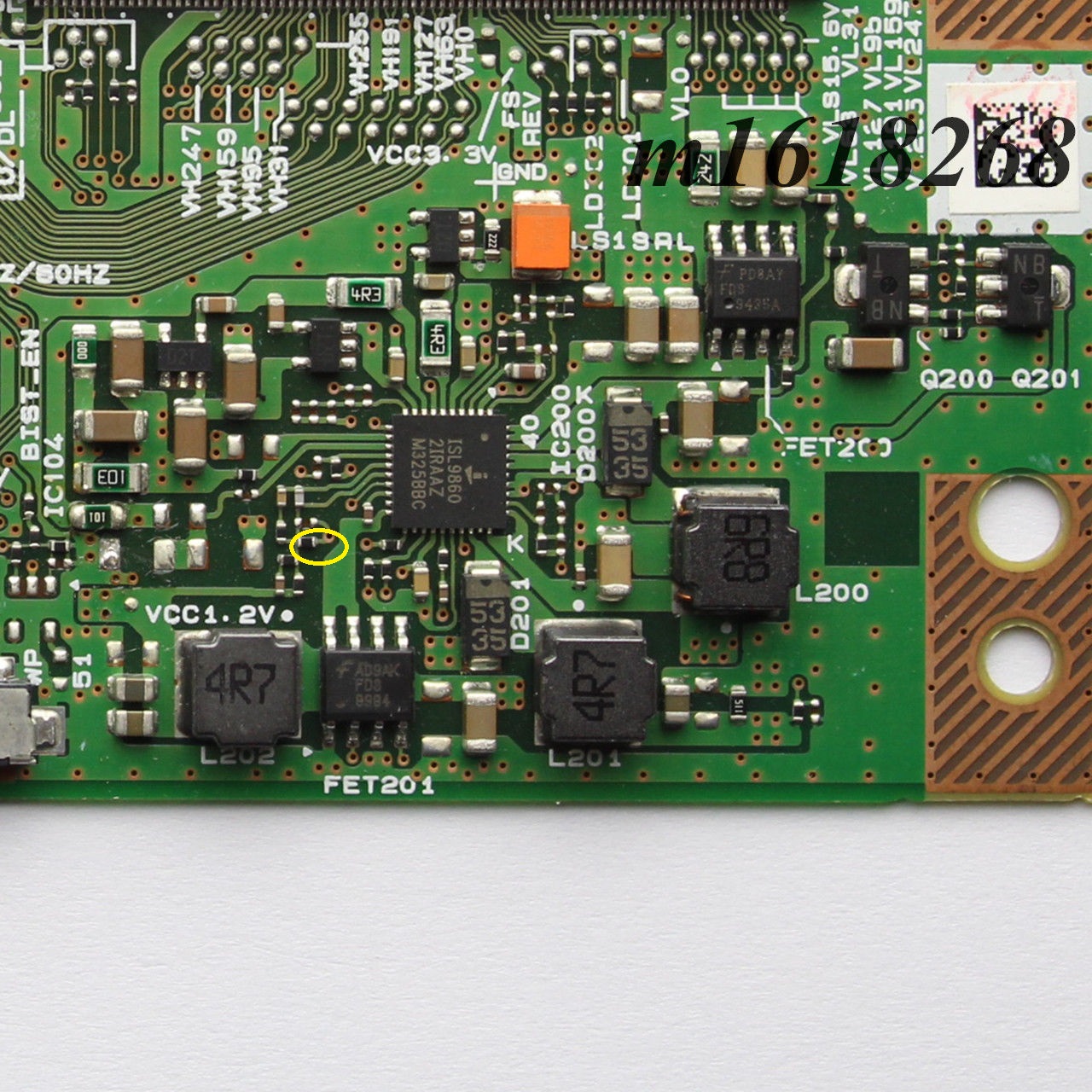

    Somehow I'm not willing to buy new modules I would prefer to repair the old one.
    T-con RUNTK 5351TP 0055FV on Samsung UE32F5000 no image
    After replacing the ISL9860, there is still no voltage.
    On Allegro there is a service that repairs such t-con for PLN 80
    Is it possible that the new ISL is damaged? Order somewhere else?

    Maybe not so much as to check only the link with ISL which will fit the T-Con :) Because I read that these ISLs are for different voltages and you need to choose a resistor from leg 16 to ground otherwise it will not start.

    You need to replace this resistor for something between 330k and 560k - so that the voltage on l202 is 1.25

    Hello. Does anyone know what the resistor originally mounted there is? (The one marked in the picture above)

    Hello, the resistor originally has 20kOhm, after installing 470kOhm with 2.6V the voltage drops to the correct 1.2V.

    That's right T-con after replacing ISL is still dark on the LCD and after replacing the resistor for 330K started. Regards M.

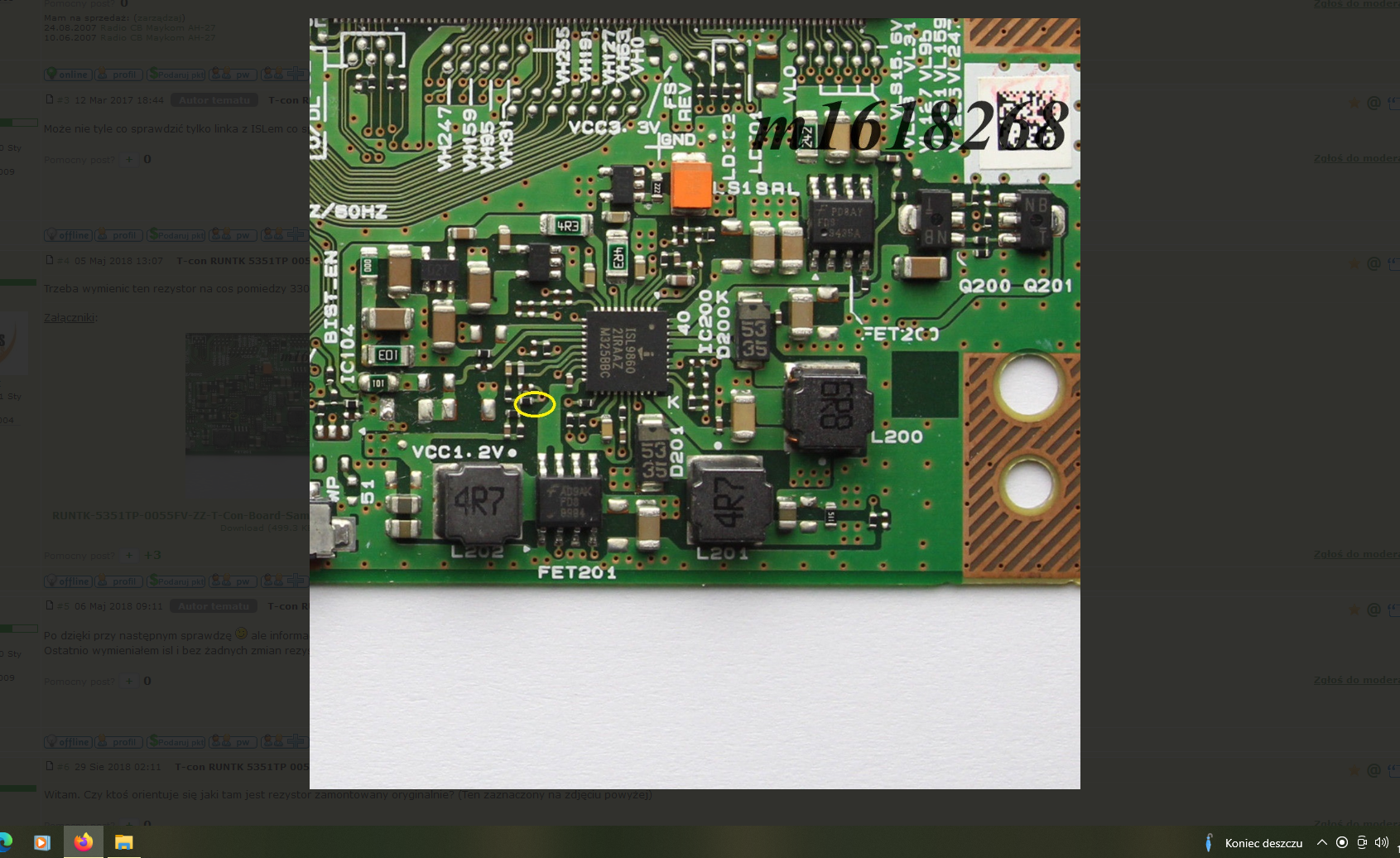

    Can't we just remove that resistor as mention in one of the youtube or other discussion forum?

    disconnect that resistor marked in the circle
