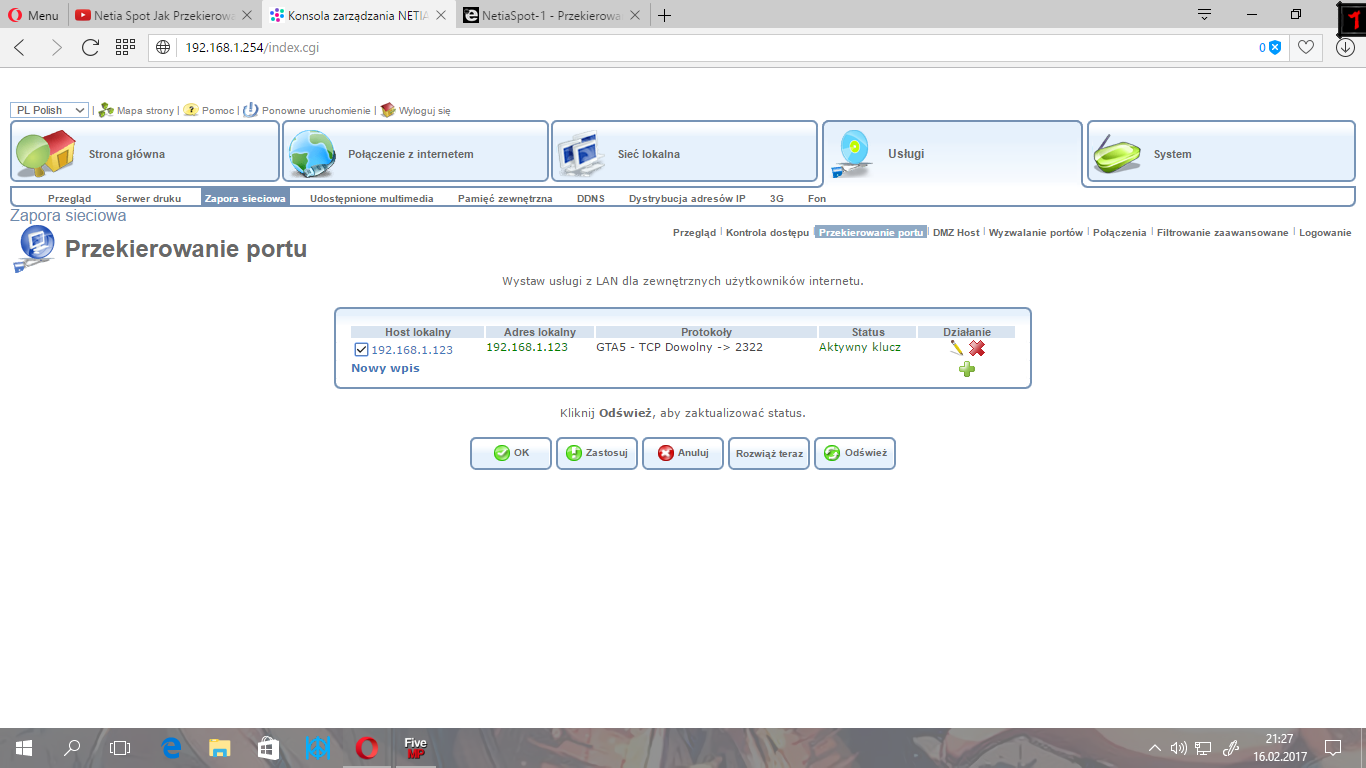

    Show screenshots of how you forwarded ports in netiaspot.
    Show wan netiaspot address.

  • #8 16284466
    bogiebog
    Posts: 24793
    Help: 2569
    Rate: 1528
    Direction looks OK,
    Turn off the windows firewall for a test, does it work? no ?

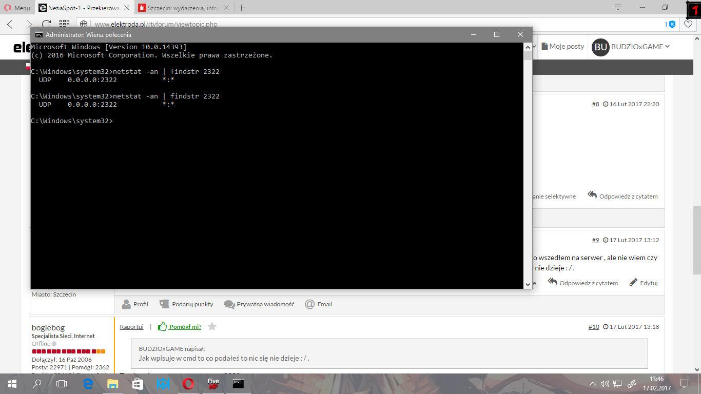

  • #9 16285498
    BUDZIOxGAME
    Posts: 83
    Well, when I entered my ip with ip config (ipv4) in the game, which is 192.168.1.123 and I entered the port that I wanted to open, i.e. 2322, I entered the server, but I do not know if someone else will be able to enter and what ip address should be given then because rather not this one 192.168.1.123. If you type what you entered in cmd, nothing happens: /.
  • #10 16285508
    bogiebog
    Posts: 24793
    Help: 2569
    Rate: 1528
    That is, _no_ doesn't have a server on port 2322.

    In fact, my mistake, when I started the server now, something was displayed NetiaSpot-1: Guide for Successful Port Forwarding - Unblock Ports for Public Game Server Setup

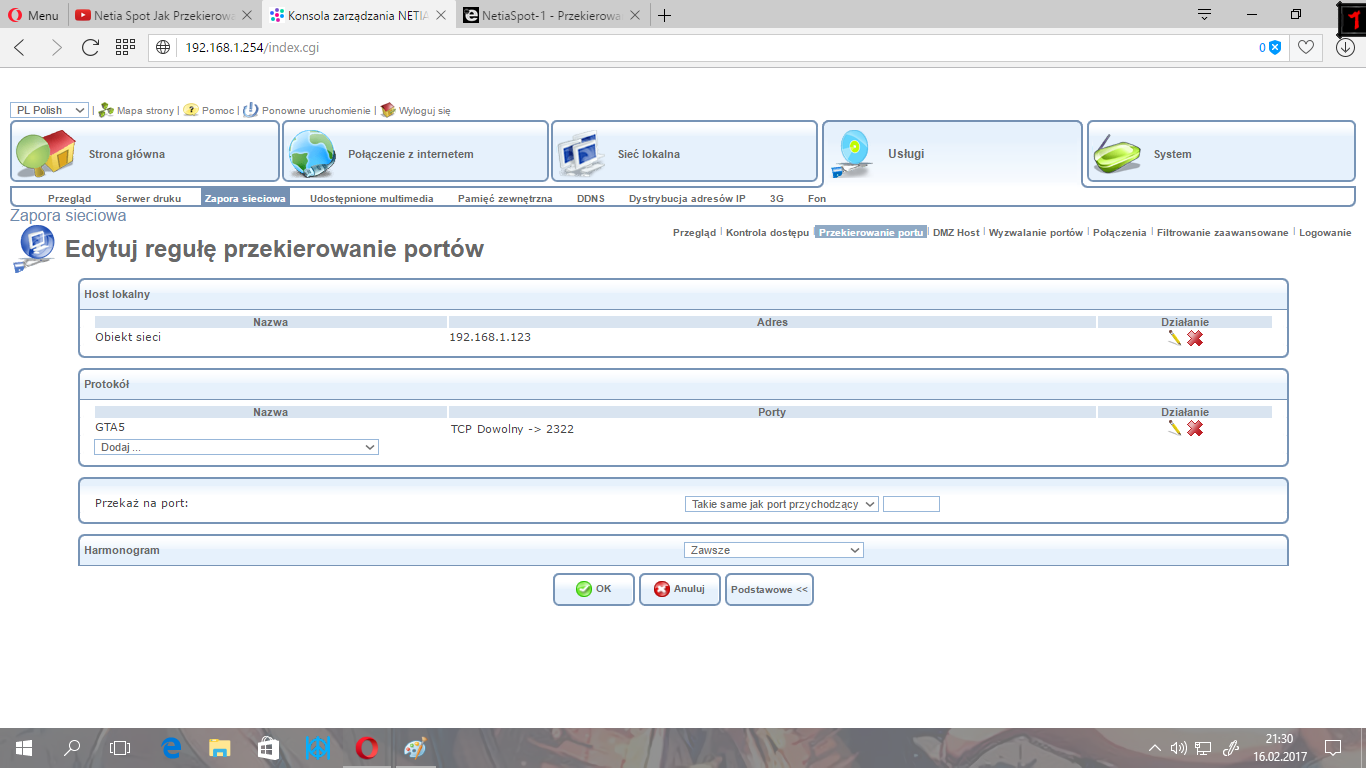

  • #12 16285844
    bogiebog
    Posts: 24793
    Help: 2569
    Rate: 1528
    You have redirected the TCP port and the server is using the UDP port.
  • #13 16285886
    BUDZIOxGAME
    Posts: 83
    I just redirected to the UDP port in cmd there is no difference.
  • #14 16285893
    bogiebog
    Posts: 24793
    Help: 2569
    Rate: 1528
    Show redirect on router.
    Run
    nestat -abn
    Paste results into the "spoiler" section
