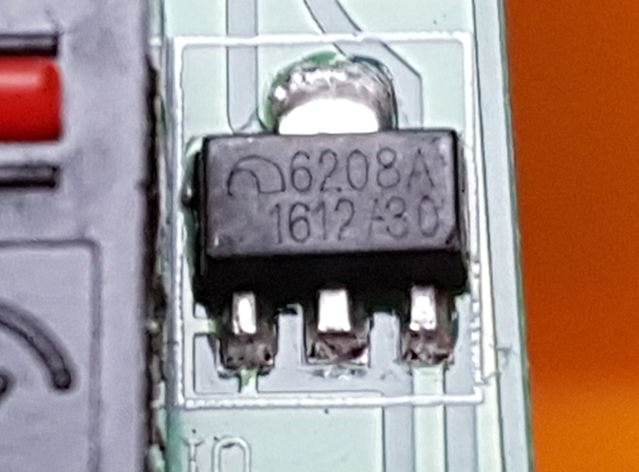

What is the 6208A chip in the photo, and what replacement can I use for it?

    I am looking for such a 6208A chip
    It looks like this:
    Identifying and Finding a Replacement for 6208A Chip: Suggestions Needed
    Help me find such a chip or its replacement.

    For example, in China (unavailable in Poland), but here we don't talk about shopping. A better option is to choose a substitute available in the country. Look for a 3V "low dropout" LDO stabilizer with a current efficiency of minimum 200mA in the SOT-89 housing with the same pin layout.

    I suggest you look at the XC6206 and ME6208 datasheet, this is the same system, but different manufacturers. The note specifies the method of marking. The layout in the photo is a 3.0 V stabilizer. There is no point in looking for a layout in the Chinese. It is enough for a colleague to look for a 3.0 V linear stabilizer in the SOT-89 housing, eg RH5RL30AA. You only need to check the pinout in the note.

    Nevertheless, the systems can be used interchangeably. And this is probably the most important warthog for a friend. By the way, the marking of the XC6208 is inconsistent with the CE mark, as the manufacturer informs about in the note.

    Subject solved
    I replaced it with the LD1117 3.3v stabilizer
    I couldn't get 3v right away, took a risk and plugged in 3.3v - everything works fine.
    Of course, the pins had to be swapped, but I bought the circuit in the TO92 housing anyway, so I soldered the wires and there was no problem with changing the ground input and output.
