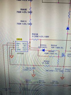

    Does anyone have the above mentioned systems to sell? I have a power supply to repair, and I can see that they are only on aliexpress.

    PF6003ahs Pf6003 Pf6003as = LD5532-gs = PF6005As
    * case SOP-8
    Jak sie ma do tego PF6003AD?
    To z forum Link
    (PSU): 715G6550-P03-000-002H / -002M
    PWM Power: PF6003
    * LED driver PF7708AS
    z Philips 40PFT4100/60 chassis TPN15.1E LA
    PSU 715G7734. Tv Led Philips (TPN16.2E LA)
    ICs:
    U9101: PF6005AS
    U9301: (No Conectado) AOZ3015AI
    U8601: PF7708BS
    replaced the pf6005ag with the ncp1251. xq
    The original carries 8 pines and the other 6. I saw q on the circuit. pin 7 has no connection. and as I know what the pin 1 of ncp1251 is.
    Firma mówi ,ze to nieprawdai podaje
    PF6005-AS is equal = IC LD5532-GS

    OB5269 = LD5532 GS , case SOP-8 Link_ datasheet

    I replaced OB2263 and it does not fit (although the power supply runs on it for 10-15 seconds, the voltage is correct, but the transistor gets DS short-circuits, and strange because it is even cold and without a heat sink) Primary damage - a hole in 220pf / 1KV.
    Now I have ordered an OB2273 and I will see what happens.
    I do not want to change anything and redo anything.

    Look at the datasheet OB2273 OB2273MP Power Controller SOT23-6, 65Khz
    - there is also the DIP-8 housing
    [I will buy] PF6003AD chip (sot-326 housing, philips power supply)
    ps
    Maybe a combination with LD7535?
    OB2263
    - role of pin.5 and required size voltage (datasheet)
    The rework is a combination with a resistor on pin 3 ((R7 = 240k-75k)
    - due to different Vdd (sometimes + 18V must be given), UVLO
    Link
    LD5532GS

    I have PF6003AHS in SOP8. This OB2263 is different from OB2273.

    Actually, this is different. OB2273 came today, I put it in and the power supply works fine.
    So I can say with full responsibility that it is a 1: 1 replacement for the PF6003AD, and most importantly, that it is easily available.
    I don't need PF6003AD anymore. Best regards.
