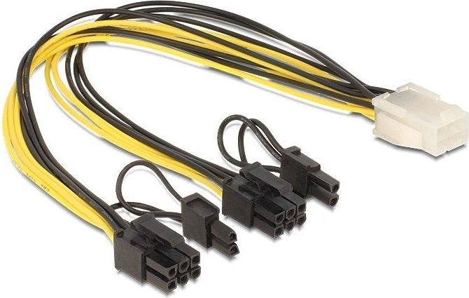

    The XFX Core PRO 450W power supply (P1-450S-X2B9) has a 1x6 pin power supply, while the graphics card needs 2x6pin power supply.
    My question is what better adapter to use:
    1.1 molex for 6pin
    Sapphire Radeon HD 7870 XT Power Supply: 2x6 Pin Adapter for MSI B250M PRO-VH & XFX Core PRO 450W
    2.1x6pin to 2x6 pin
    The rating plate of the power supply looks like this:
    The manufacturer added two 1 molex to 6 pin adapters to the card.

    Thanks for the answers. So @ dt1 you say it's better to give a 2molex - 6pin adapter for this?
  • #6 17157826
    dt1
    Admin of Computers group
    Posts: 48250
    Help: 7315
    Rate: 8292
    Yes, I would use it with a power supply with enough molexes.

    And what would the hypothetical load capacity look like if I used such an adapter: 1x6pin to 2x6pin:
  • #10 17158031
    dt1
    Posts: 48250
    Help: 7315
    Rate: 8292
    The theoretical load capacity of PEG 6pin is 75W, PEG 8pin is 150W, in practice certainly much more (since Molex can handle over 130W on one wire, and in PEG we have three 12V wires). Especially on a decent power supply with cables, but in which there is more metal than insulation, there should be no problems.

    The graphics card Sapphire Radeon HD 7870 XT With Boost (11199-20-20G) needs 185W, so it's better not to risk with a 1x6pin to 2x6pin adapter:
  • #12 17158056
    dt1
    Posts: 48250
    Help: 7315
    Rate: 8292
    For my it will do, but considering that the power supply has a lot of molexes, and a 2x molex-> peg grommet for pennies can be bought or sometimes even free. On the other hand, the plug from the power supply plus a grommet from a single molex, if you already have one, it is also enough.
