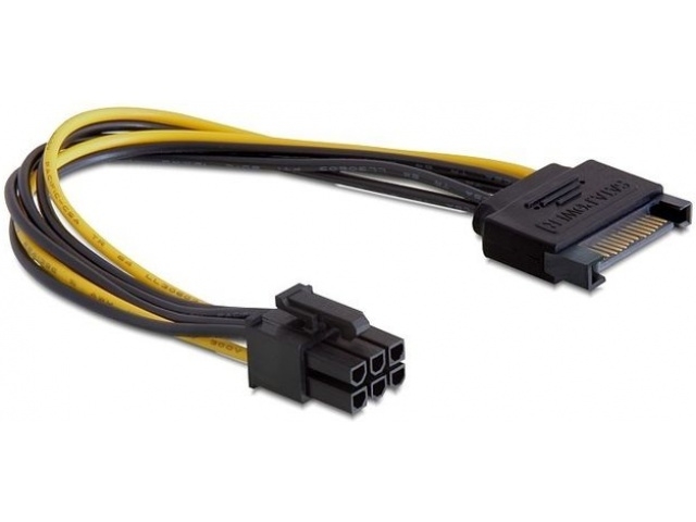

    Hello, I need a specific answer.
    I bought a new card that needs 6PIN power
    or how do I buy a 6-pin sata adapter and plug in, everything will be ok? (they assure you that yes).
    Added after 35 [seconds]:
    Adapter for graphics card power supply: SATA -> 6 pin PCI-E
    This is something, only I took the more expensive RTV EURO AGD for certainty.
    Moderated By dt1:
    The link to the auction has been replaced with a picture of the item. Please do not post expiring links (the exception is "what to buy?" Section).

    Loaderer wrote:
    One idiot told me that voltages may not be what it should be and that he will make me his cable for 110 zlotys (I don't know if to suggest it), it's probably a trickster. Others said that my Chieftec 650W easily has such a reserve of power that the card will wipe and it will be left 3 times, I think they are right.
    The guy wasn't an idiot, and you probably didn't listen to what he was saying.
    The efficiency of the SATA power plug is 1.5A per contact, the 12V voltage is divided into 3 contacts, the theoretical 12V performance is 4.5A, or 54W. If you connect a card on such a grommet that wants to eat 150W from this socket, it may turn out that the guest was not an idiot.
    Since no one knows what you want to power it with, it's hard to say if it will work well. A new graphics card is something that can charge 50W, and can download 250W.

    I will say yes, my card is efficient on this connector and the temperature does not jump above 55 degrees no matter what load, is there anything to worry about? The card has been working stable for several hours.
    Another thing the guy in the computer told me that he supplies such an even better card and is peacefully enough for him, because the bandwidth of this adapter is 12V, besides I didn't take any shit because I took the one with better cables, thicker.
    Its safe? (Temperatures are very stable, no jumps)
    PS. Somehow you can check in the system how much voltage comes to this card?

    After all, this power supply has a PEG 6pin connector (even two) so why do you need an adapter?

    1050Ti does not consume any large amounts of power, up to 75W in total, some of which probably by PCI Express. It should work on such a pass rather without major problems.
