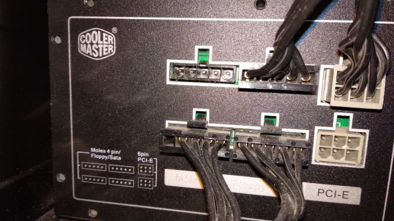

    enhanced wrote:
    Surely you do not have an 8pin one, how do you have a 2x6pin pcie?
    There are transitions to the Allegro for sure. I do not know if it is worth worrying about how the card works because each adapter is a waste.
    Well, unfortunately I do not even have 1 eight (if it would be useful, I attach a photo of the ports in my power supply) GTX 1070ti Power Supply Query: 600W Cooler Master with 2x6 PCIE-E Pins vs Required 8 Pins )
    And if the card will not work weaker on 6 pins, it is less current. Each pin probably has its own limitations as to the transmission of current.
    I have one more idea because there are 6 + 2 plugs. So separate pins connected to the card work. If you were to connect these two 6 to the card and just 4 pins would be free (not connected, they would stick out to the side). Will it work and is it even possible?
  • #4 17622712
    enhanced
    Posts: 10442
    Help: 963
    Rate: 883
    On the other hand, you don't have 6 + 2 pins of one wire?
    Rather, the entire nest is connected rather than broken into lines. There would have to be a mega mic for 6pin boots not to work. Of course, the more wires the better, but usually these additional two pins are pulled right at the end of this 6-pin graphic cable, so that's a piece of art.
    I do not know if you will be able to hook it up because the sockets are profiled, which would not plug in separately.
    edit
    What is this Coolermaster model? Because it matters whether it has one 12V line or more.

  • #6 17622783
    enhanced
    Posts: 10442
    Help: 963
    Rate: 883
    PCI-E 6 + 2 Pin x2
    Well, are the connectors to the side are 8-pin or not? :)

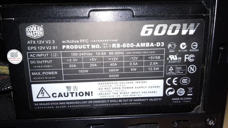

  • #7 17622829
    BanditPlayGame
    Posts: 17
    enhanced wrote:
    PCI-E 6 + 2 Pin x2
    I myself do not understand. There in the photo in the lower left corner there is 6 PCI-E pin written, and in the specification that 6 + 2. I will also give a picture of the side of my power supply, where the model is saved. Because maybe it is another power supply.
    But so far it comes out that if I buy a cable that has an input (to the power supply) 6 pin PCI-E and an output (to the graphics card) 6 + 2 pin PCI-E and then I plug it all in, it should work like this?

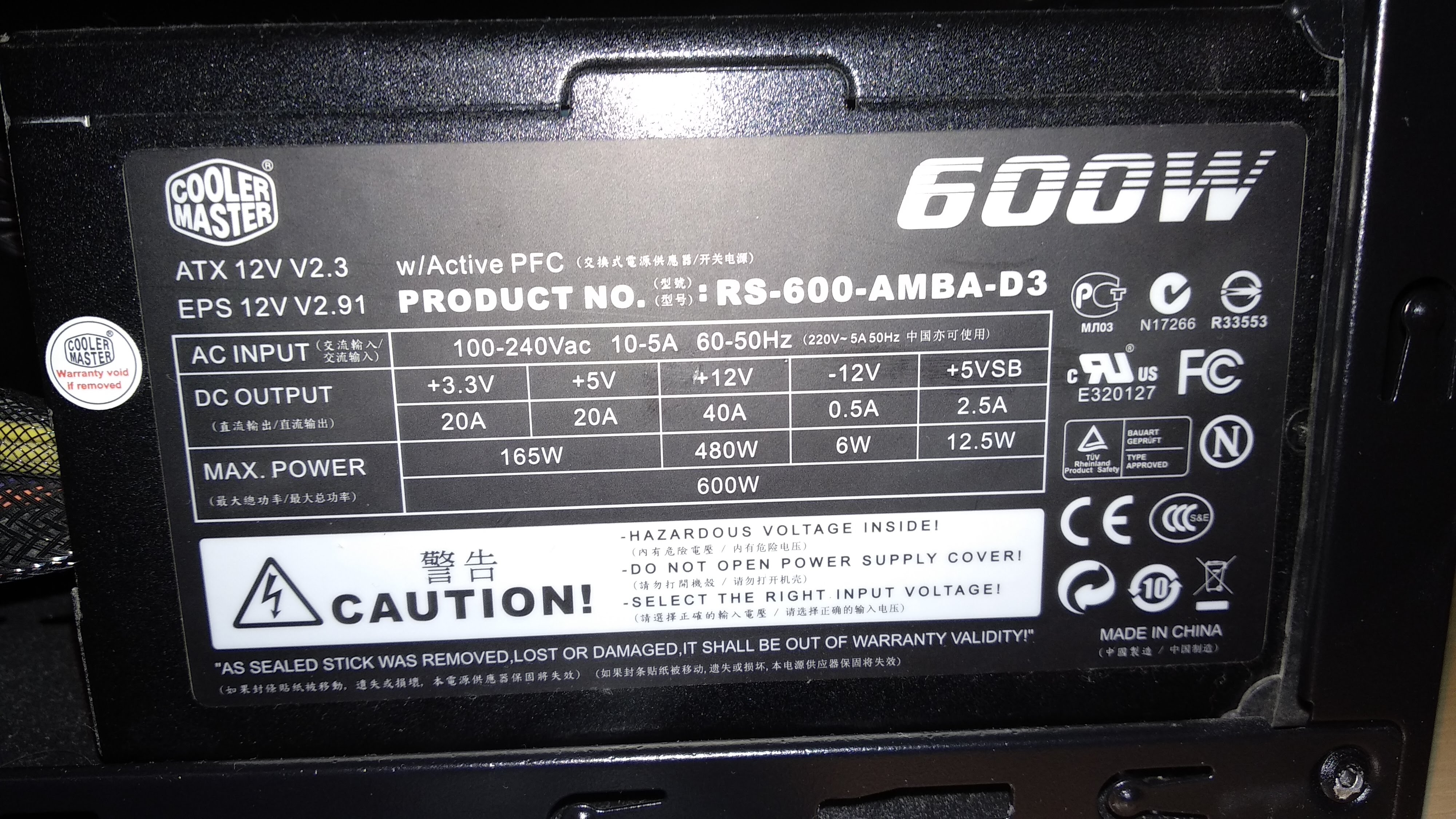

  • #8 17622841
    enhanced
    Posts: 10442
    Help: 963
    Rate: 883
    Take this cable in hand with pcie and on the other side it should have 6 + 2 pins, not 6 pins. You have this power supply, probably you can do it?
    I wrote that these 6 + 2 pins are such art for art because 6 pins are going anyway and then additional 2 pins are split from these 6 pins at the end of the cable.
  • #9 17622941
    BanditPlayGame
    Posts: 17
    I wrote that these 6 + 2 pins are such art for art, because 6 pins are going anyway and then additional 2 pins are split from these 6 pins at the end of the cable.
    You're right. In fact, there are these two extra pins on the other end, thank you so much for your help and sorry for the confusion
