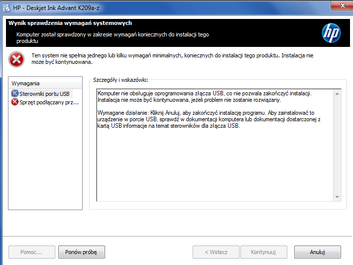

    Hello. I'm trying to install a printer on my laptop (Lenovo G50-80 Windows 7, 64bit). A message appears during installation (see screen). I don't know what the problem is. I installed all drivers from Lenovo, the laptop is fresh from the format. The printer and USB cable are certainly functional, because the device works on two other computers. I will add that it was also impossible to install before the format. All other USB devices work without a problem. I tried to connect the printer to each of the sockets.
    • HP Deskjet Ink Advant K209a-z - Problem installing the printer. drukarka.png (56.02 KB) You must be logged in to download this attachment.

    There are no USB drivers installed. On your computer, go to Control Panel, then Hardware and Sound, then Device Manager. The list will expand and select Universal Serial Bus controllers there. Expand it and check if there is a yellow warning next to one of the lines. If necessary, install the device driver at this point. If there is no warning you need to update the drivers for USB ports. After reinstalling the drivers, reset the computer and then install the printer.

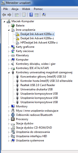

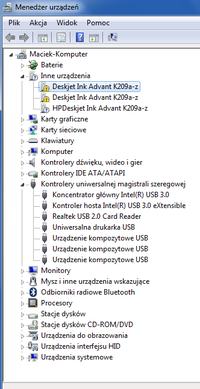

    Posts: 6
    There was no warning in the device manager. I have reinstalled the USB drivers, but the problem persists. I attach a screenshot from the device manager. Windows shows that all USB drivers are up to date.

    Looks like a HP underdevelopment.
    Here's how to work around the problem: http://forum.benchmark.pl/topic/191995-sterow...uje-IĘ-bo-stwierdza-że-nia-mam-sterownik-usb/
    But you won't have a 'printer service center', i.e. you won't see ink levels. You can scan, but not through the HP program - because it will not be there.

    Thank you very much for your help! :) Problem solved. Best regards.
