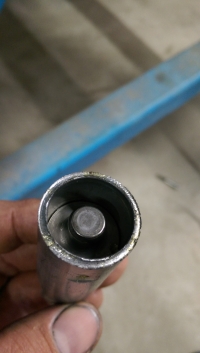

    Hello, I got a damaged Bosch 2-26 DFR rotary hammer. After replacing the brushes she started, but with virtually no stroke. I replaced the following: 321/59, 321/58, 321/60, 26/56, bearing on the 3/14 rotor, plate 48 and bearing underneath.
    Bosch GBH 2-26 DFR Rotary Hammer - No Stroke Issue, Replaced Parts 321/59, 321/58, 321/60
    Everything folded and greased but no impact. What else could I miss?

    The spire (321/28) whole? Not very vaulted?
    For verification elements No. 823. Are "teeth" ok, also in the center of the self-aligning bearing. Is the bearing on the shaft (24) in the correct position.

    I will check the dimensions and measure, I will make photos of cloves because they are actually a little worn.
    I found a photo with the dimensions of the needle to compare. Bosch GBH 2-26 DFR Rotary Hammer - No Stroke Issue, Replaced Parts 321/59, 321/58, 321/60
    Are these correct?

    And the piston in the sleeve slides at all? Because with too tight O-ring and thick grease it will stand in this sleeve.

    The piston can be pushed with a finger and then returns. Feel the pressure under the piston.
    I send pics. The bearing on the shaft 24 is 4.5mm from the rack.

    The item in picture 4 is weak. The teeth should not be cut off, and the bearing on this shaft would move closer to the rack.

    The heart of the stroke is the swivel bearing, which causes the piston to reciprocate. The drive for this bearing from the rotor is transmitted by a gear with a claw clutch. This clutch may have worn down, which simply slips and is less effective. These hammers also require proper lubrication. The most appropriate solution in this situation would be for the tool to review the authorized service.

    Hello, I have 2 questions about the topic. Should the piston go in lightly because I feel so hard lubricated to the extent that I had to drive it with copper. Once it is in its place, you can feel it springing up the cylinder, there is no noticeable burr inside. On the outside, it does not end with a cone, it has light burrs. New O-ring. As for the spire it is chipped at the end and probably for this I have damaged this little O-ring on it but it is not a problem. I think that was the reason for the leakage of grease. A colleague gave the length of the needle 69.6mm mine is 66mm but it is probably impossible for so much to stand out besides you can see this chamfer at the end. Can I use Eps-1 Lubriten grease? I add pictures greetings Bosch GBH 2-26 DFR Rotary Hammer - No Stroke Issue, Replaced Parts 321/59, 321/58, 321/60 Bosch GBH 2-26 DFR Rotary Hammer - No Stroke Issue, Replaced Parts 321/59, 321/58, 321/60 Bosch GBH 2-26 DFR Rotary Hammer - No Stroke Issue, Replaced Parts 321/59, 321/58, 321/60 Bosch GBH 2-26 DFR Rotary Hammer - No Stroke Issue, Replaced Parts 321/59, 321/58, 321/60

    You have a damaged aluminum cylinder. It hits element 833, which should not take place. To view the entire interior of the steel cylinder. The circlip is probably truncated.

    In fact, my friend Lemur, I pushed out the needles with a screwdriver. This ring did not hold at all and is not round and I was wondering which side should be ehh. The latter in the photo is probably also to be replaced? What about the other questions?

    I would exchange a spire, 3 mm too short, additionally broken.
    What do the elements 833, 321/46 look like?
    The aluminum cylinder includes various other elements, the whole designation 26, the cost at the Bosch store, some 52 zlotys.
    Take a look at the sleeve from part group 821 inside.
    It is best to use a grease dedicated for the tool, you will easily get these 40 g at the first best power tool service, stores also have it.

    The piston should come in lightly, but tightly with a noticeable compression of the compressed air underneath it. The piston, as well as other transmission elements, should be lubricated with grease recommended by the manufacturer no. cat. BOSCH 1615430001. The spire in this condition should be replaced. You can possibly grind the tip so that it does not cut the seal. However, it is already much shorter, which makes the impact transfer efficiency much smaller.
