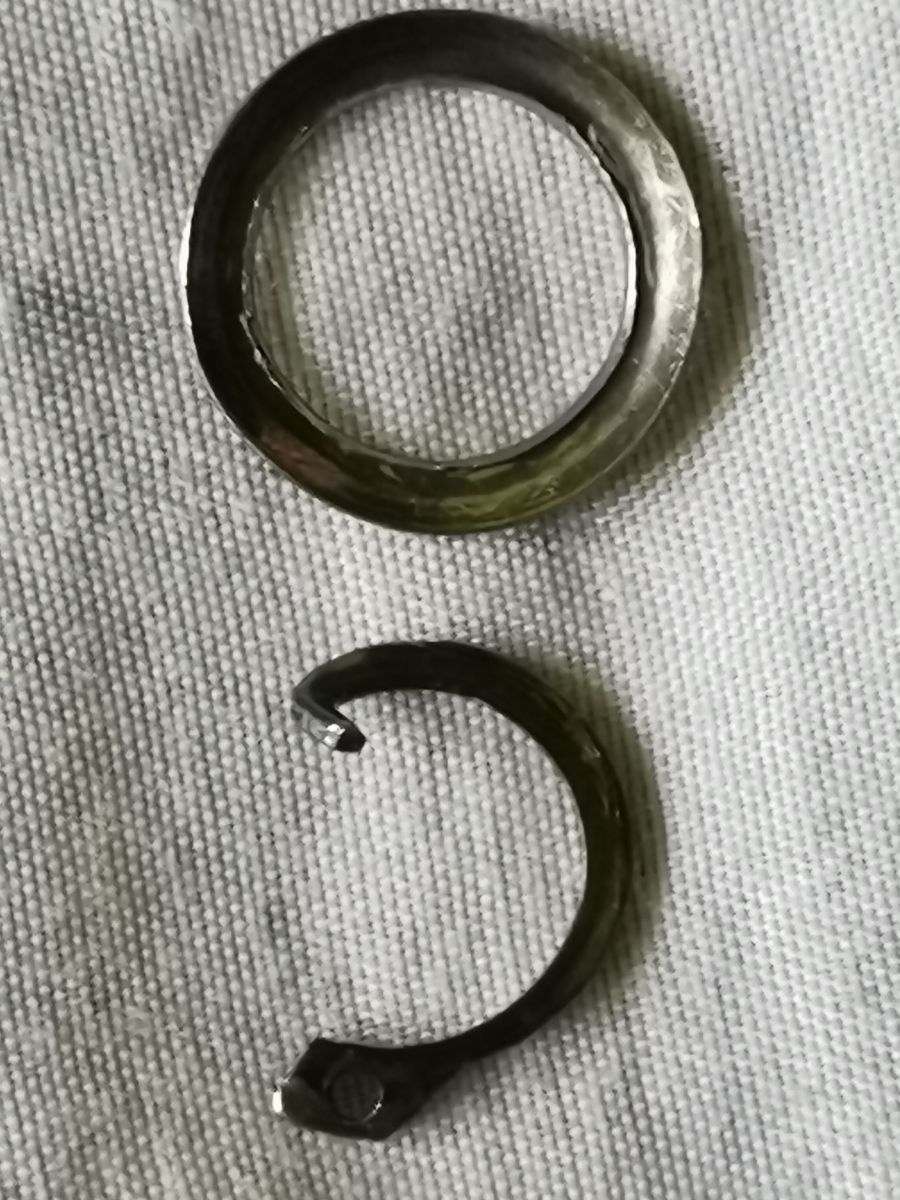

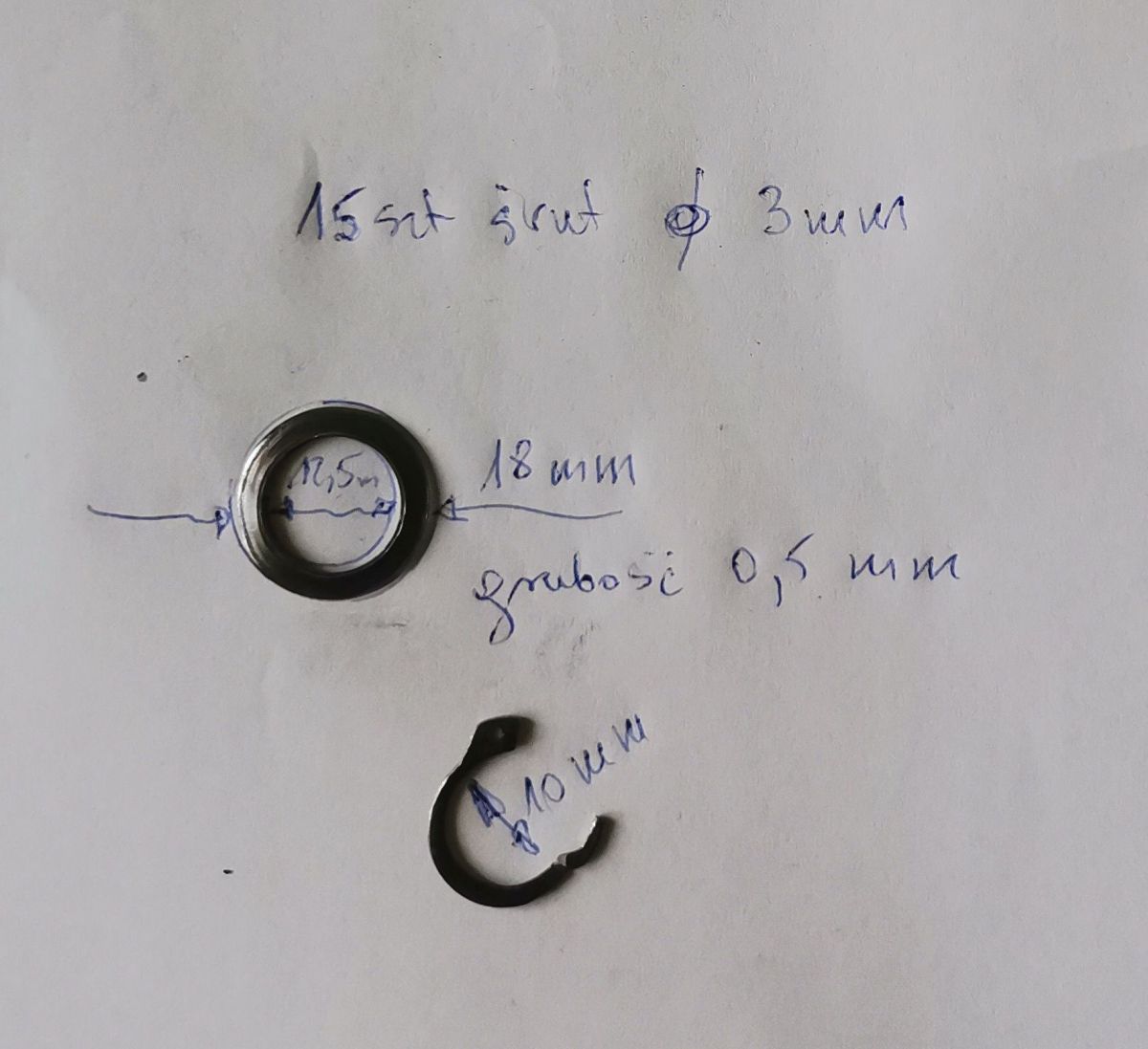

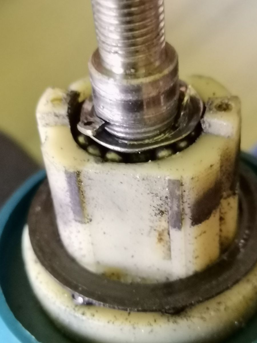

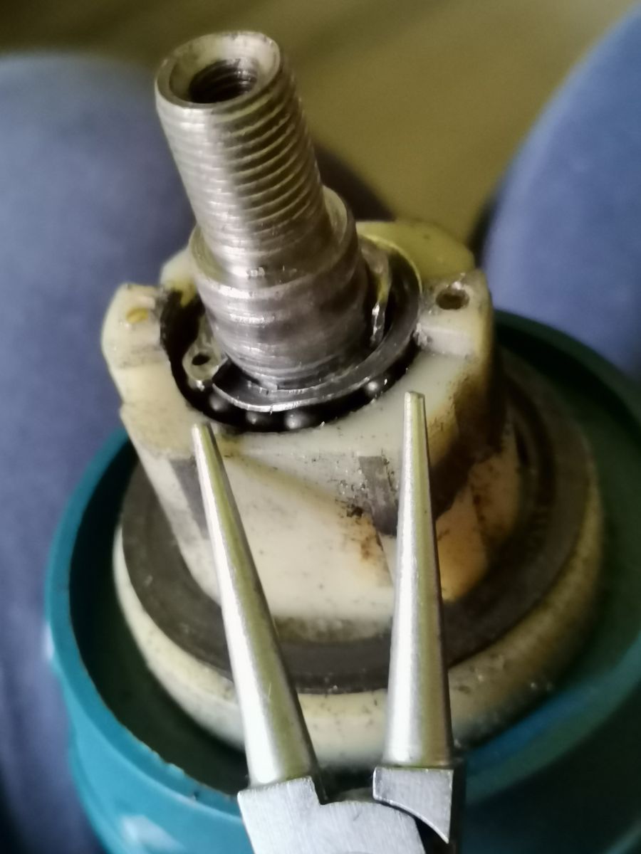

    The same thing happened to me today: sideways beating of the drill chuck without drill bit and after dismantling the cause: there is no bearing or at least no garland for the sharps on the outer circumference of the bearing balls is plastic, so there is already a gap and slack for the insertion of another ball, and in addition, the seger ring could not withstand such a plastic formation on the circumference of the balls as can be seen in the photo below and has already broken off a piece of it on the right side and it has become impossible to do as the author of the topic describes in the first post, i.e. the "beating" has reached about 3 mm sideways at the very end of the drill chuck. By the way, the washer over the sharps has already bent so much (to be replaced) that it would break in a moment and the sharps would fly out completely? The damaged binder ring had already gouged a second groove in the wrong place, as can be seen in the second photo. The "fur" should have been unscrewed from the front much earlier and all this should have been corrected.... I'm not complaining about the manufacturers because it's not allowed, but the device according to the EU guidelines is supposed to break down within 3-4 years because there is no repair directive yet and no production of spare parts.... :) As much as one asks, the use here of a third, decent bearing in this type of power tools.I leave the conclusions to each of you to think about.... And above all, how many years it must have taken for someone to give you the cause and dispel your doubts and quibbles and blaming it on drills or other components. In general, I guess I am stupid and mistaken because others are making money from this and I am giving a solution to the problem pro publico bono for free.... This forum should be for professionals like a doctor's forum, not for those who are afraid or don't know for 10 years how to use a screwdriver and an Allen.... I doubt if there was a garland of bearing balls as I am a first time user and have not lent this screwdriver to anyone.... Well, and there wasn't an ounce of grease in there. Of course, as usual, I leave myself open to the possibility that the drill chuck itself can also generate lateral "run-out" as can the aforementioned bits....
    Proof: Close-up of a damaged drill chuck with an exposed circlip. Close-up of a damaged drill bearing with visible crack in the plastic ring. Damaged snap ring and washer on a white background. Damaged circlip and washer with size markings on a white background. .
    How to remove the drill holder can be found here: Link .
