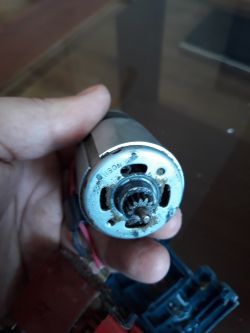

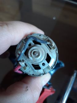

    My Bosch GSR 14,4-2-LI screwdriver for several years recently began to spark like on the attached video. At low speed it is ok but when the engine stops at high speed, sparks fly and smell. I suspect brushes, so now the question is how to disassemble and replace them on this engine? It is pressed on the back. New, original costs PLN 200 (e.g. here ) so its replacement is unprofitable - it is better to buy a new screwdriver.
    Or maybe they are not brushes? I am asking for help in solving the problem.

  • #2 16970644
    Kamilpl123
    Posts: 409
    Help: 17
    Rate: 42
    Hello, brushes in this model are unchangeable. It only remains to buy a new one.
    greetings

    Sparking when the engine stops is normal.

    Yes, but not so much spark. Besides, there should not be a smell of burning.

    And you can not see the brushes through all the holes in the motor housing?
    The motor can be undressed only not easy because it is pressed.
    You have to work a little to do it.
    Tighten the motor in a vise and use a small screwdriver to straighten these creases.
    I was opening a similar engine once.

    With the opening and assumption there will be no problem, I wonder more about whether I will get the right brushes on the market and whether they can be replaced. Because if it's not the only thing that's left to me, I'll get the engine to the end.

    errol wrote:
    I am more concerned about whether I will get the right brush on the market
    If you can dismantle a pressed engine, it should not give you a problem to find similar brushes, or to make them.
    errol wrote:
    if they can be replaced.
    Someone put them there ...

    Hello. It looks like the engine is fine. You have a screwdriver that has an auto-stop function, ie when you turn it off with the button, the engine stops immediately. For a fraction of a second after releasing the switch, the voltage is applied in opposite phase to stop the motor immediately. At this point, the sparking on the brushes increases, the higher the higher the engine speed. The motor and brushes are okay, the normal operation of this motor in this screwdriver.

    I do not want to create a new topic, I will ask if the carbon brushes can be ground off the side, because they fit too tightly into the brush holder? It's about grinding 0.1-0.2mm on the side.
  • #13 17493852
    jerry1960
    Level 37  
    Posts: 3021
    Help: 285
    Rate: 1560
    You can sand down. the brush should slide loosely in the brush holder.
