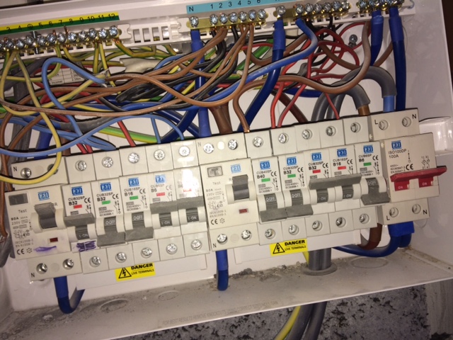

    Hello, dear group of professionals.
    Recently, a colleague from work asked me to take a look at his electrical installation in England. I defended myself against this for a long time because I do not have the appropriate knowledge and documents. After some time, hearing from my friend that the electrician had left him a plan on the wall on how to connect the wires and the friend was sure he knew how to connect "plus and minus", as he put it, I decided that I would take a look at it. I removed and secured some old wires hanging from the walls, which, surprisingly, were under voltage and there were three small children in the house. Later, I had to use one cable to connect to the switchboard, because that was all he asked me to do :P
    So, TN-S type installation, single-phase installation, WLZ 25mm, Pe cable connected to the house together with N and L, i.e. no PEN distribution in the house. The rest is as in the photos.
    Note: the photos were taken after the intervention of "Master Kowalski" of everything - bricklayer, plasterer, acrobat """ visible blue colors of wires connected to overcurrent fuses, I had the opportunity to see the installations of the first Alfa specialist.
    An interesting thing caught my eye, there is an output in the fuse with two wires - circlut line,
    i.e. the L wire goes to the first socket, from this to the second, etc. and from the last socket in the circuit, the L wire runs back to the switchboard and is connected to the same fuse. So I scratched my head a bit and on the one hand it makes sense, because if there is a break in the circuit, e.g. between the first socket and the second one on the L wire, we still have voltage on the second, third, etc.
    However, the problem is with the size of the protection, which I do not understand and I am asking for clarification, because the wires are 2.5 mm and the fuse is 32 A.
    In my opinion, the security should be 16 A. [without calculating from formulas, etc.].
    I asked my friend to call and ask if the Alfa electrician hadn`t made a mistake, but Alfa said that twice 2.5 mm is equal to 5 mm, so it`s a kind of protection.
    I don`t like it a bit, because what if there is a break in the circuit, e.g. between the fuse and the first socket, and someone decides to connect two stoves and a kettle? A current of e.g. 30 A will then flow, and the long-term load capacity of Cu 2.5 mm is about 16 A. Moreover, it is the same circuit, so where is Kirchhoff`s first law here?
    I would like you to explain this, because in my opinion it is a mistake.

    In the beginners section - just congratulations.
    I don`t know the electrical regulations in England, but the 3x2.5 cable is NOT 5mm or 7.5mm, but 2.5 L, 2.5 N, 2.5 PE.
    Moreover, PNHD strictly defines the colors of the conductors for PE, N, L, and in this case only PE meets the color requirements. (We are in England, I may be wrong).
    Check whether switches at lighting points do not interrupt N. Constant Phase is unacceptable.
    These are just a few of my comments - let my colleagues who deal with this abroad add more - there is no shortage of them here.

    Everything is OK, read about the ring main circuit, it is a topic discussed millions of times on this forum and it is customary in every country. In the UK, this is how installations are made, and control measurements must be carried out every 10 years in homes to detect such errors, i.e. lack of continuity in the ring.

    With this overload, it`s not quite what you think. The appropriate number of sockets in the circuit and limiting the consumption to a maximum of 13A by the receiver rather meet this goal.
    Although everything is in the hands of the installation user.
    You can also omit the loop, but then you have to replace the double-track MCB with two single ones.
    Read posts and topics by 15kVmaciej. There you should find something on the topic that interests you.

    On page 77, table C 9.2 actually provides protection for the circuit in "ring" 32A.

    Moreover, you do not have and will not find a receiver with a cable with a plug that would draw more than 13A.
    This type of fuse only has (if I remember correctly) 3; 5; 7; 10 and 13A only these values.

    In homes, not all sockets are equipped with one 32A fuse. Bottom separately, top separately and kitchen separately. Let`s assume that you have 10 sockets on each circuit and there is a break in the middle, then you have 5 sockets powered on one side and the other 5 on the other side. You can guess in many ways, but it`s just guessing, you won`t change anything, when something melts, you make two radials from the ring and then add 16A protection

    lasica1985 wrote:
    So, TNC-S type installation, single-phase installation, WLZ 25mm, Pe cable connected to the house together with N and L, i.e. no PEN distribution in the house.
    The installation is definitely TN-S.
    This is nothing unusual, until recently in the UK the phase colors used were red, yellow, blue, and the neutral black.
    lasica1985 wrote:
    2.5 mm cables and a 32 A fuse.
    This is normal in the UK, and the PE conductor had a smaller cross-section than the phase and neutral conductors.
    And by British standards 32 amps for a ring circuit. For radial circuit 20A.
