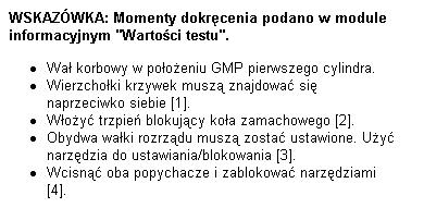

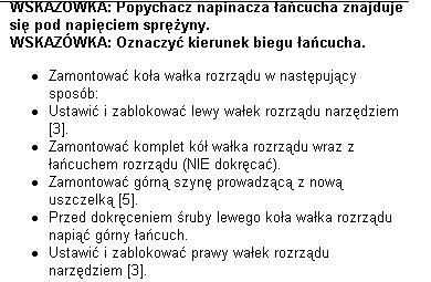

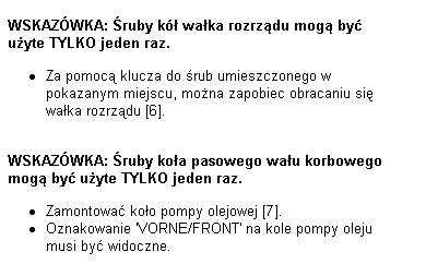

    Cobrat
    Level 22  
    Posts: 428
    Help: 35
    Rate: 502
    Below are attachments:
    BMW e39 2001 5 Series 3.0d 192 km: Request for Timing Chain Diagram and Guidance BMW e39 2001 5 Series 3.0d 192 km: Request for Timing Chain Diagram and Guidance BMW e39 2001 5 Series 3.0d 192 km: Request for Timing Chain Diagram and Guidance BMW e39 2001 5 Series 3.0d 192 km: Request for Timing Chain Diagram and Guidance
