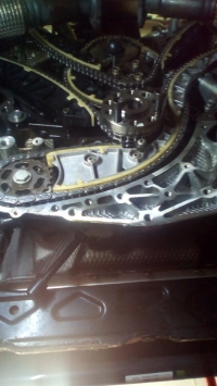

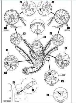

    Hello, I need a timing diagram for A6 3.0tdi from 2013.
    The second generation engine on 2 long strings are on pins and I have them blocked I am interested in being 100% sure because markers are different :-)
  • #2 16740490
    diodabg
    Level 30  
    Posts: 1292
    Help: 133
    Rate: 627
    I found on YouTube in an older version of the engine on four chains and I did not expect a lock in the oil pan :-)
    https://www.youtube.com/watch?v=PvEQOXv-9Jw
    In the newer blockade is also in the bowl but in a different place like the picture in the black oil sump.
    Seeking Timing Diagram for 2nd Generation Audi A6 3.0tdi 2013 with Long Strings on Pins

    This is probably a complete set of information - I insert for posterity.
    Seeking Timing Diagram for 2nd Generation Audi A6 3.0tdi 2013 with Long Strings on Pins Seeking Timing Diagram for 2nd Generation Audi A6 3.0tdi 2013 with Long Strings on Pins Seeking Timing Diagram for 2nd Generation Audi A6 3.0tdi 2013 with Long Strings on Pins
