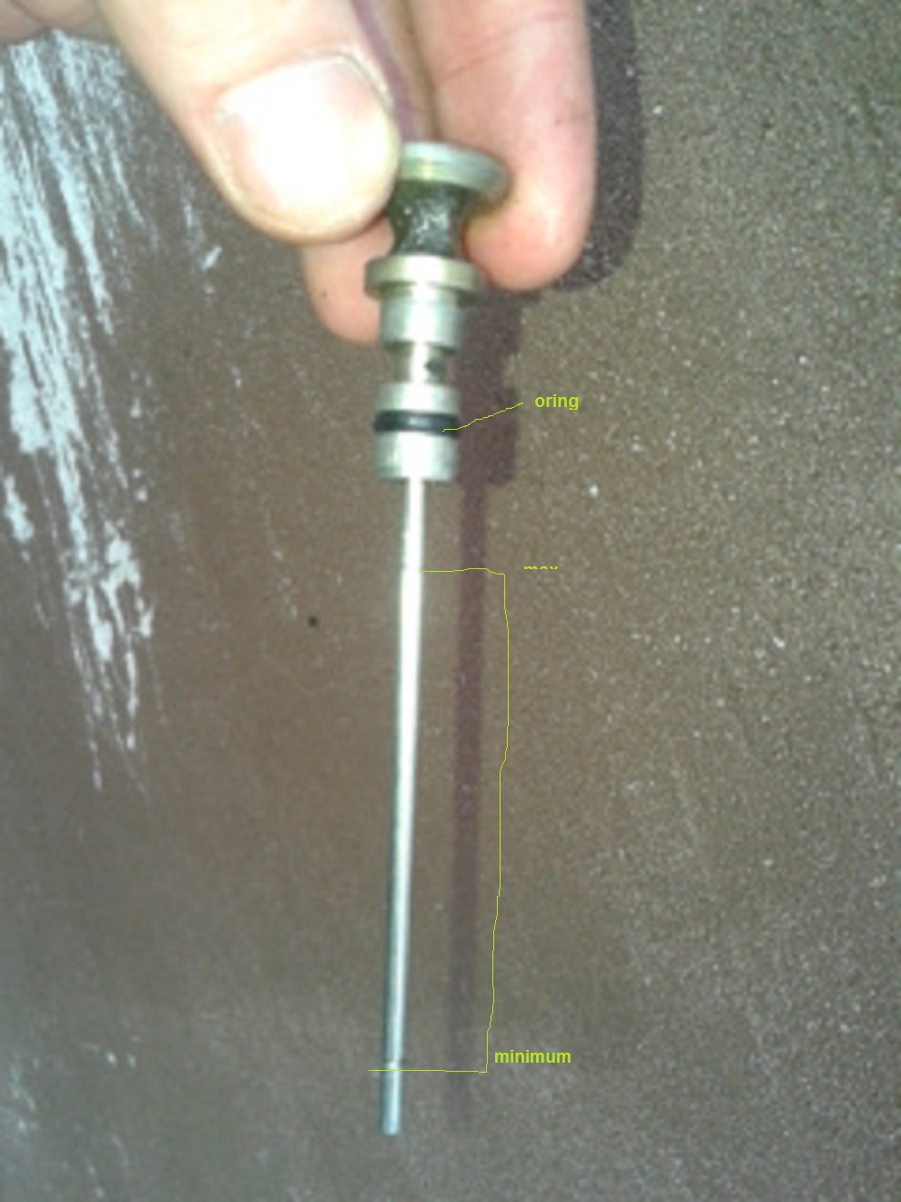

  • #2 16297032
    daro31ie
    Automation specialist
    Posts: 2432
    Help: 366
    Rate: 650
    Buddy ordinary oil for compressors
    Half the bayonet level.

  • #4 16301321
    magnus27
    Posts: 569
    Rate: 310
    I put a picture of the bayonet. should the level be half as I have marked the minimum-max?
    I have oily oil under my collar, I think it's the oringu wine that has become hard. Is it possible to buy such an original oring somewhere?

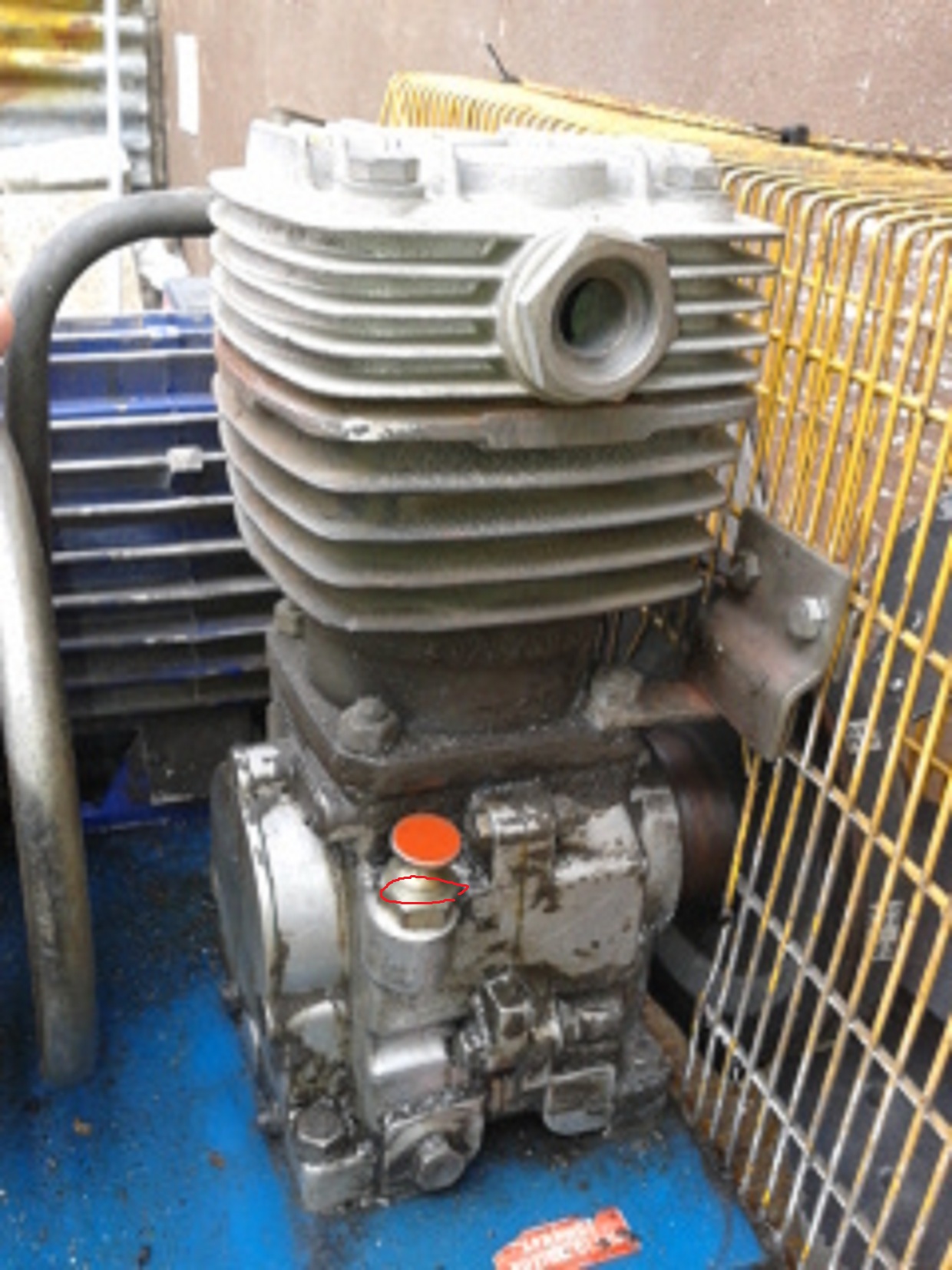

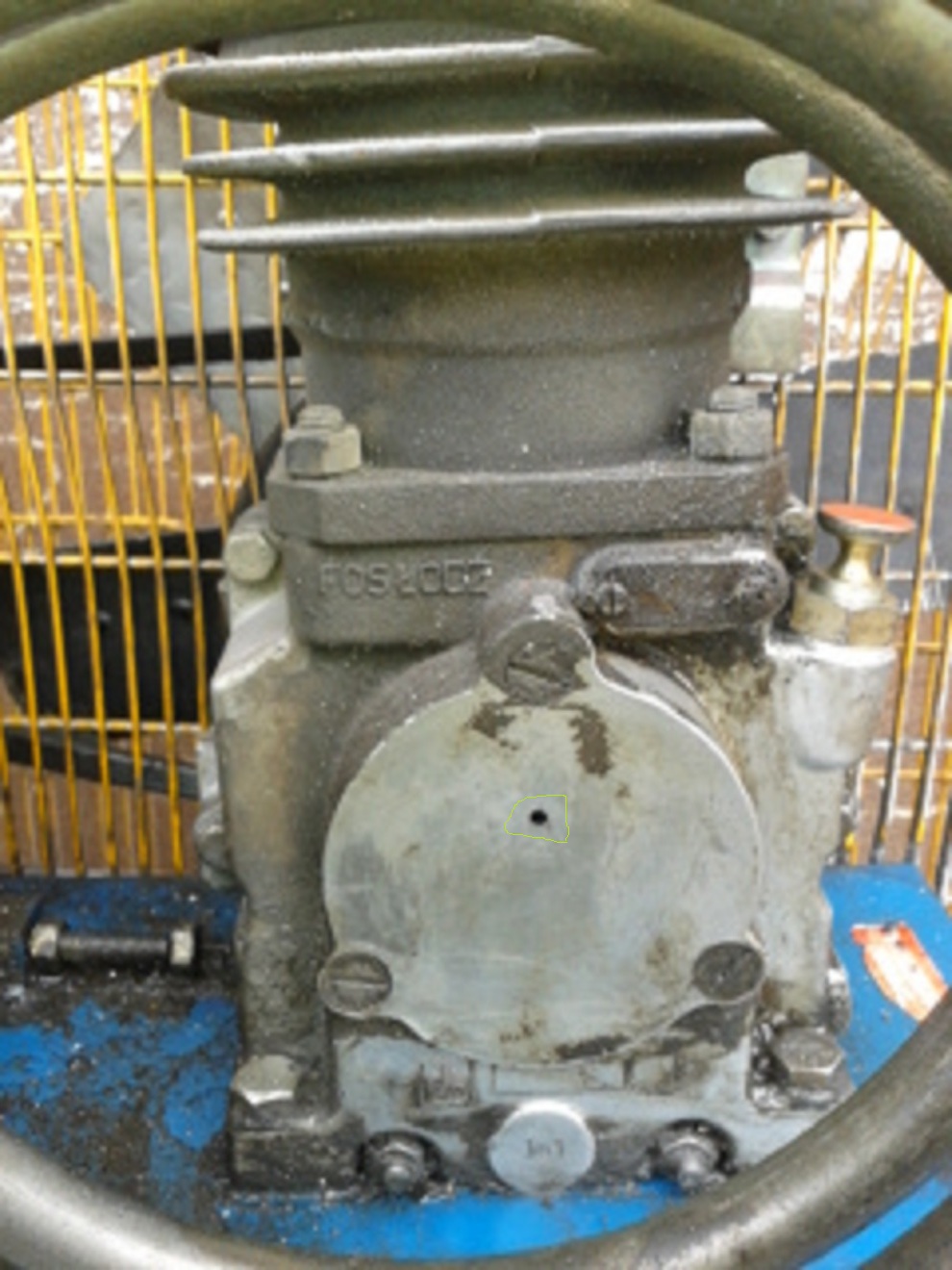

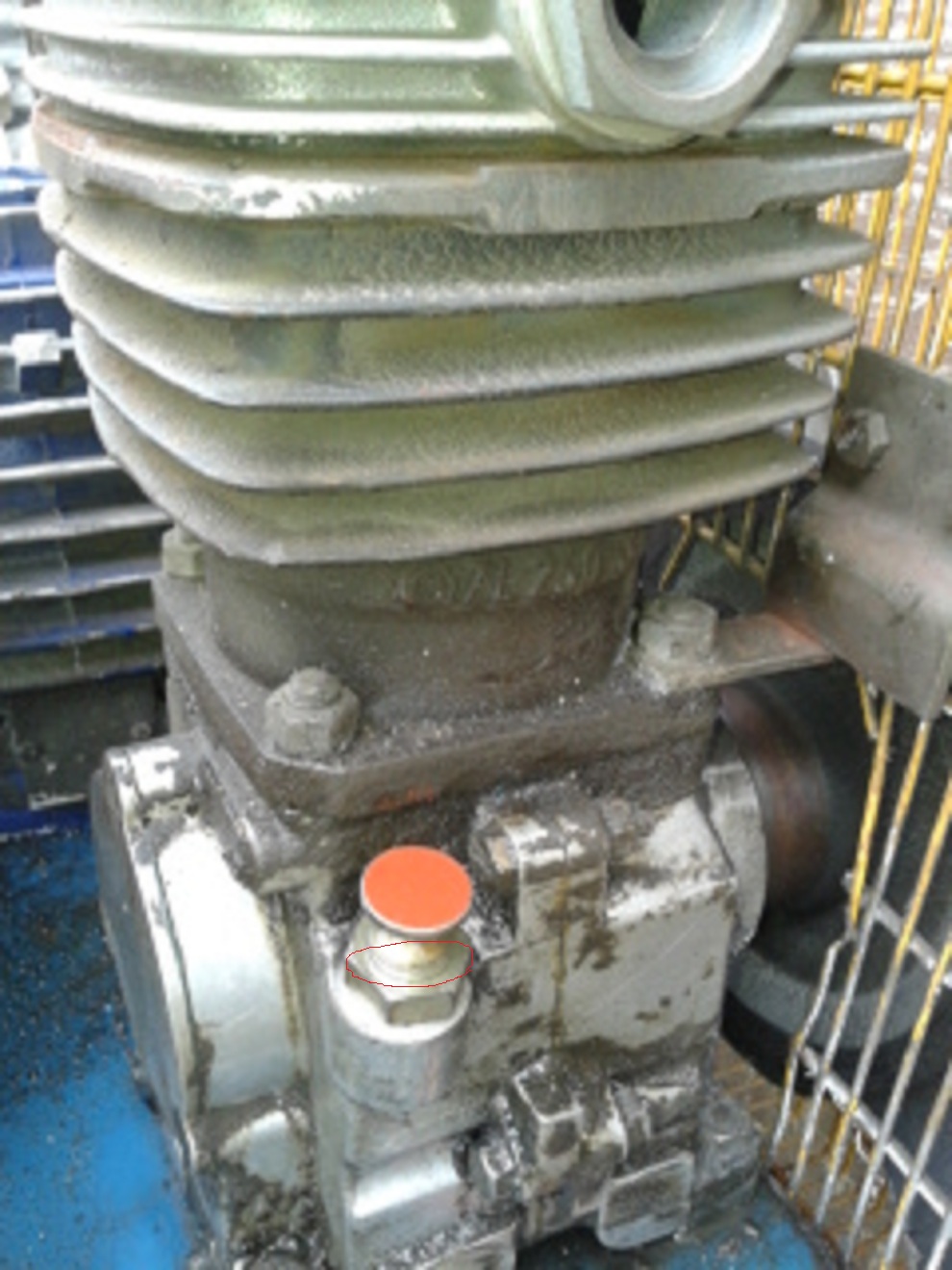

  • #9 16533527
    magnus27
    Posts: 569
    Rate: 310
    Here is a photo of the compressor, the leak is from the oil dipstick (marked in red, is the green hole marked in the vent and how to check if it works?
    • Piston compressor dioryt 50 l - What oil and how much to pour it Zdj8cie0022.jpg (257.91 KB) You must be logged in to download this attachment.
    • Piston compressor dioryt 50 l - What oil and how much to pour it Zdj9cie0024.jpg (265.89 KB) You must be logged in to download this attachment.
    • Piston compressor dioryt 50 l - What oil and how much to pour it Zdj0cie0023.jpg (384.54 KB) You must be logged in to download this attachment.
    #10 16533535
    bearq
    Posts: 4888
    Help: 414
    Rate: 1612
    This hole is just the crankcase ventilation, in these simple compressor is nothing but a hole so you should put something in there.

  • #11 16533543
    magnus27
    Posts: 569
    Rate: 310
    So is it just a hole in the hole to the crankcase? If so, it seems to me that it should first spit with oil and not through a measuring cup with o-ring.
    #12 16533641
    bearq
    Posts: 4888
    Help: 414
    Rate: 1612
    Yes, and as the compressor is in poor condition it only flies with you, probably killed with dirt, so it blows out from under the bayonet ;)

  • #14 16533877
    bearq
    Posts: 4888
    Help: 414
    Rate: 1612
    Blow this vent with air, you will hear when the air passes into the crankcase and escapes with a measure of oil.
