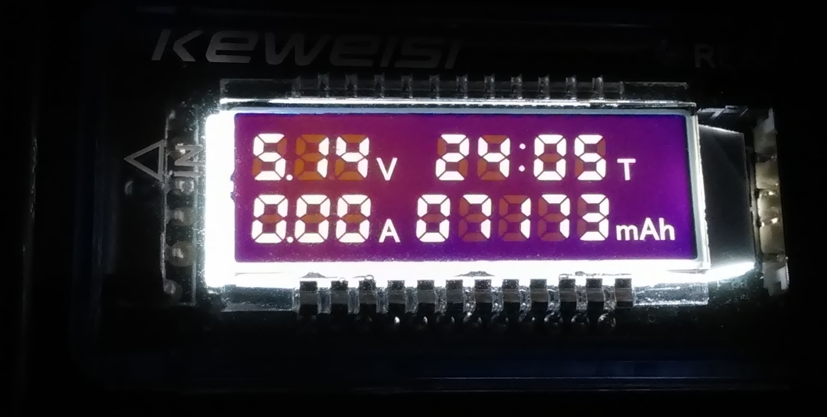

    I decided to check how much RPi3 needs energy.
    The measurement lasted 24 hours. Most of the time the computer operated more or less like this:
    load average: 0.12, 0.08, 0.09
    under the control of OSMC Media Center with Kodi running.
    In addition, jDownloader was launched in Java in headless mode.
    A USB flash drive is connected to Raspberry. For GPIO, DHT11 sensor powered from 3.3V line.
    Score:
    24-Hour Raspberry Pi 3 Power Consumption Test: OSMC Media Center, Kodi, jDownloader & DHT11 Sensor
    This means that the monthly cost of electricity is about PLN 1. I assumed 0.6 PLN / kWh and 70% efficiency of the 230/5 V power supply.
    (7200 mAh * 5 V) / 70% = 50 Wh (per day).
    50 Wh * 30 days = 1.5 kWh.
