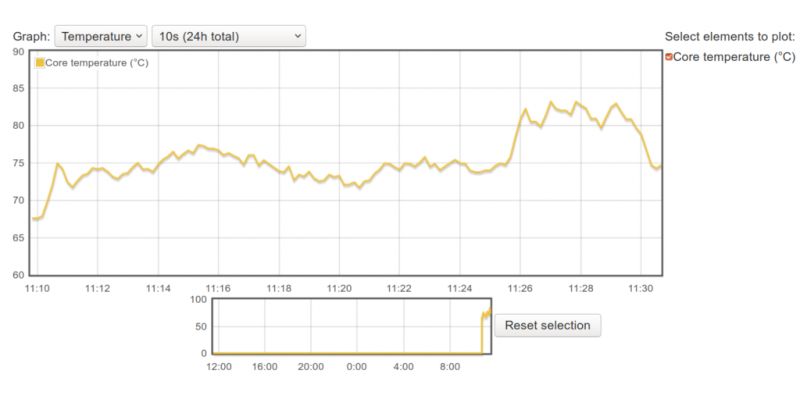

    Raspberry 4 - Reference Test
    First, let's run the SBC-bench test on a regular RPi, without any cooling systems. The performance test report looks like this:
    Code: Bash
    The temperature during the tests behaved as follows:
    Active cooling for the Raspberry Pi 4 minicomputer
    The 7-zip usage test did not complete because the application ran out of memory three times. This is perfectly normal for a Raspberry Pi with 1GB of memory, which is on the verge of application requirements.
    Despite the problems, it was possible to collect temperature data. Initially, it amounts to 67 ° C (idle) and grows to over 80 ° C under load. That's a lot - at 85 ° C Broadcom BCM2711 triggers thermal protection and reduces computing performance.

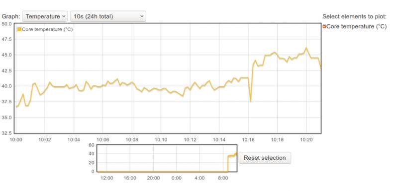

    Heatsink and fan
    Run the SBC Bench script again after installing the heat sink. The test is similar to the reference case. The performance test results are as follows:
    Code: Bash
    Here, again, 7-zip used up all the available memory and couldn't finish its work. With the heatsink, the Raspberry Pi 4 at rest reaches 37 ° C, and under load, the temperature rises to 46.2 ° C (multi-core load using 7-zip).

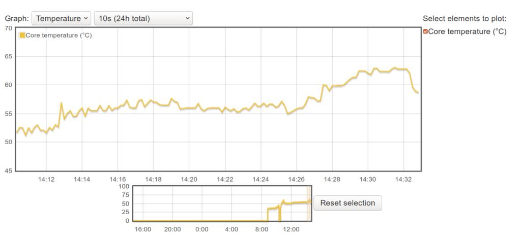

    The heat sink itself
    We can disconnect the fan's power wires and even remove it completely, as it is just screwed onto the heat sink. Nothing will shine and make noise.
    Let's repeat the above test:
    Code: Bash
    The temperatures, as seen below, are higher, but the system is still quite cool. When idle, the Raspberry Pi 4 reaches around 42 ° C. The maximum temperature reached by the SoC of the module under load is 61.2 ° C.
    Summary
    The above tests mean that the heat sink alone is more than adequate for most Raspberry Poi 4 use cases. It is even too large as a much smaller heat sink should suffice for cooling in most cases.
