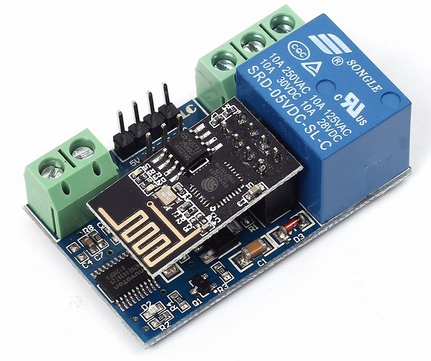

    For lighting control, to be connected behind a switch, the best solution, were these modules?
    How do I power the ESP8266 devices in a Domoticz system on a Raspberry Pi B3+? .

    To the 2-pin connector is a 5V power supply, the 3-pin connector is a relay connector, where one is COM (common) and the other two are respectively NO (normally open) and NC (normally closed), The goldpin connector is serial. There is no input on the gpio so push button control is not possible, only via WiFi.

    ociep14 wrote:
    Do you know any solution for control via wifi and manually?
    Yes connection just like you connect a staircase switch.
    On one side the staircase switch and on the other the relay contacts. The control can be alternated. The only inconvenience is the lack of real status information.
