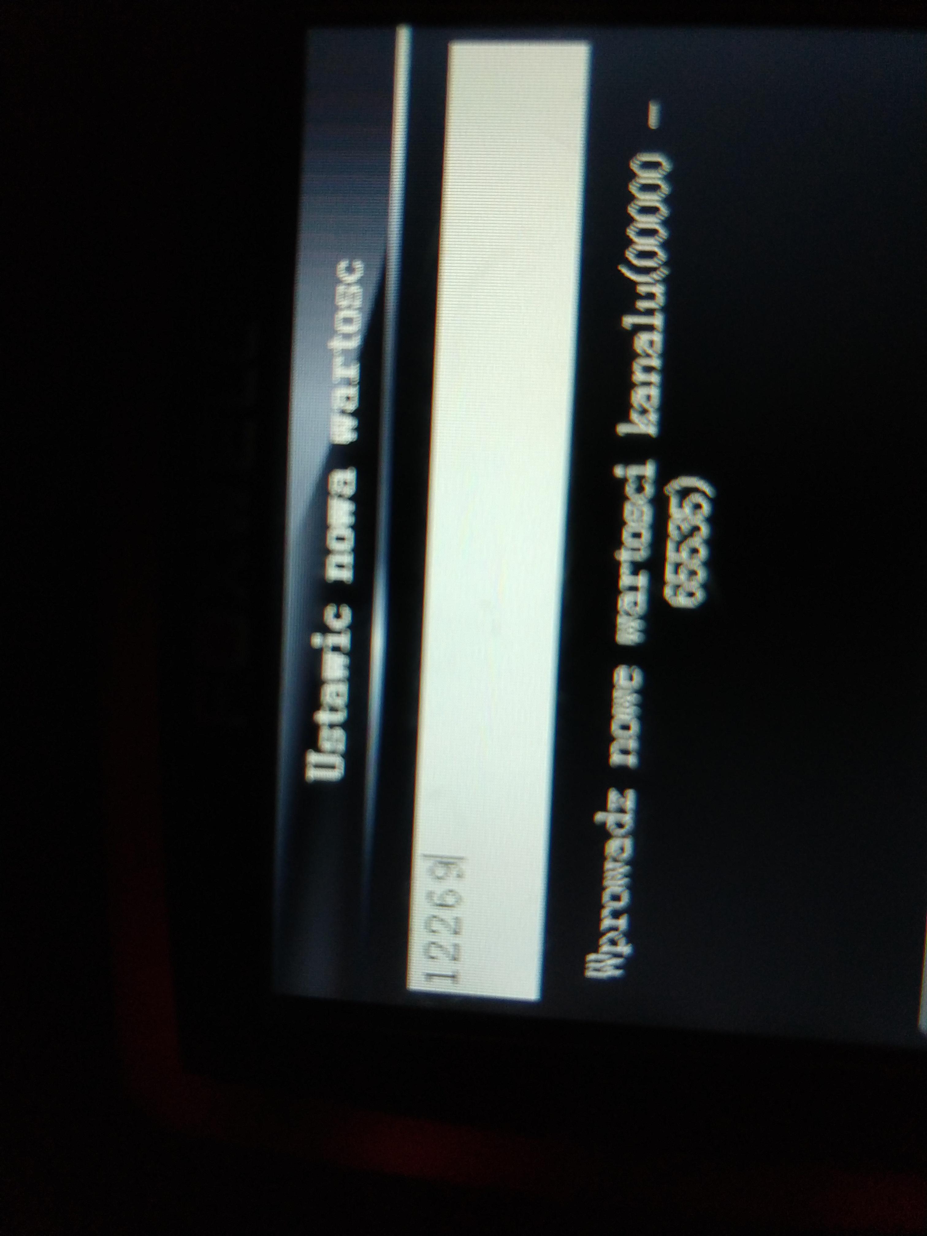

    Hello, I have a radio clock module and it works, but for about 2 months there is no finger. I checked the encoding in 17 adaptation (10) and channel 19 and I have something like 12269 there, the scanner is good because foxwell and I can't change this 9 to 1 or 0. Maybe some ideas?
    I am asking for help in solving the problem
    The car is an audi a4 b7 1.9 brb from 2007 with RNS-e

    RDS has nothing to do with clock synchronization with DCF77, if you have coding ok then the antenna that is under the rear lamp under the bumper is most often damaged, you need to replace it, before you can check if the contacts are not tarnished and whether the antenna is interrupted by 5V.

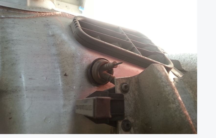

    The coding is very strange 17 Instruments adaptation10 chanel 19 coding 12269. And the antenna in B7 is in the bumper at the rear? Seriously? I thought behind the counter?

    Yes, it is in the bumper on the right under the lamp :) The RNS-E update has nothing to do. It may also be that you do not have coverage (parking in the garage etc.) you traveled somewhere further away? Maybe it will catch the signal, if it's not the antenna released, it's a standard fault.
    In vcds I have this coding (A4 B7 3.0 TDI 2005) in channel 19 in the meter:

    Yes, I traveled a few more routes and nothing, the fact is that the antenna amplifier error. I don't have the error code because I deleted the picture but it is already a concept to solve the problem, I need to get to this module and see the plugin. Maybe it's actually tarnished but coding is very weird 12269 on this channel. But this is checked by the foxwell interface and it can be the reason for such reading. And when trying to encode a write error message. I need to check this cube and the module itself.
    And it parks in an open space in a parking lot where there are not many blocks, trees and the signal should be good rather.
    I understand that this is a module from the photo?

    Yes that's it :) The fact the coding you have strange, drive up to someone from VCDS. Somewhere under the fuel filler from the inside is the connection of this antenna, see if there is 5V there.
