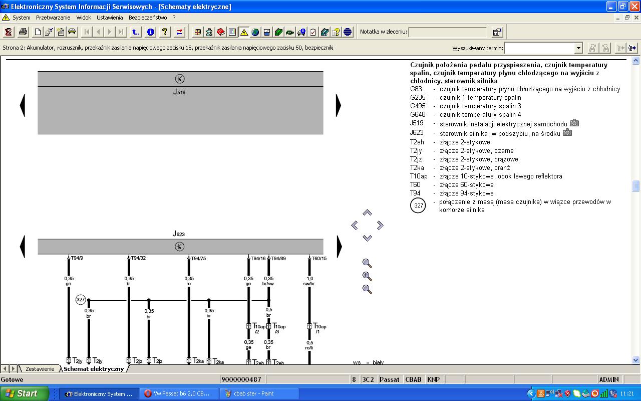

    The car does not light.
    I am looking for an electrical fuel system diagram, the fuel pump in the tank is working properly.
    My suspicion falls on the pump below.
    Does anyone know what kind of currents should be on power cords?
    Is there a relay from this pump?

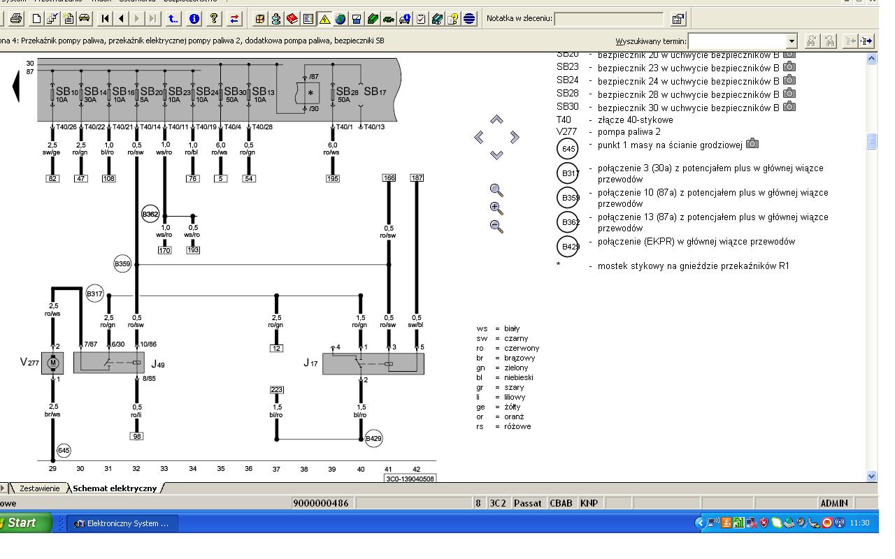

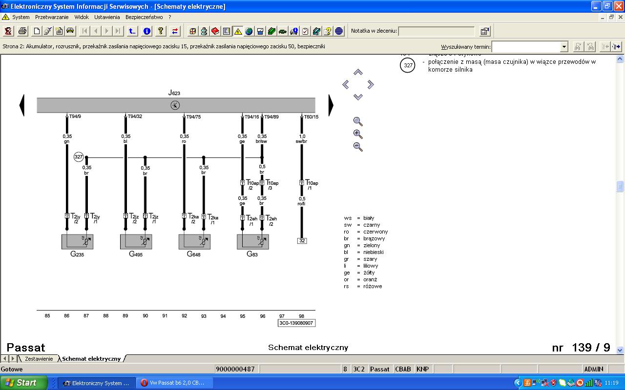

  • #10 16323258
    kszychu
    Posts: 126
    Rate: 56
    and the car ignited, but ...
    There is no relay number J49 in this pass. in the bracket under the board.
    The car started off after I gave the pump 2 power rigidly by removing the relay 2.
    The relay bracket does not receive any wires in place of relay 4 J49.
    The question is whether the above scheme is certainly correct.
    Where can the next J17 relay be located which controls the above J49.
    There is voltage on pin 6. On pins 10 and 8 also.
    Can I ask for a further diagram 98 showing power on pin 8?
    I can ask for diagrams
    #11 16326244
    fructon
    Posts: 1594
    Help: 241
    Rate: 983
    tu Vw Passat b6 2.0 CBA - Problem with controlling the fuel pump. It does not light Vw Passat b6 2.0 CBA - Problem with controlling the fuel pump. It does not light
  • #12 16326289
    kszychu
    Posts: 126
    Rate: 56
    ie the relay receives a signal from ECU (J623).
    so if the connection to the ECU is correct, is it possible that the driver is damaged?
    Is it possible to emulate the signal from the controller in some simple way?

  • #17 16344159
    kszychu
    Posts: 126
    Rate: 56
    Problem solved.
    Lack of continuity between the T10 block and J623 pin.
    Thank you very much for your help in solving the problem.
