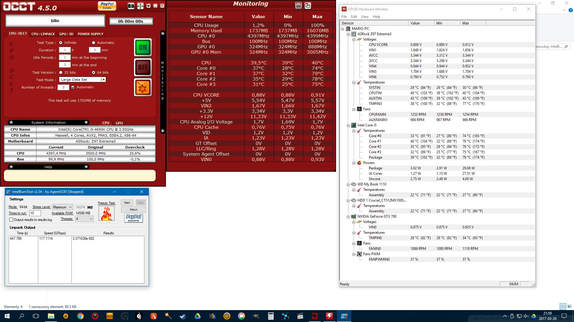

    Maybe a stupid question, but should the HW VCORE CPU monitor be around 1.32V and not 0.940V. I thought it should be the sum of vcore adaptive voltage and offset voltage. I might be wrong :) In any case, with these settings, the system crashes at the beginning of the intel burn test. Previously, the clock was set to 44 at vcore voltage 1.200 and offset voltage + 0.010V. It was a 2-year-old girl and it was OK but I would like to get something more out of him. Can be? :) Maybe I'm doing something wrong?

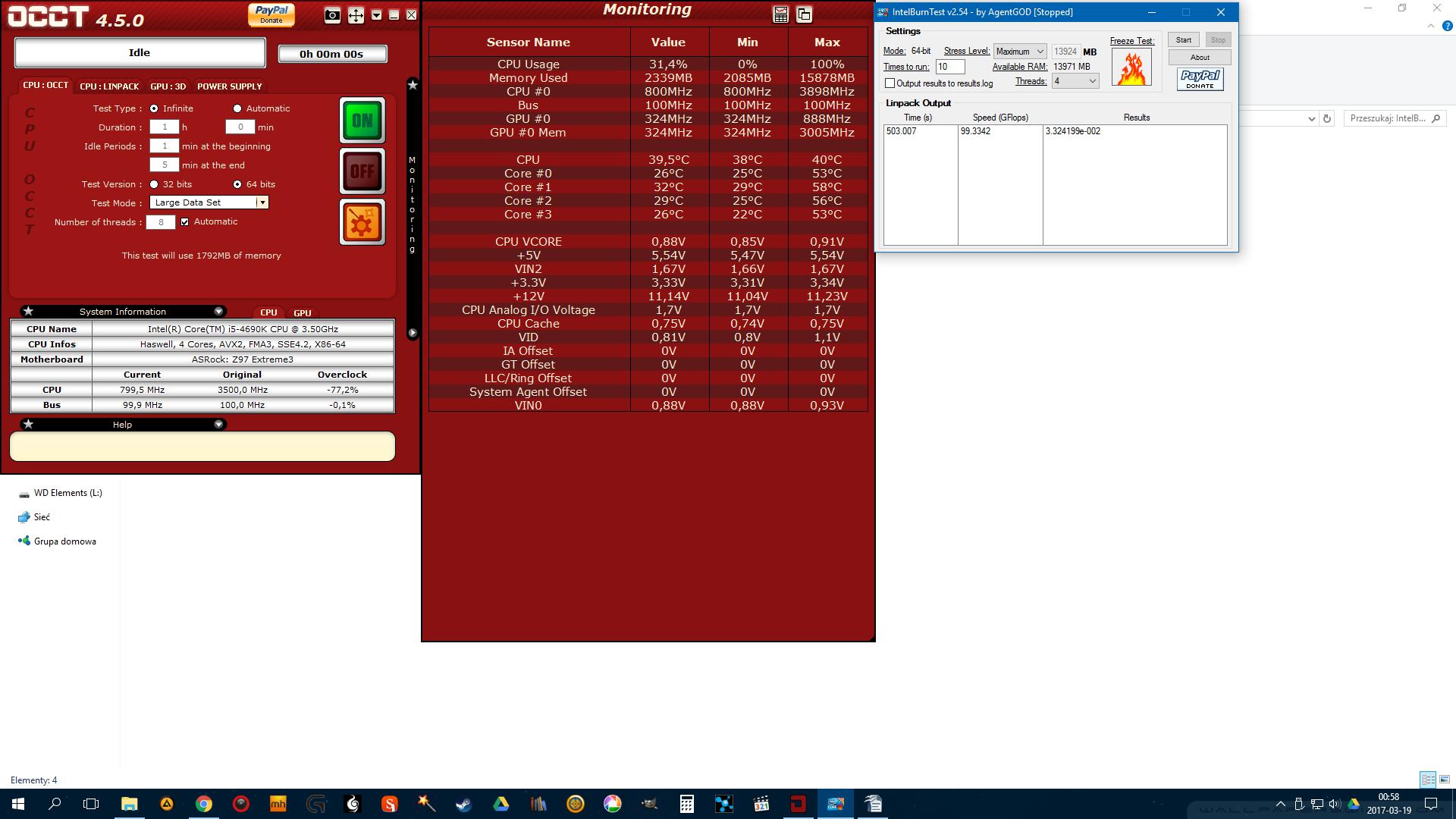

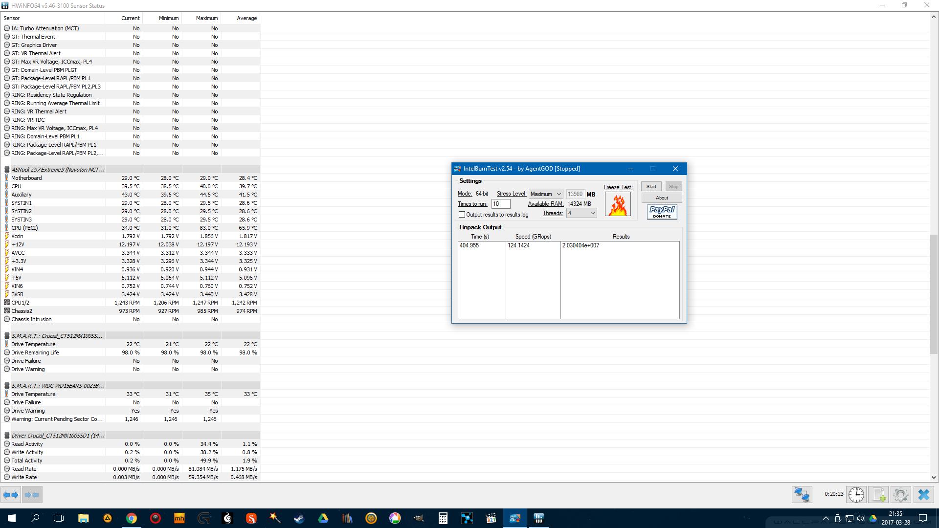

    I have reset the bios settings to the factory settings. Test done in IntelBurn Test at maximum load. Max temperature: 58 degrees. Below is a screenshot:
    i5 4690k Overclocking: ASRock Z97 Extreme3 Mobo, BIOS Settings & HW Monitor Voltages
    Then:
    CPU Vcore Voltage Mode changed from Auto to Override Mode
    Vcore Override Voltage changed from Auto to 1.275
    Vcore Voltage Additional Offset left at Auto
    Test done in IntelBurn Test at maximum load. Max temperature: 73 degrees. Below is a screenshot:

    I think that you will get to 1.35Vcore on this cooling (temperatures will probably be around 85 ° C under full load).
    You're giving 1.275Vcore for now and trying to max out.
    Input Voltage (default 1.8V) give 1.9V which would not limit it yet.
    Vcore Votlage additional offset, if I remember correctly, increased the voltage under load.
    You can give 0.05V auxiliary.
    You can use HWinfo to see exactly what is going on with Vcore during load tests.
    With this CPU you aim to around 4.5GHz. You start at 4GHz and go all the way to 4.5GHz testing 10-15min OCCT each time.
    When it crashes, slowly increase the voltage up to (for now) 1.325V.
    Monitor temperatures. When it starts to reach 85-90 ° C (in stress test) it means that you can't do anymore. During normal operation the temperatures will be lower.
    You go down to the last stable (also if he doesn't want to go higher at 1.325V) and give up the OCCT test for a few hours.
    As a last resort, you can try Input Voltage at a little over 2V (e.g. 2.05V), but be careful that the LLC does not break it much higher. Therefore, you should monitor both Vcore and Input Voltage (Vccin) all the time.
    However, this is a last resort as it does not want to move higher even with a very high Vcore (e.g. It does not go up 100MHz even when increasing from 1.32V to 1.4V). Generally, the processor usually "ends" in these areas, so it is only for squeezing the last MHz.

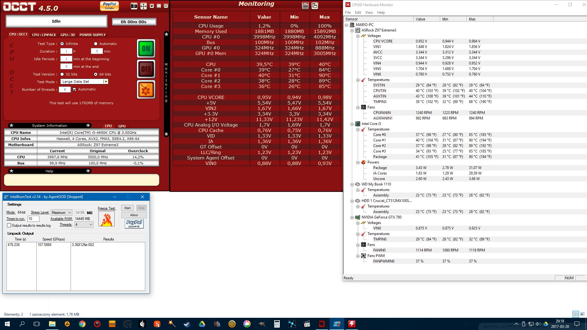

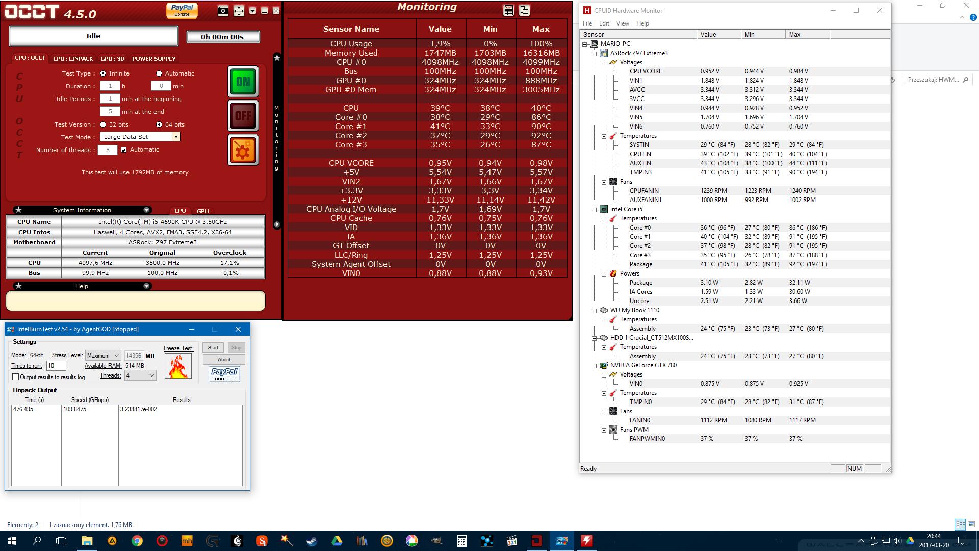

    First test and ........ temperature 90 ° C. Below is a screenshot from OCCT, Intel Burn Test and Hw monitor:
    Another test at All Core: 41 and 92 ° C

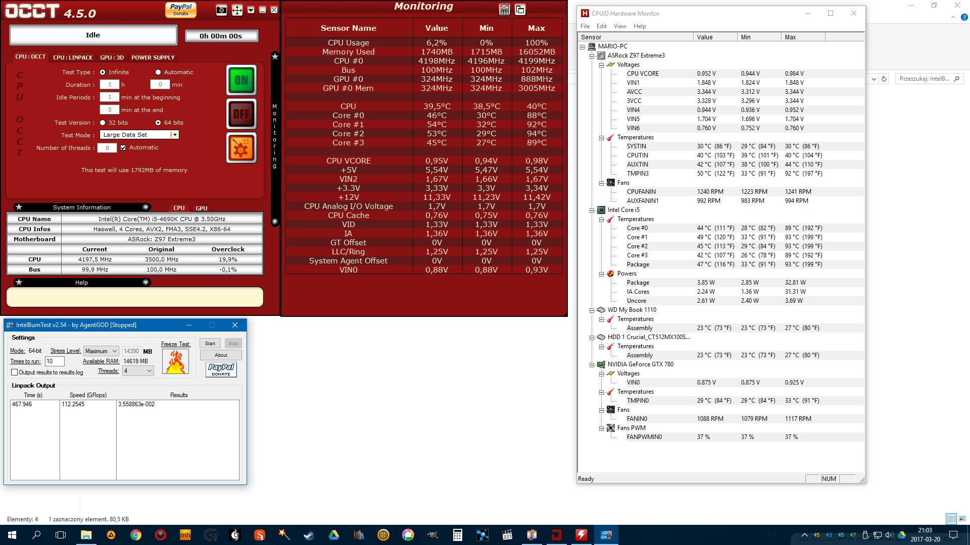

    Another All Core test: 43 and 94 ° C again, except that I changed the power of the fans from 5V to 12V (I accidentally switched yesterday when vacuuming). Stable of course, but temperatures .... !!

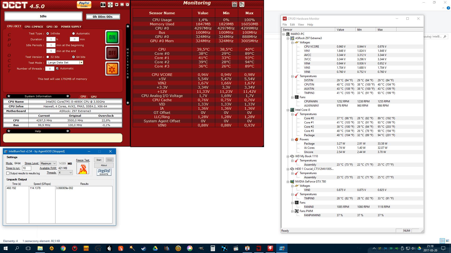

    Another test with All Core: 44 and ... 98 ° C

    Neither the OCCT nor the HWmonitor is reading the Vcore voltage correctly.
    Both show less than 1V. With this voltage, there is no question of such temperatures.
    Use HWinfo and not HWmonitor.
    https://www.hwinfo.com/
    If there will be a defeat, Intel XTU will be.
    Disables the colleague options such as Intel Speedstep, C1E, C3 / C6 states, Spread Spectrum.
    They make life difficult with third party liability insurance and can make the readings false.
    Judging by the fact that at only 1.2V it is stable 4.4GHz, I suspect that there is a significant increase in voltage under load. He will turn his colleague Vcore voltage additional offset to 0 and then check what is happening with the temperature. 1.275 + 0.05 = 1.325V. The only question is whether the album sticks to it.
    There may also be a question that simply 1.325V is too much for this cooling.

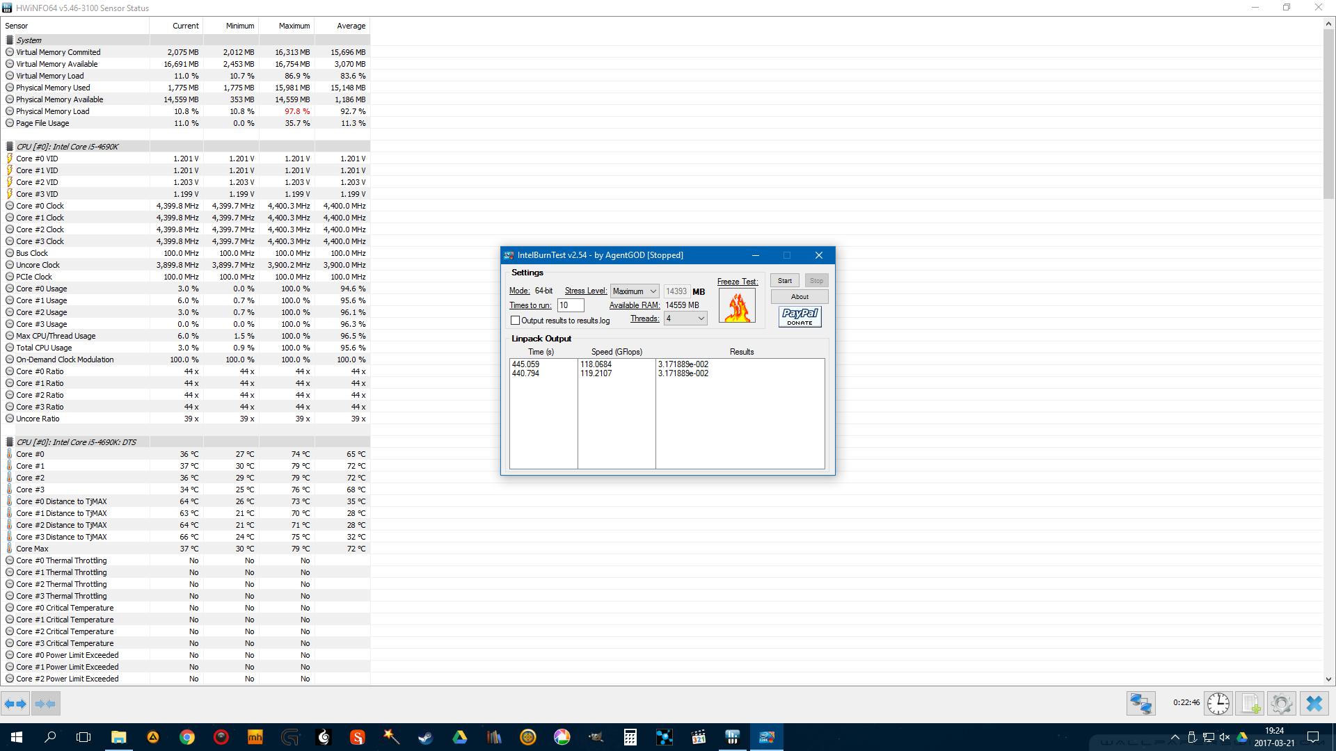

    Clocks all the time at 44. It is stable and the temperature is also OK.

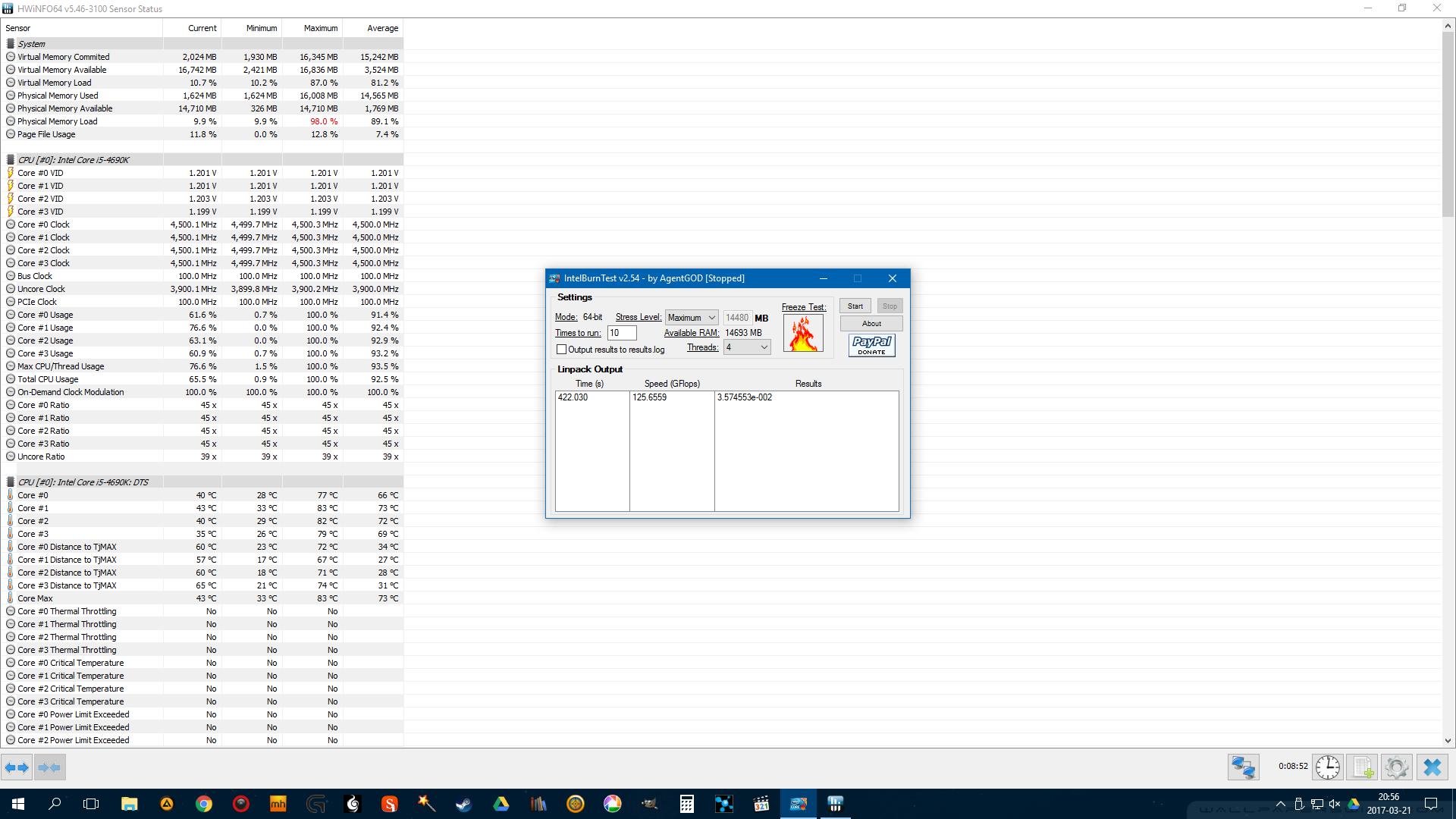

    Another test approx. 25 minutes. with the same settings with HWinfo enabled.
    Indeed 1.2V :) And what now?
    All the time 1.2V and clocks at 45. Still stable and only the temperatures jumped to 83 ° C (I do not know if it matters but I changed the RAM clock to 2400 because after restoring to factory settings it jumped back to 1333)

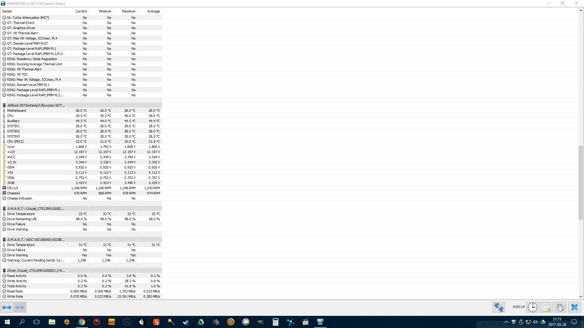

    Fixed Voltage was tested above 1.9V. After changing to 1.8V stability problem.
    Then Vcore Voltage Additional Offset set to 0.010, Vcore Override Voltage left 1.2V, and Fixed Voltage 1.8V and all during the test OK. this is how the computer went for a week and it was OK.
    No load:
    After the test:
