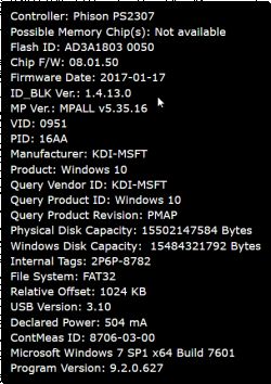

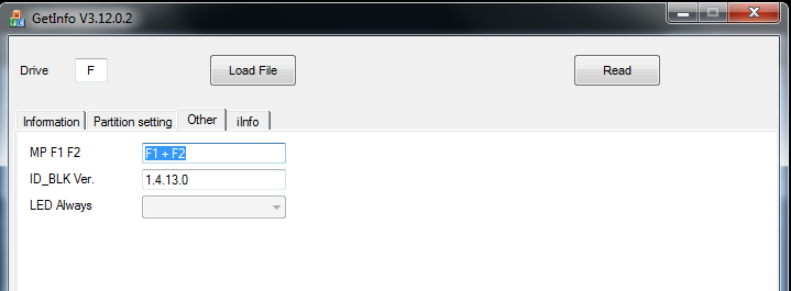

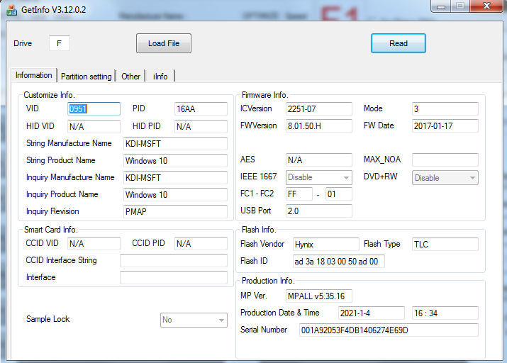

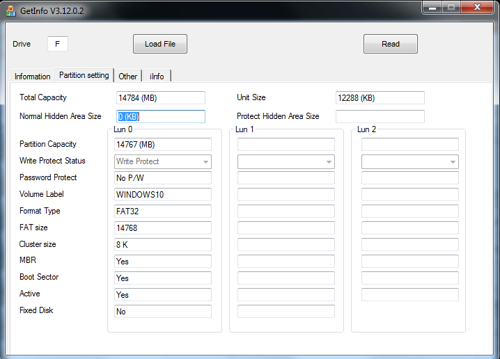

  • #13 18642872
    rubins
    pidar wrote:
    Let me remind you of your description from the first post:
    Talibanczyk wrote:
    The point is that The memory is write-protected and there is no "way" to format it ...
    And now the current state of this flash drive:
    Talibanczyk wrote:
    Only now, because "then" the pendrive stopped "living" after using the above-mentioned program - it is not seen in any device or system at all.
    "All is not lost" :wink: , read:
    https://www.elektroda.pl/rtvforum/topic3368722.html#16641618
    I suggest you try to use the following right away MPALL -and. :idea:
    Phison MPALL v3.72.0B mod by pidar
    https://www.elektroda.pl/rtvforum/topic3126783.html#15289707
    EDIT:
    Adds to the test, available recently on the Chinese website MPALL -> best if someone presented screen ( only "UPDATE" you choose! ) from detecting the memory from an efficient, identical medium, because then I will try to create the appropriate file .ini .
    As part of the refreshment of the topic, I am attaching screenshots of the detection of a functional carrier.
    • Formatting Original WIN 10 Flash Drive with Write-Protection: Methods & Alternatives Pen_W10_3.png (23.73 KB) You must be logged in to download this attachment.
    • Formatting Original WIN 10 Flash Drive with Write-Protection: Methods & Alternatives Pen_W10_2.png (42.98 KB) You must be logged in to download this attachment.
    • Formatting Original WIN 10 Flash Drive with Write-Protection: Methods & Alternatives Pen_W10_1.png (57.83 KB) You must be logged in to download this attachment.
  • #14 18643655
    pidar
    Posts: 11363
    Help: 1569
    Rate: 3590
    @rubins You want to unblock it :?:
    Example:
    Let's do it with the program from my attachment below. :idea:
    • PhisonWP v.0.0.zip (6.34 KB) You must be logged in to download this attachment.
  • #15 18653414
    rubins
    Unlock in the sense of remove write protection?
    Let's try, but the attached file crashes with an error, in the cmd window you can see '[Err002]' and question marks, because it's probably some Chinese stamps.
    Basically a dozen or so pieces were treated with version 3.23 of Phison Format & Restore, however, a few 'did not manage'.
    However, the recording on these media treated with the above-mentioned soft is ... the Vistula will dry faster; (
  • #16 18654781

  • #17 18655182
    rubins
    pidar wrote:
    rubins wrote:
    Let's try except that the attached file crashes with an error in the cmd window you can see '[Err002]' and question marks, because it's probably some Chinese stamps.
    It was you ineptly trying, I wrote let's do and gave an example of "convalescent" :lol: .
    After you wrote
    Realized to check this inserted attachment, so I wrote an error. I must have misunderstood.
    pidar wrote:
    rubins wrote:
    Basically, a dozen or so pieces were treated with the 3.23 Phison Format & Restore version, ... However, saving to these media treated with the above-mentioned soft was ...
    You will show us some example after such "repair" :?:
    https://www.antspec.com/usbflashinfo/index.php
    Of course, go ahead:
