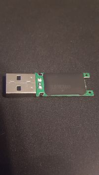

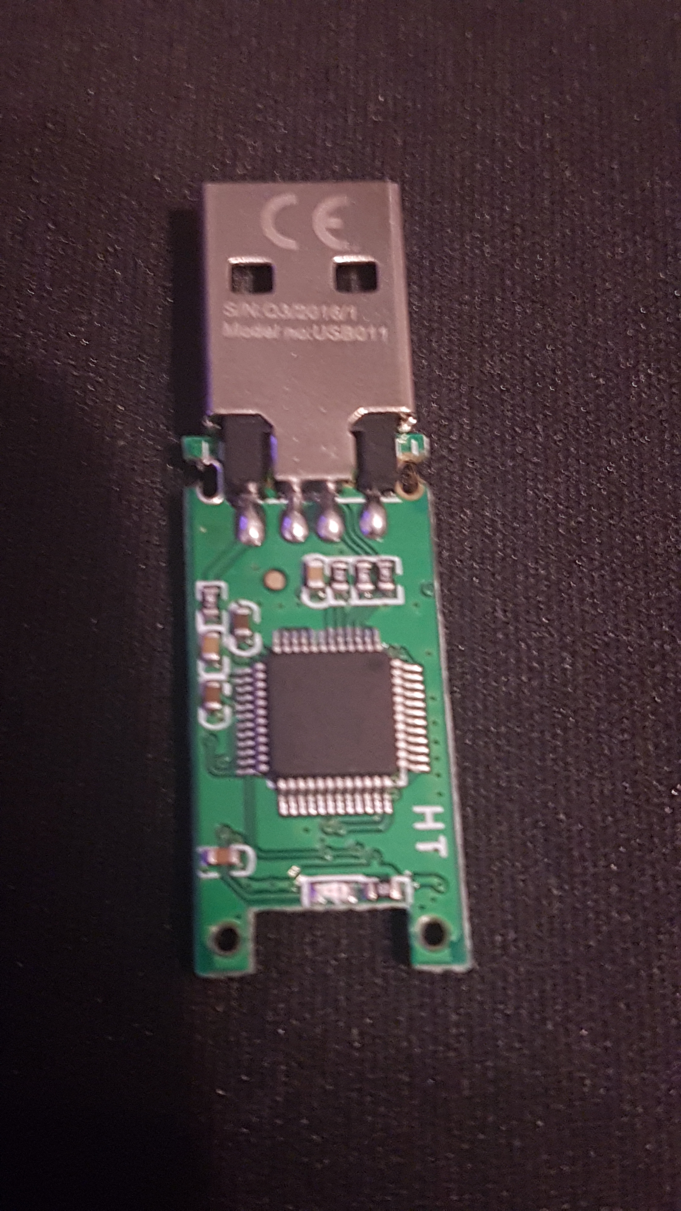

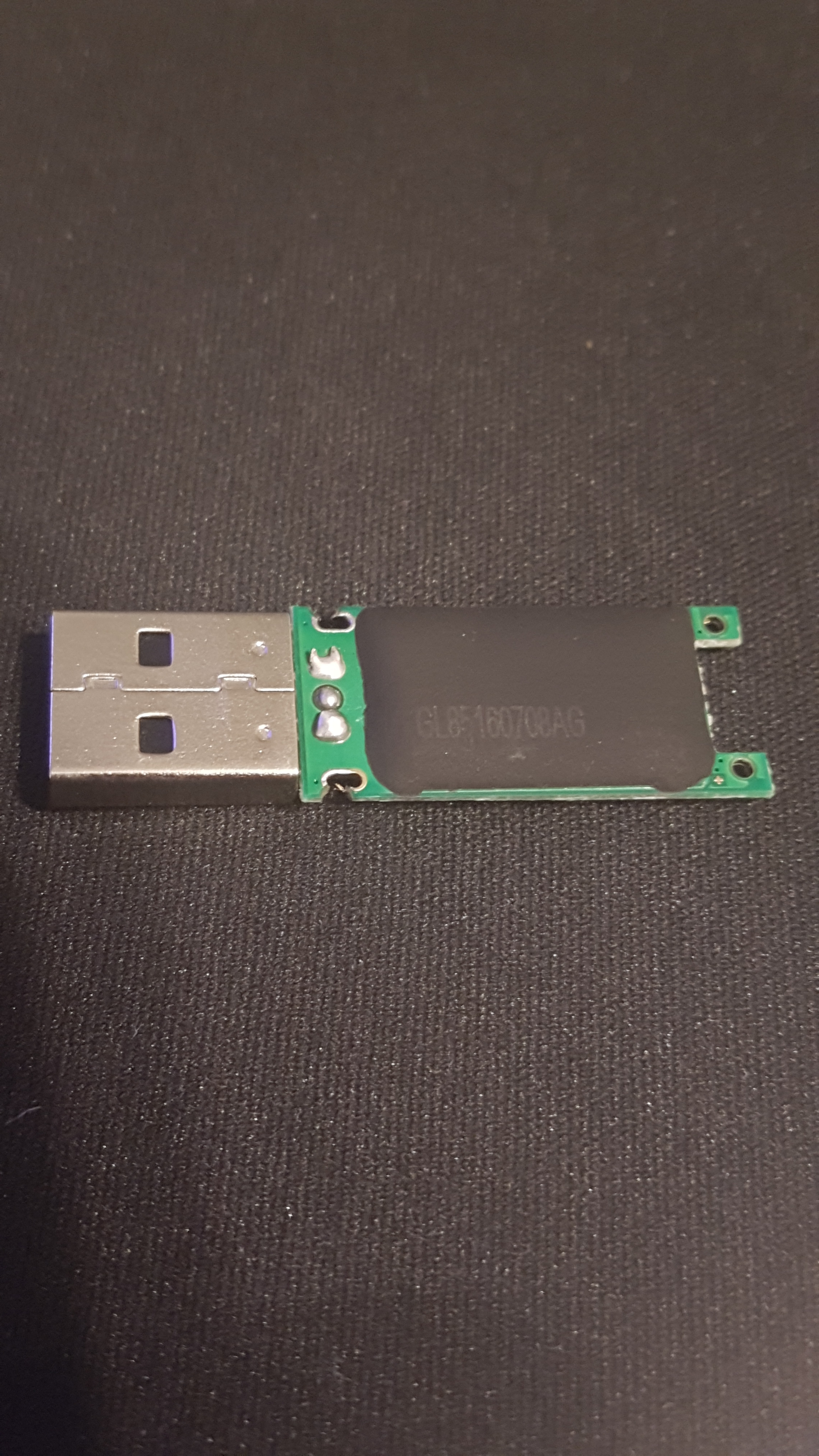

    Take the flash drive apart and post a clear photo of its electronics from both sides. Enter the designations of integrated circuits located in the pendrive - this will allow you to choose a specific tool for this memory.
    Regards
  • #3 16797140
    patryk9911
    Pendrive Write-Protected: Can't Format, Tried Various Soft Files - Seeking Solutions Pendrive Write-Protected: Can't Format, Tried Various Soft Files - Seeking Solutions
    GL85160708AG

    Unfortunately, this "more important" integrated circuit does not show (no?) Markings.

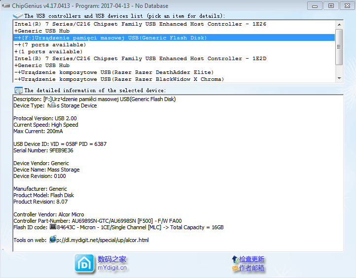

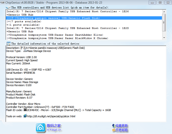

    Check the pendrive with the latest version of ChipGenius from the link: https://www.elektroda.pl/rtvforum/topic3332669.html#16426344
    Maybe this version will give us more information about the memory controller.
    Regards
  • #5 16797261
    patryk99111
    This is how it looks from the new version

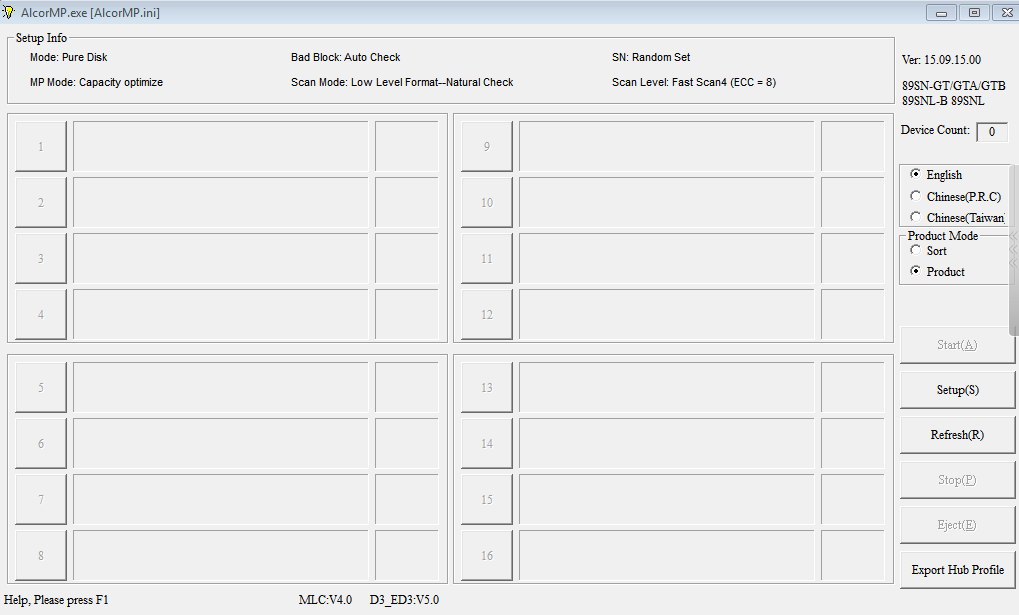

    patryk9911 wrote:
    I have tried several soft touches but none detect my flash drive
    What software (and in what versions) did you use to save the flash drive? Provide their name on the Forum so that you don't advise on something you've already tried.
    Run AlcorMP from the attachment (press OK when starting) and upload a screenshot of the program in the Forum. Do not use any options except Refresh.
    Regards
    • ALCOR_MP_v15.09.15.00.rar (5.57 MB) You must be logged in to download this attachment.
  • #7 16797299
    patryk99111
    I think I downloaded the first 5 versions of AlcorMP from one of the viruses :(
