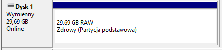

    I have 2 pendrives that I have not connected for a long time, but they always worked.
    Today I connect both and neither works. I can't even format them. Can't Format Two Old Pendrives on Windows 10 Pro 64 - Disk Management & Connectivity Issues Can't Format Two Old Pendrives on Windows 10 Pro 64 - Disk Management & Connectivity Issues
    My system: Windows 10 pro 64.
    The second is only visible in disk management.
  • #2 17249614
    Pedros050
    Posts: 17914
    Help: 2471
    Rate: 3926
    Hello. In disk management, create a FAT32 partition and then format it.

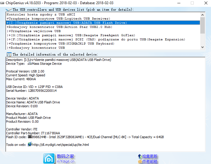

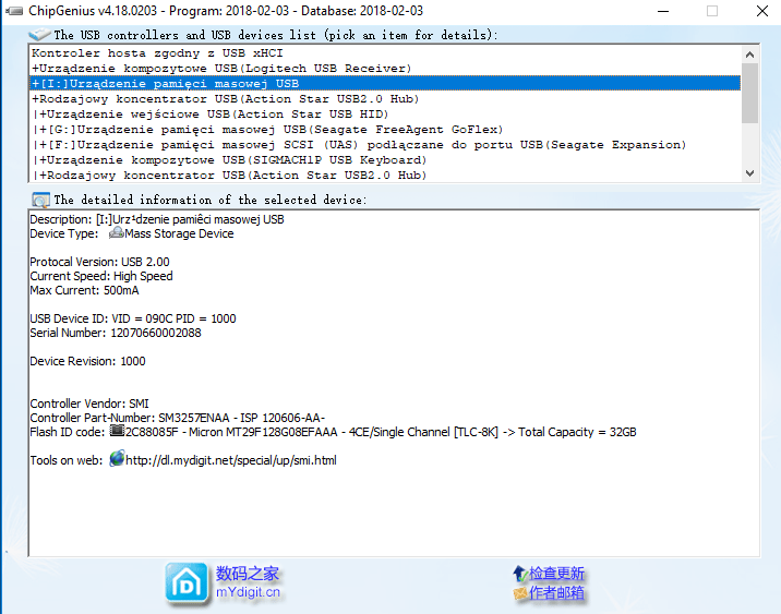

  • #5 17249734
    wertiko7
    Posts: 606
    Rate: 100
    It didn't help.
    Added after 7 [minutes]:
    Screenshots from chipgenius.
  • #6 17249827
    pidar
    Posts: 11363
    Help: 1569
    Rate: 3590
    We start with the bigger one (64GB):
    1.http: //www.adata.com/pl/ss/usbdiy/
    or ( if the manufacturer's soft fails )
    2.https://www.elektroda.pl/rtvforum/topic2174989.html#10319290

  • #8 17250313
    pidar
    Posts: 11363
    Help: 1569
    Rate: 3590
    I am adding a solution (attachment) for the second (32GB) -> there will be a change from ISP 120606-AA- on ISP 130430-AA- . :idea:
    Before and after using repair software, please add info ( Spoiler ) With Flash Drive Information Extractor .
    https://www.elektroda.pl/rtvforum/topic3432434.html#17042556
    • SMI MPTool v2.5.18 v1 M0503 SM3257ENAA.zip (6.22 MB) You must be logged in to download this attachment.

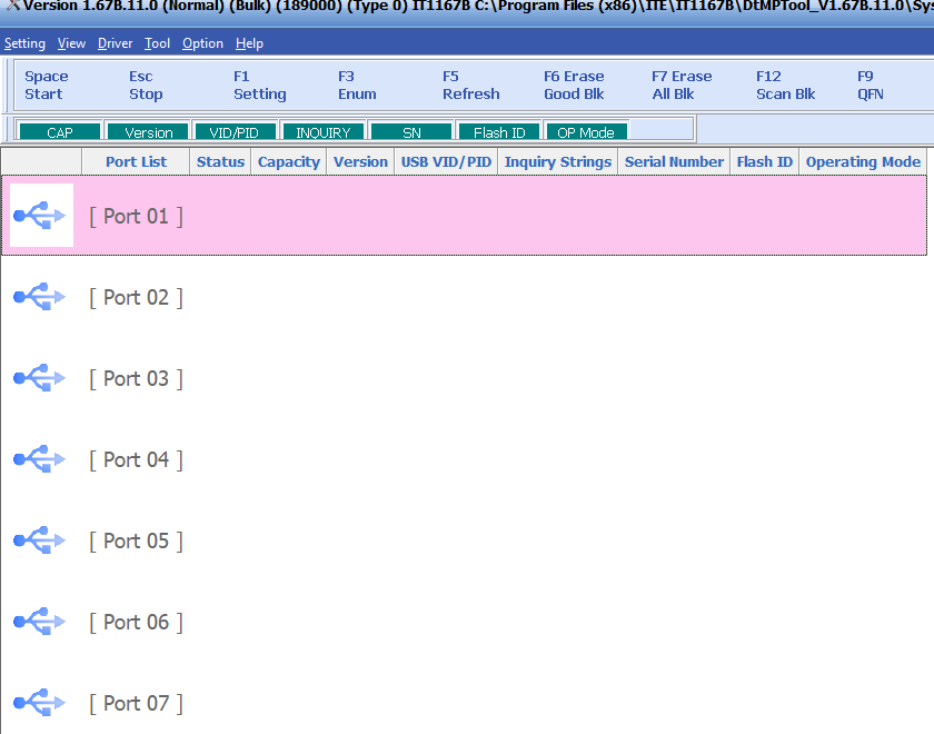

    • IT1167B DtMPTool v1.67B.11.00 UT167B IT1167B.zip (3.46 MB) You must be logged in to download this attachment.
  • #11 17251190
    wertiko7
    Posts: 606
    Rate: 100
    Yes it's ADATA C008 64GB.
    Added after 3 [minutes]:
    I ran this program and what to do next.

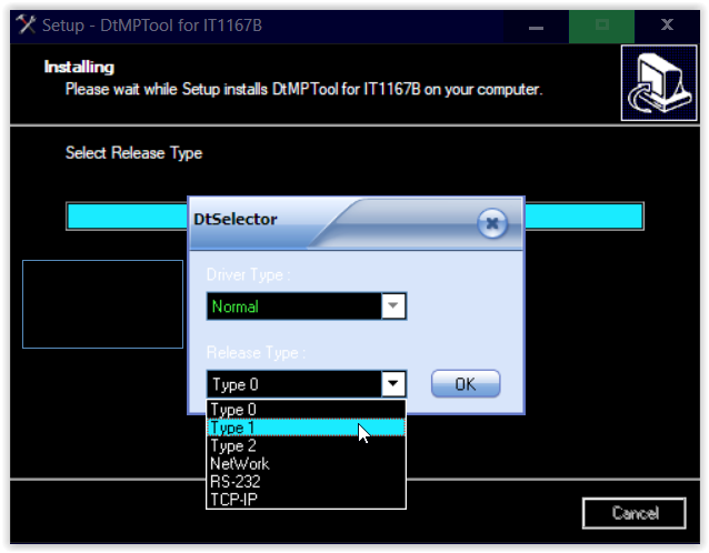

    Type 1 selected :?:

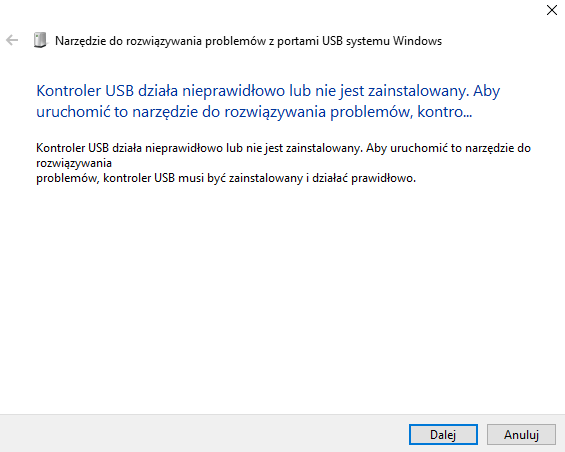

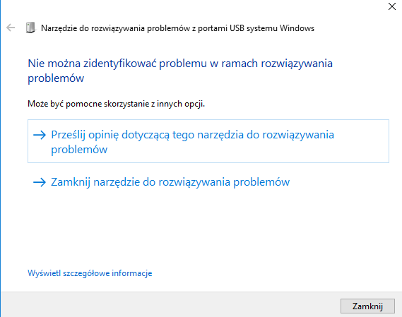

    wertiko7
    Posts: 606
    Rate: 100
    Something that Windows tool has detected but cannot fix.

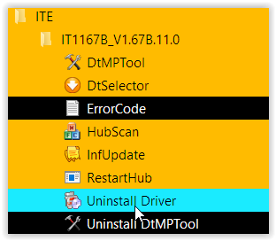

  • #19 17251488
    wertiko7
    Posts: 606
    Rate: 100
    I uninstalled it in the device manager, what soft should I turn on now?

    pidar wrote:
    Plug this 32GB flash drive into the USB port where it was repaired. Add a screenshot after starting USB Device Tree Viewer.
    We have not understood each other, there is a problem with the drivers for USB controllers on this computer and this must be solved first.

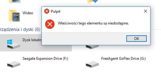

    By running all these programs, you now cannot see how much space the disk is taking up.
    I merged the posts.
    Please, when adding information, when no one has posted an answer yet, use the "change" button, without publishing the post under the post.
    RADU23
    And when I click ppm on the disk and select properties, this message pops up:

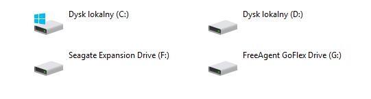

    You know how to fix it so that you can see how much space a given disk takes up on my computer, i.e. so that the disk's bar is visible.
    As in the picture above, you can only see the names of the drives.
  • #25 17264010
    Pedros050
    Posts: 17914
    Help: 2471
    Rate: 3926
    You will check the disk properties as Administrator.
