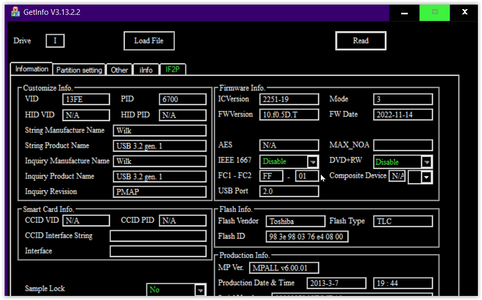

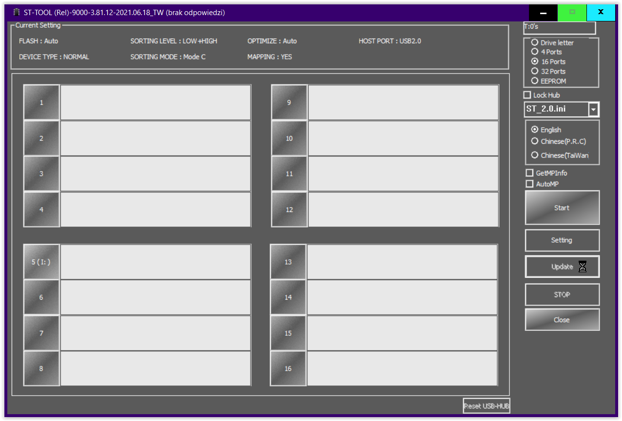

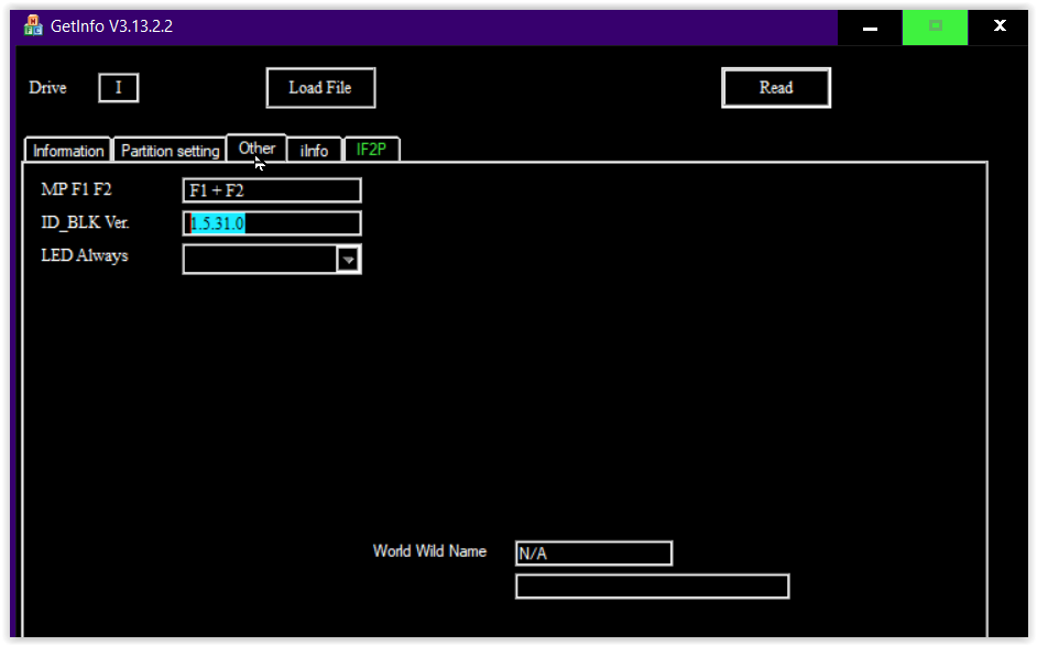

  • #14 21387970
    pidar
    Posts: 11363
    Help: 1569
    Rate: 3590
    I see it poorly. Repairs unrealistic.
    Example:
    Screenshot of GetInfo V3.13.2.2 software with the Other tab open and various options. .
    Screenshot of the GetInfo V3.13.2.2 software window with various technical information. .
    Screenshot of the ST-TOOL interface showing various settings and USB port configuration options. .

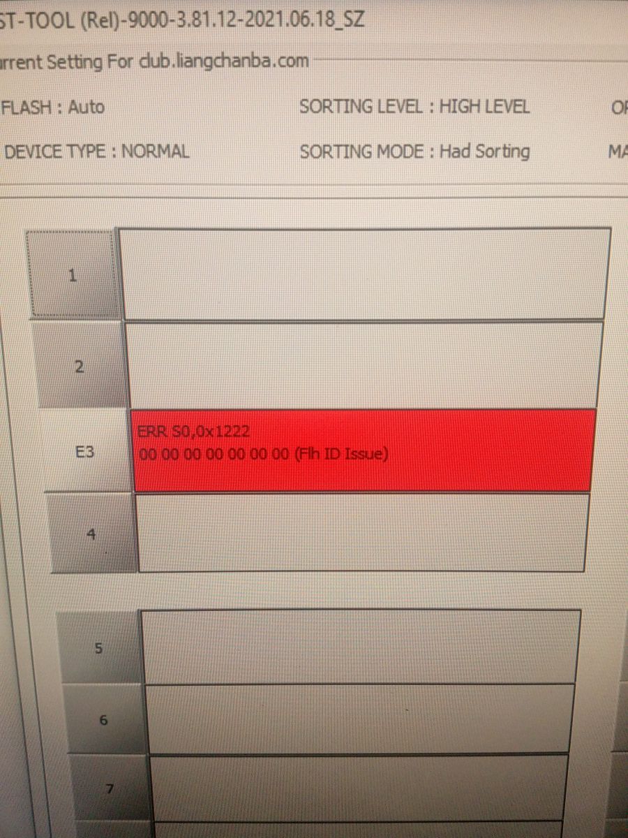

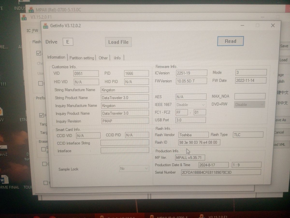

  • #15 21388094
    kixlood
    Posts: 11
    >>21387227 >>21387227 I tried but I don't know how to use it very well, when I try to flash it I get (err s0.0x1212) I don't know if it's because I need to configure it well.
    >>21387424 If it lets me select the disk, I get the error I mentioned.
    Added after 13 [minutes]:
    >>21387970 I'll try
    Added after 1 [hours] 8 [minutes]:
    >>21387970 What do I do after getinfo?
    Added after 2 [hours] 37 [minutes]:
    >>21387227
    Screenshot of device configuration software showing error ERR S0.0x1222.
    Added after 24 [minutes]:
    >>21387227
    Screenshot of device configuration software showing error ERR S0.0x1222. >>21387970
    Screenshot from GetInfo V3.12.0.2 tool showing USB Kingston DataTraveler 3.0 device information.

    kixlood wrote:
    That is, I just enter the information in getinfo,
    You don't enter anything there.
    kixlood wrote:
    And another question, do you know why I get this error in red?
    I don't know what this error means. Maybe someone else knows the answer?
