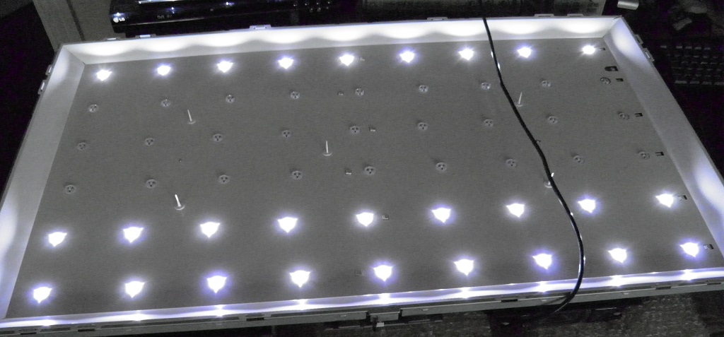

    The photo explains everything, there is something under the matrix and not everything shines:

    If you are sure that the strips are damaged, look for functional strips after the markings that are printed on them.

    Only that the author of the topic wrote that it is completely green, so if you start repairing the backlight, the TV may end up on the scratch, and at best on Allegro among the damaged ones. I would advise the service.

    Since he managed to disassemble the matrix without damaging it (glass), he should be able to replace the strips, I think. :)

    Miechu, show me where the author wrote that he dismantled the matrix? Somehow I can't see. But maybe I don't know about something?

    Photo in post # 5.
    Edit:
    Oh, yeah. Only now did I notice that the photo is not the author of the topic.
    In that case, I agree with you - the only reasonable option is to put the TV on service.
