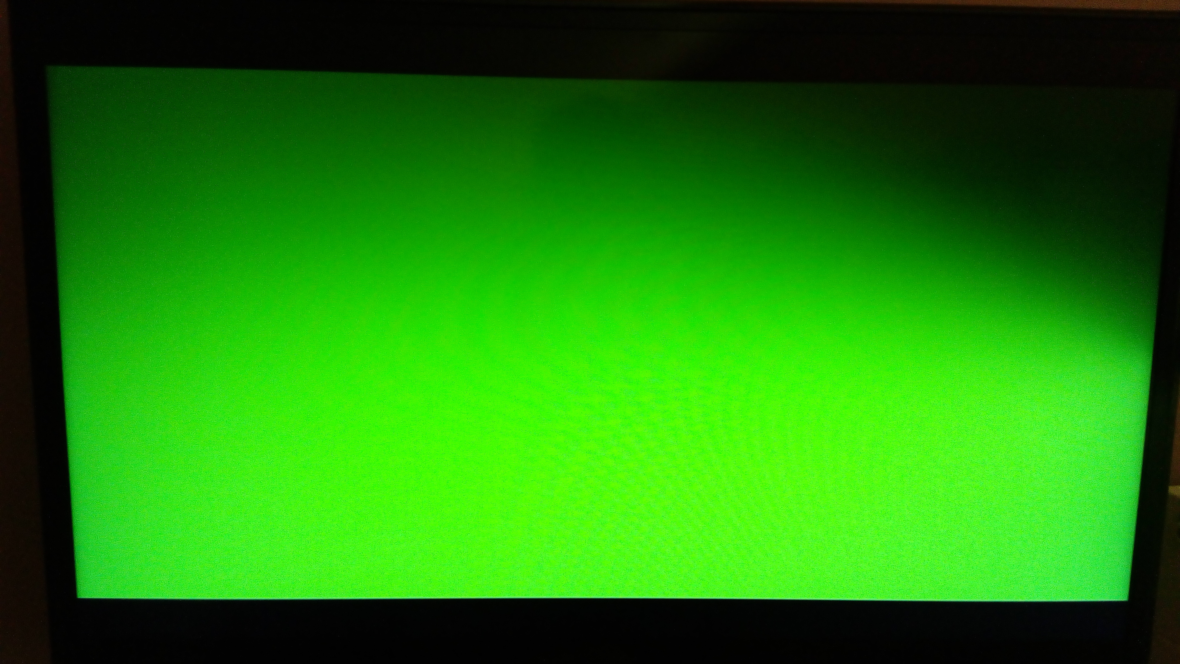

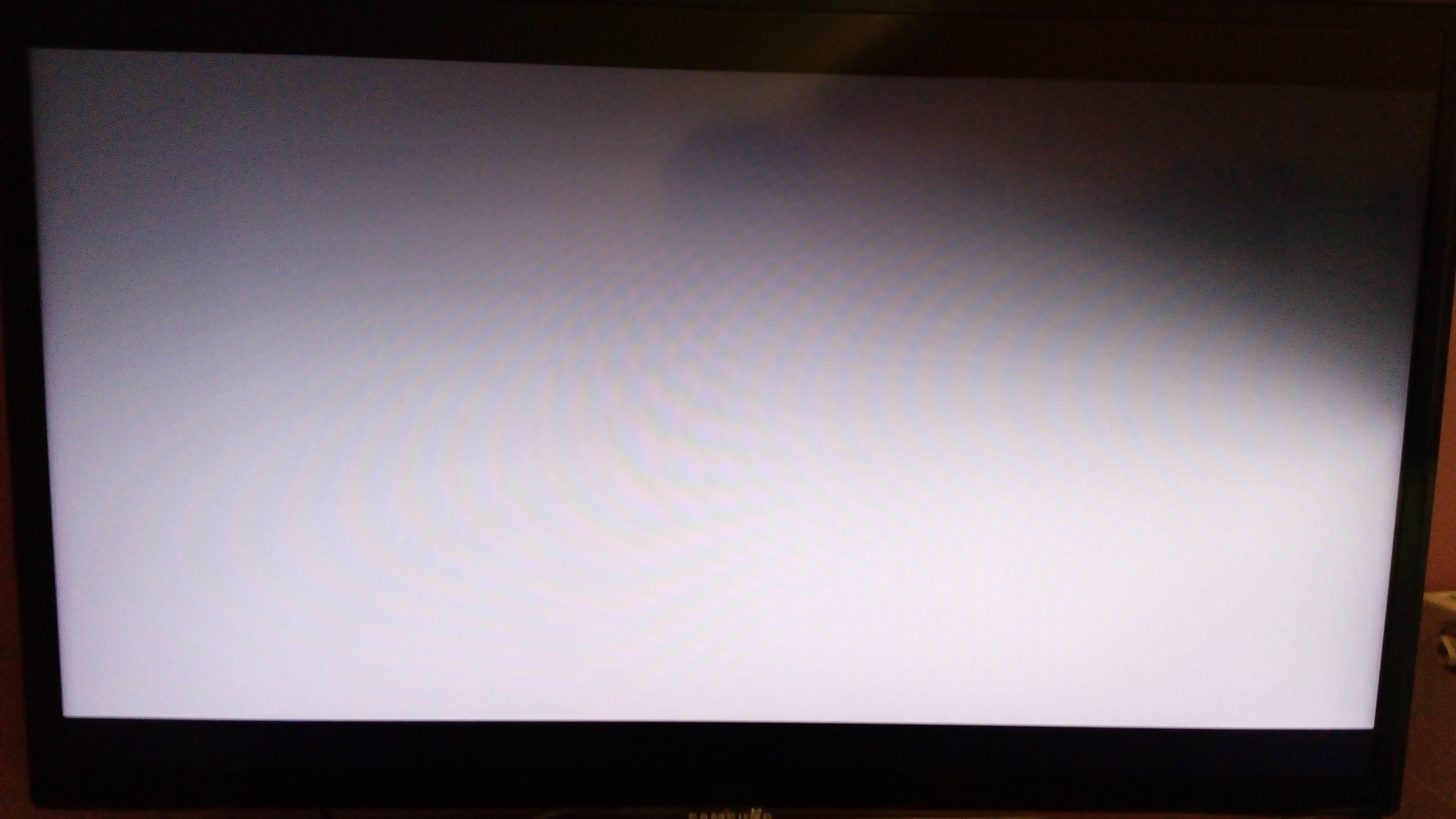

    Samsung UE32ES6340S - Image darker at the top and top right of the screen Samsung UE32ES6340S - Image darker at the top and top right of the screen Samsung UE32ES6340S - Image darker at the top and top right of the screen Samsung UE32ES6340S - Image darker at the top and top right of the screen Samsung UE32ES6340S - Image darker at the top and top right of the screen
    What can I do with this?
    Is it the fault of the lower backlight in these places?
    Could the backlight LEDs peel off and move away from the screen?
    Of course, it's partly the phone's fault, but it's about the sense of the problem.
    Fix.
    You ask such obvious questions that I dare say that you will not do it yourself.
    Return the equipment for servicing, there they will replace / repair the matrix backlight.

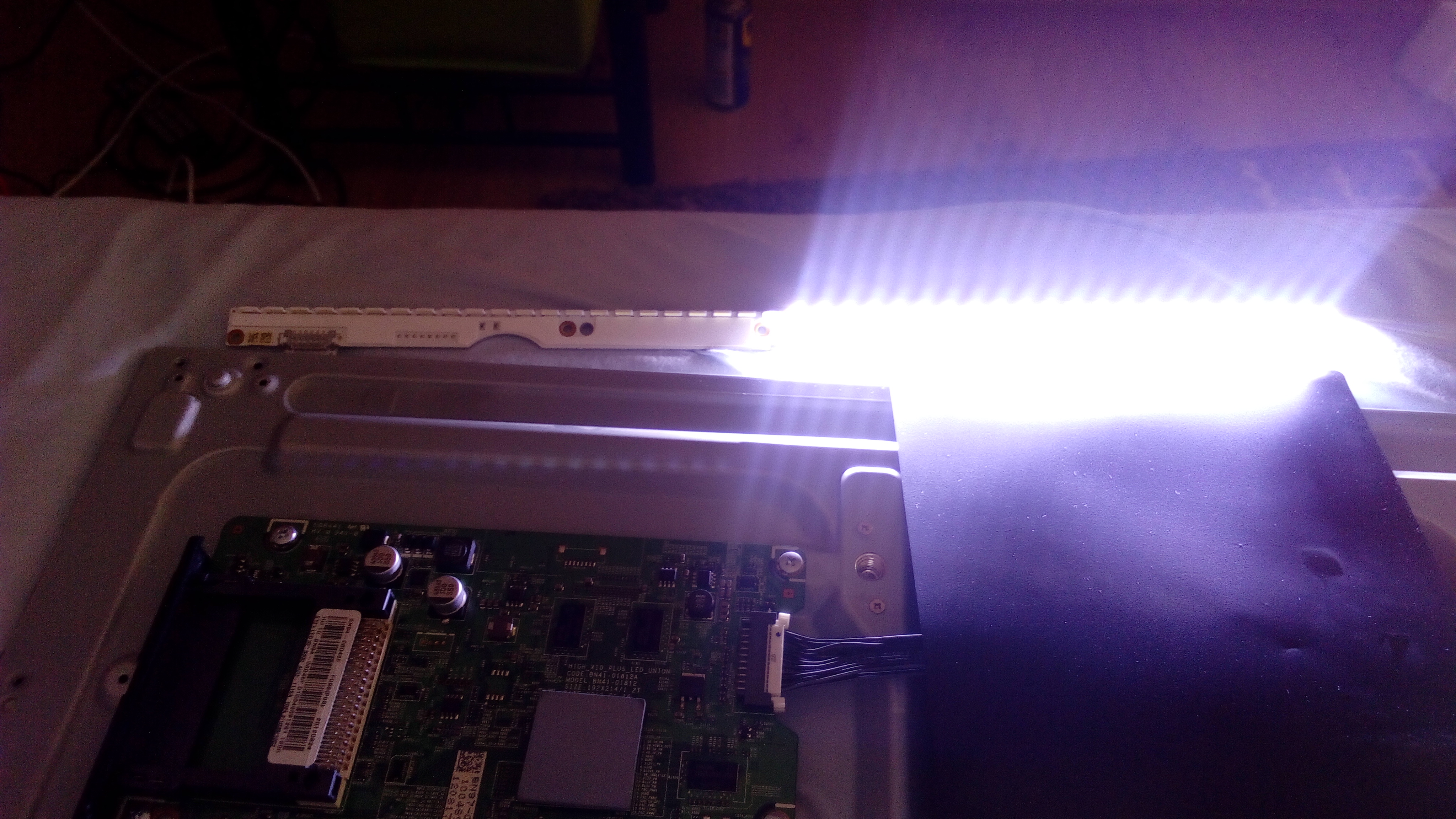

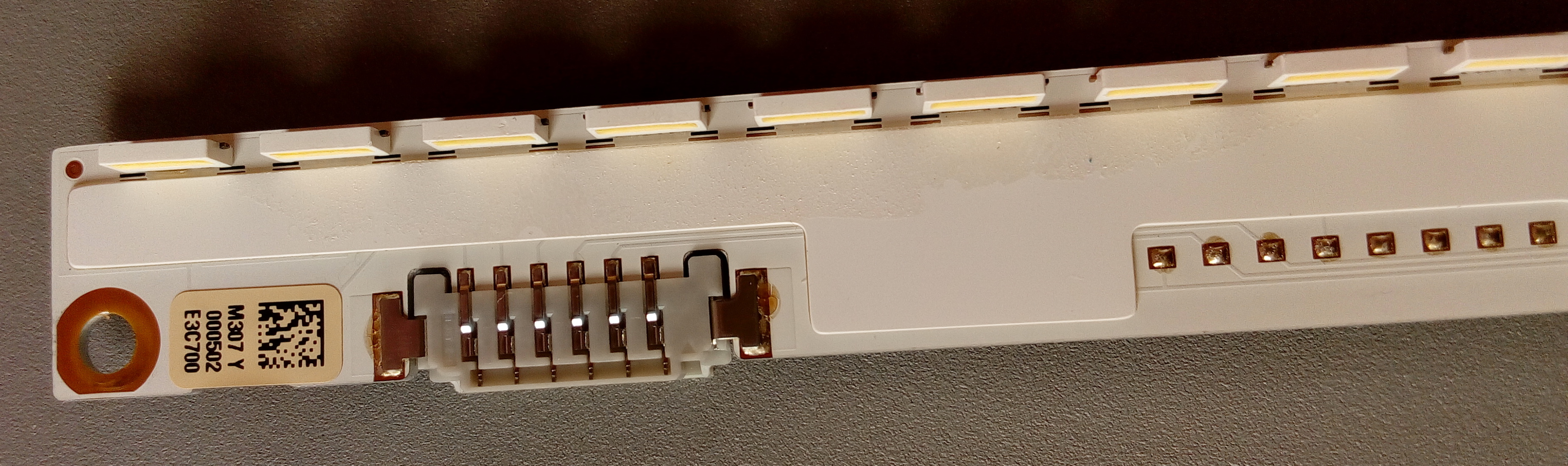

    #6 16513171
    Robin_Otzi
    Posts: 110
    Rate: 18
    I turned up the TV and it turned out that it has a side lighting strip!
    And only the bottom half is lit. :) that is, the upper right side has little light!
    Google doesn't find anything after the sticker codes.
    I do not know where I can get such a strip, or how to check with a meter, although there is no access to the paths!
    m307 y 000502 E3C700
  • #7 16513352
    krakarak

    If you gently scrape or puncture well through the varnish, access to the paths is provided.
    Maybe only one diode got breaks, so you will buy and replace.

    Added after 1 [hours] 53 [minutes]:
    it shines like that

    When the LEDs shine, I know. You check how this non-illuminating part of the strip is connected to the socket.
    And either it has a separate power supply, which was missing or the power supply is on and one of the diodes has a break. You can easily break through the varnish and measure.

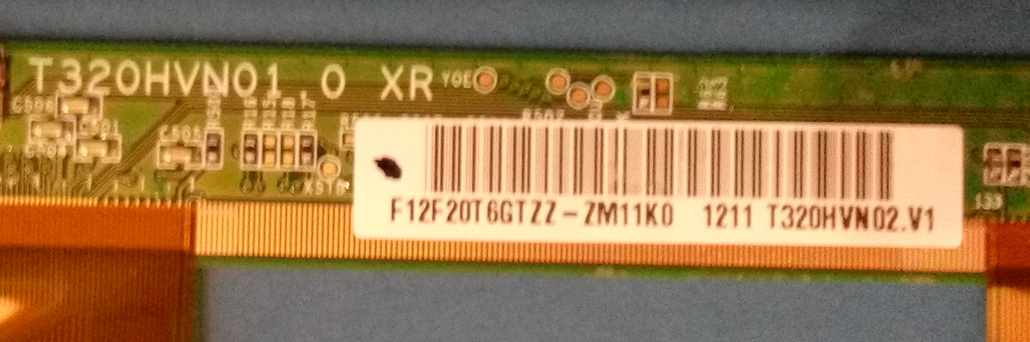

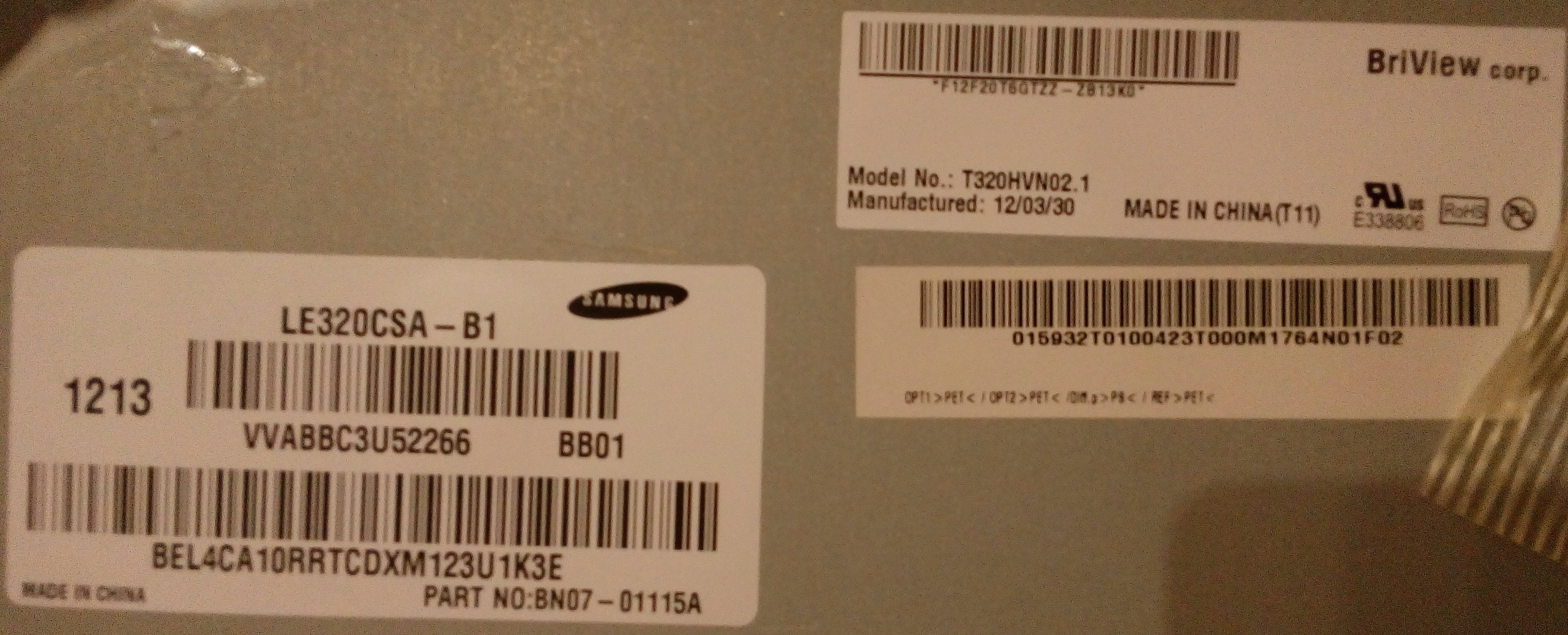

    The only stickers are:
    Added after 59 [seconds]:
    and from the screen connector itself:

    #15 16515433
    krakarak
    Level 42  
    Posts: 8867
    Help: 681
    Rate: 1846
    You can search for the strip by ads on stock exchanges, Allegro, OLX or computer services. You can also post an offer to repair it.
    The matrix name is in the picture, the sticker on the left - LE320CSA-B1, BN07-01115A - you can buy a new one.
