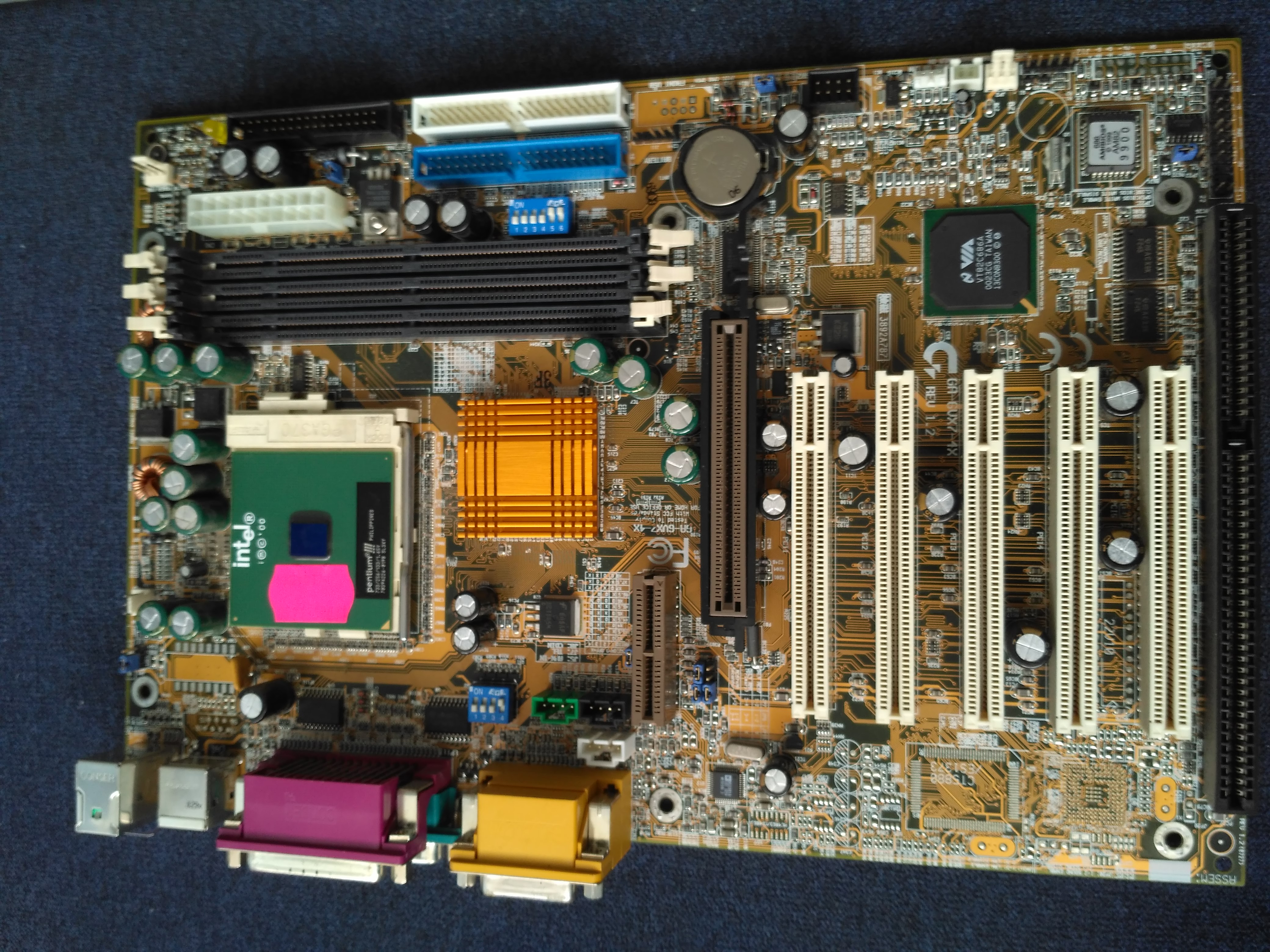

    In my dad's old computer, I took out the batteries from the BIOS for about 1 minute. The computer has been out of power for several years. Dad says "damn it hit" and that it required a BIOS. I am attaching a photo of the disc, I don't know the model. I am asking for help what happened and how to fix it!
    • Replacing BIOS Battery in Old Computer: Identify Model, Fix Issues, and Photo Attached 1488718954839..jpg (2.2 MB) You must be logged in to download this attachment.

    The battery is CR2032:
    http://bratex.org/sklep/pl/p/Bateria-panasonic-2032/2719?gclid=CNnK3P62v9ICFVVJGQodVPsEhQ
    Take out the battery and see if the disc works, a battery is not necessary for this purpose.
    Describe the type of malfunction in more detail.
    What happens after switching on?
    Post a photo of the interior after folding the computer so that you can see if everything is ok connected.

    dajmoFT wrote:
    Did these actions really remove the BIOS?
    No way. This battery has nothing to do with the BIOS. Powers real-time generator and maintains CMOS memory.

    This is an old disc and it may happen that you need to set something in the BIOS.
    Removing the battery caused that you lost your saved settings, and the default may not want to move.
    We still don't know how it manifests itself as "sprinkling".
    Is the board booting enough to enter the BIOS options?
