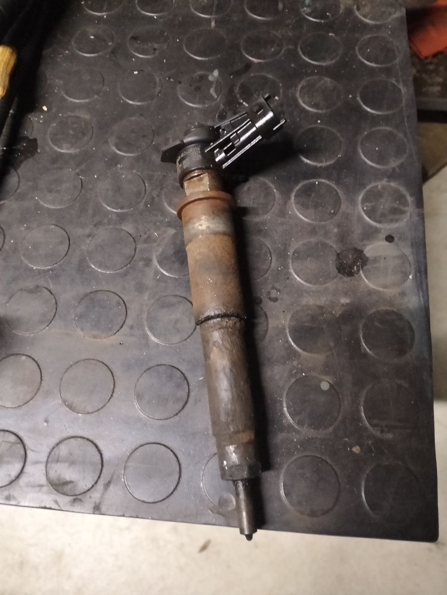

    #17 21744067
    panrys87
    Posts: 83
    Rate: 36
    Hi, I will refresh the topic as I have a problem with my Trafic 2.0 dCi 2009. Namely, I took out the injector to give it a check as it was showing an ignition miss error on the 4th cylinder, the injector turned out to be working but was probably poorly tightened (looked like it had been recently reconditioned). I put everything together, fired it up and it died after about 3 secs and no more firing up. I pumped with the pumping nozzle for somewhere around half an hour and nothing, fuel filter changed about 2 weeks ago. I read the camshaft position sensor error on the computer, but this error was there from the very beginning after purchase.
    I checked the pressure with the computer and it shows "Ramp fuel pressure 0 bar" could this be the reason that it is vented and there is no pressure? How to bleed it then , because pumping with a pear doesn't do anything?

    What injector number do you have there 0445115007? They sit electrically. Just as a quick note, measure the coil resistance.
  • Misidentified injector caused cylinder 4 misfire
    #23 21745195
    panrys87
    Posts: 83
    Rate: 36
    The injector was checked at the factory where they remanufacture injectors. All the parameters came out green. Unfortunately I cannot remember the number. Still, there is an error of misfire on the 4th cylinder and the engine does not work as it should, so I guess the controller should be replaced, especially as there is a sticker of some service centre on it, so there must have been some problems with it before and someone must have done something to it.
    Added after 1 [hour] 2 [minutes]:
    Well, I think I have the cause. It turned out that I had mis-tracked the injector. Based on information from the internet I identified the 4th injector as the one on the timing side and that was a mistake because the 4th in this engine is on the gearbox side . Now to somehow get it out and to the workshop with it.

    panrys87 wrote:
    Now somehow get it out and into the workshop with it.
    Good luck with the removal. With the injector you want to go to the workshop? There's no point in doing so.
  • #25 21745436
    panrys87
    Posts: 83
    Rate: 36
    I've filled it with paraffin and let it sit until Monday, then on Monday I'll borrow a stripper and try it out, maybe it will work.
    I'll take it back, maybe they can recondition it, and if not, they have one in the workshop, if you need it, you can buy it right away.

    You have to be of good mind😀 I carved the pulling tool myself , and after a whole day managed to move it somehow from 5 mm upwards. I bought an inertia hammer beforehand, but you could knock with it for a month and it wouldn't move.
  • #28 21748368

    panrys87 wrote:
    and after a full day managed to move it somehow from 5mm up
    Ehe. And what next ????
  • #29 21748433

    Well, there's a success story 😀Worn fuel injector lying on a black rubber workshop mat
  • #30 21748479
    genek1000
    Level 35  
    Posts: 2294
    Help: 290
    Rate: 1058
    Well and beautifully . 👍
    A piece of decent work done that nobody needs . 😀
    For the time you spent making a jig and pulling the injector out + buying an inertia hammer I would do what I know how to do and make money , to give the injector a pull .
    Well unless you like challenges and fun 😉 .
    Everyone does what they think 👍
