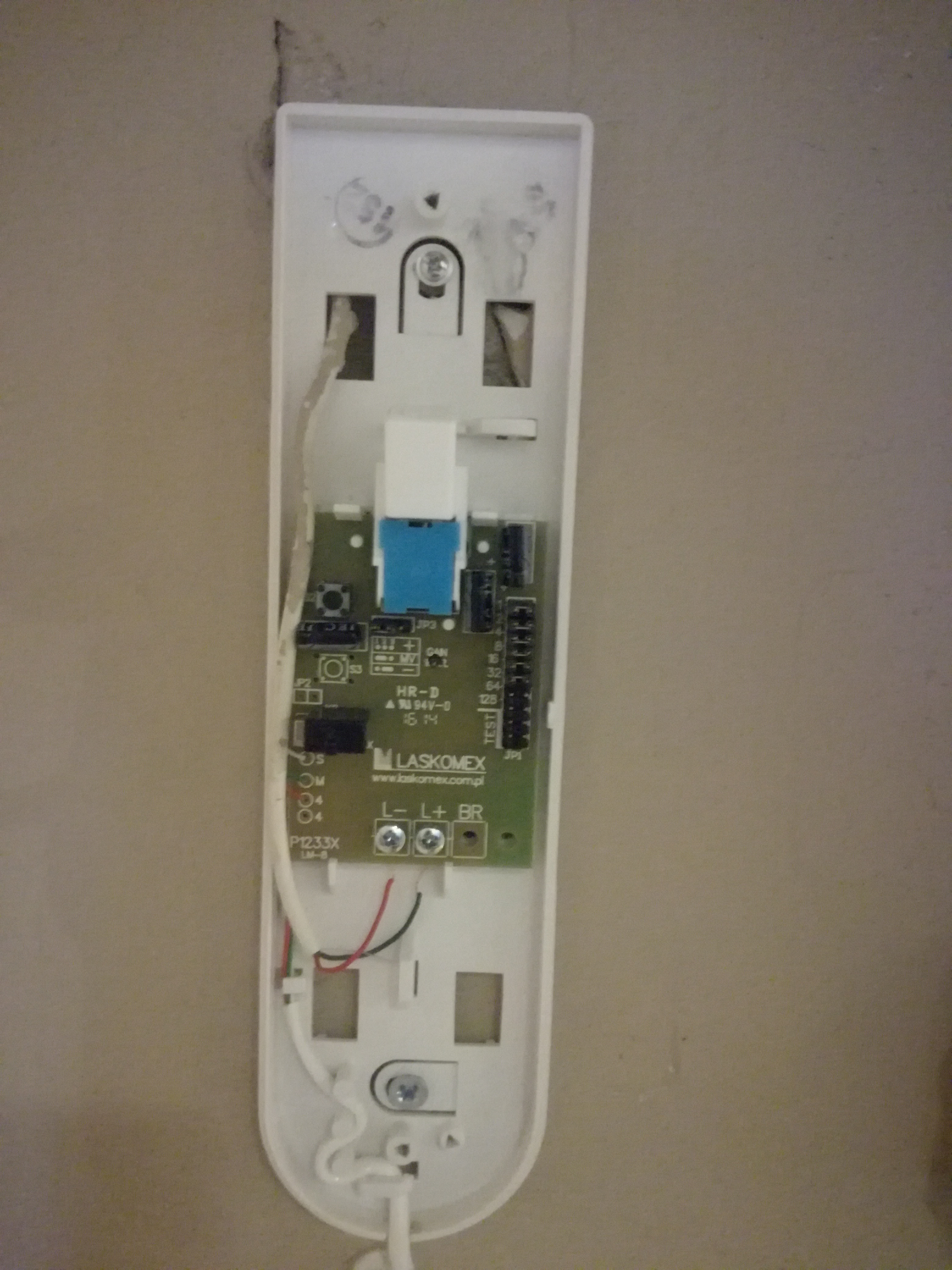

    Good day.
    The problem is as follows.
    I have an intercom at home, the principle of which is that when someone enters a code, this beeps, then I know that someone is coming. The problem is that I replaced the intercom and now it beeps every time anyone types the code to themselves. that is, it does not have to enter the correct mine, only any one that opens the door. In a word, the neighbor enters the house, I can hear it .. can I do something about it, is this equipment for replacement ??
    Thanks in advance for the tips.

  • #8 16331709
    krazzinsky
    Posts: 6
    okay i bought one allegedly compatible with aco.
    but something still does not work .... I do not know what else I can do .. LASKOMEX LM-8 / W-6 now such a handset.
    the red wire is connected to L +, and the blue wire to L-. I tried the other way around and it doesn't work

  • #10 16331772
    krazzinsky
    Posts: 6
    voltage on the line and polarity is ok, but I am interested in these jumpers .. they are inserted in 1,2,4,8,16,32,64 (such values are given with them) Intercom Beeps for Every Code Entry, Not Just Mine: Equipment Replacement? ... there are still places for jumpers at 128 and 3 places for test.

    Ircys
    Intercoms specialist
    Posts: 6969
    Help: 1342
    Rate: 2085
    krazzinsky wrote:
    I'm interested in these jumpers .. they are inserted in 1,2,4,8,16,32,64 (such values are given next to them) there are still places for jumpers at 128 and 3 places for the test.
    And here's the problem. The jumpers address the uniphone (they indicate the number at which it is to be activated). The sum of the jumpers is supposed to give the apartment number, so e.g. for apartment number 20 we only assume (!)

  • #16 16331912
    krazzinsky
    Posts: 6
    it works!!! the jumpers solved the matter !! :) thank you!!
