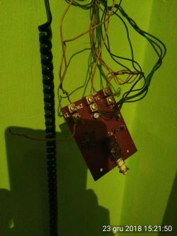

    A typical big city skyscraper, I am replacing the old handset in my apartment with a new one, however I do not mess with the order of the wires, it is still bad, as if something started to open, but I cannot hear me downstairs at the entrance to the block, or I cannot hear the speaker from outside the block.
    I extended the old cables using an internet twisted pair, so the colors have nothing to do with the original ones, perhaps arranged to some standard.
    I don't know the old model, but I took some pics:
    Replacement of the intercom in the apartment - in a high-rise building Replacement of the intercom in the apartment - in a high-rise building Replacement of the intercom in the apartment - in a high-rise building
    I want to replace this handset with a Cyfral Smart-5p and I'm looking for an expert's answer, which cable from the old contact to the new one.
    Do I have to put any existing jumpers inside?
    Photo of the new: Replacement of the intercom in the apartment - in a high-rise building
    Thank you in advance.

    The old uniphone is Urmet 1131. 5-wire installation. You have in turn:
    1 - handset (white and orange) for SPK
    CA - call (white and blue) to the RING
    2 - microphone (green) on MIC
    6 - ground (white) to WEIGHT
    10 - was not connected
    9 - lock (white and brown) on SW1
    As for the jumpers, the ZW3 is to be on, the rest are to be removed.

    Buddy @zybex you are great!
    I connected everything according to your description and everything works!
    This was the description I needed.
    Thank you very much :)
    I just don't know what the zw3 jumper is for, it works with and without it.

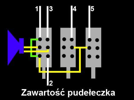

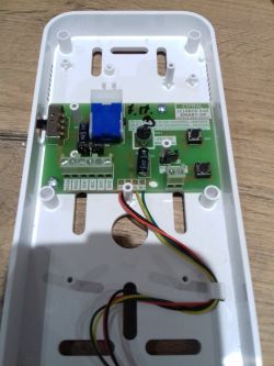

    I have another intercom to exchange for an identical Digit, but here I am asking you to understand what I mean:
    - also a multi-storey block of flats, an apartment ...
    ... the primitive old intercom was the first one, when they became popular, there were in each apartment small boxes on the wall with one loudspeaker and three buttons below, the buttons are a typical isostat where:
    - the first key (as the switch does not bounce by itself), as if it were picking up the intercom, made us hear the guest in front of the staircase, until we turn it off, we could hear sounds from outside;
    - press the second button to speak, let go to hear;
    - the third button is an electro-catch.
    There are 5 wires to the box in the apartment.
    I combined with an identical Cyfral Smart 5P, I got the sound from the outside, I can even hear singing birds very well, I hit the cord of the abutment, because I can hear it buzzing when pressed, the handset calls when it is hung up, but I have one cable left, which I think is on the microphone, but when I plug it in there is a loud crack in the earpiece and I can't hear anything from the outside, but surprisingly now I can talk and hear me in front of the block (sucks such a solution).
    I went to my neighbor to see how she has it connected, because years ago she changed the original intercom to a new one, but as it turned out, she has exactly the same Urmet 1131 that I changed to a Cyfral in the post above.
    I thought, it's good, I have an analogy of behavior, so I will deal with it, unfortunately it turns out that or somewhere I am wrong, which seems to have plugged in well, and this microphone does not work for me, and hooking it to the contact with a big click turns off the handset loudspeaker.
    It works as it should at my neighbor's, so it must be connectable, but I don't know how.
    It seems to me that the whole philosophy is hidden in the configuration of the jumpers, that they should be properly shortened so that the microphone works simultaneously with the loudspeaker in the handset.
    I attach a small drawing of the old intercom and a photo of how the neighbor has it connected.
    I do apartment repairs (no one overflows), so I have the topic of the intercom again, now for a very elderly woman and I wanted to replace this decaying antique intercom, but it does not work out very well.
    I will be grateful for any advice and directing me to the correct connection.

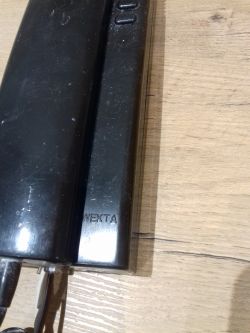

    I have a similar problem and I don't know where to find the answer, so I'm writing here.
    I am asking for help in connecting the CYFRAL SMART 5P in place of WEKTA, unfortunately I do not know the model.
    Stara Wekta worked properly, only when you picked up the handset when it was too close to the camera, the sound was aroused and it squealed both in the handset and at the bottom. I attach photos of both cameras. Replacement of the intercom in the apartment - in a high-rise building Replacement of the intercom in the apartment - in a high-rise building Replacement of the intercom in the apartment - in a high-rise building
  • #7 17376388
    zybex
    Helpful for users
    Posts: 15919
    Help: 2094
    Rate: 2939
    It's the Vector TK6. From the left, it has in turn:
    1 - call
    2 - mass
    3 - handset
    4 - microphone
    5 - lock
    6 - lock

  • #8 17376412
    bobek.1
    Posts: 14
    Rate: 19
    Thanks for the quick reply. However, I am asking for a blade, i.e. which cable from WEKTA to which in CYFRAL.
    Thank you in advance and best regards.
  • #9 17376452
    zybex
    Helpful for users
    Posts: 15919
    Help: 2094
    Rate: 2939
    Cyfral has conclusions:
    MASS - mass
    RING - calling (bell)
    SPK - handset (speaker)
    MIC - microphone
    SW1 - lock (button)
    SW2 - lock (button)
    Set the jumpers as described.
  • #10 17382398
    bobek.1
    Posts: 14
    Rate: 19
    Many thanks again to
    zybex. Everything works as it should, but I had to bridge the ground with SW1.
    Regards Replacement of the intercom in the apartment - in a high-rise building

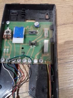

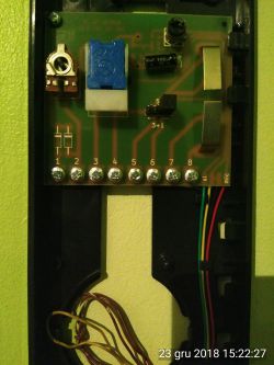

    Gentlemen, specialists, and how to replace it:
    For this:
    Thank you in advance :)

    In the old one, see the markings. Not all of them can be seen in the photo posted.
    So far it shows:
    ZW - call
    SL - handset
    MC - microphone
    Z1 - button
    Z - button
    The description of the ground terminal is not visible, but there is probably a symbol under the cables.
    Here is the same marking of terminals (illustrative photo).
    The new one is Wekta TK6.
    1 - call
    2 - mass
    3 - handset
    4 - microphone
    5 - button
    6 - button

    Note that on this PCB from the first photo, the Z1 pin has only a piece of wire, the incoming cable has no free wire, so why don't I know this - the bridge and where to connect it?

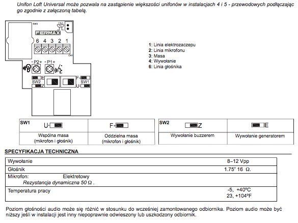

    Gentlemen, and I also have one question.
    How to connect a new FERMEX uniphone, model LOFT, which is for 4 or 5-wire installation, and in my block I have a 6-wire installation.
    The intercom that was connected was Urmet. All 6 wires were clipped and the bridge on board 6-10 was cut.
    At the moment, I can open the lock at the bottom, I have a calling tone, but no up-down conversation.
    There is also a jumper to set the operating mode - common ground / ground separation - but how does this relate to the fact that there is only one terminal to ground?
    Maybe someone will suggest ...?

    The picture above shows that the uniphone has five terminals. You need a sixth. This sixth is to go from the button. At this time, one end of the button goes to terminal "1" and the other end is connected to ground. You would have to isolate this contact by crossing the path. Then connect the sixth cable from the installation here. The easiest way is to solder an auxiliary cable from the print side, which then needs to be connected to the one from the installation.
    As you probably notice yourself, you have the wrong uniphone, so you will either start to combine as suggested by zybex, or you will buy the right uniphone.
