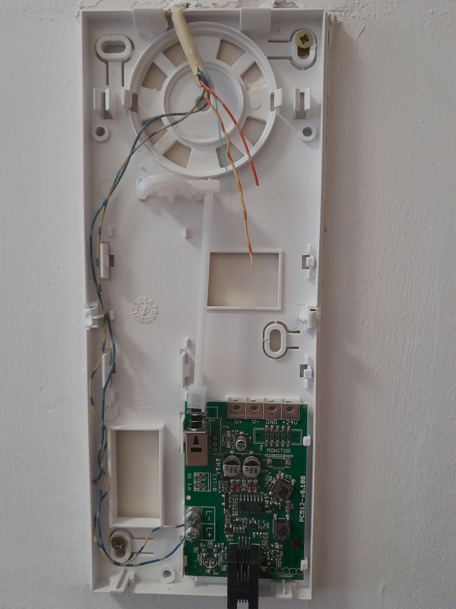

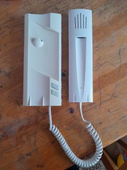

    After moving to a second flat, the intercom was not working. After replacing it with a new one of the same kind and connecting it the same way, it still didn't work.

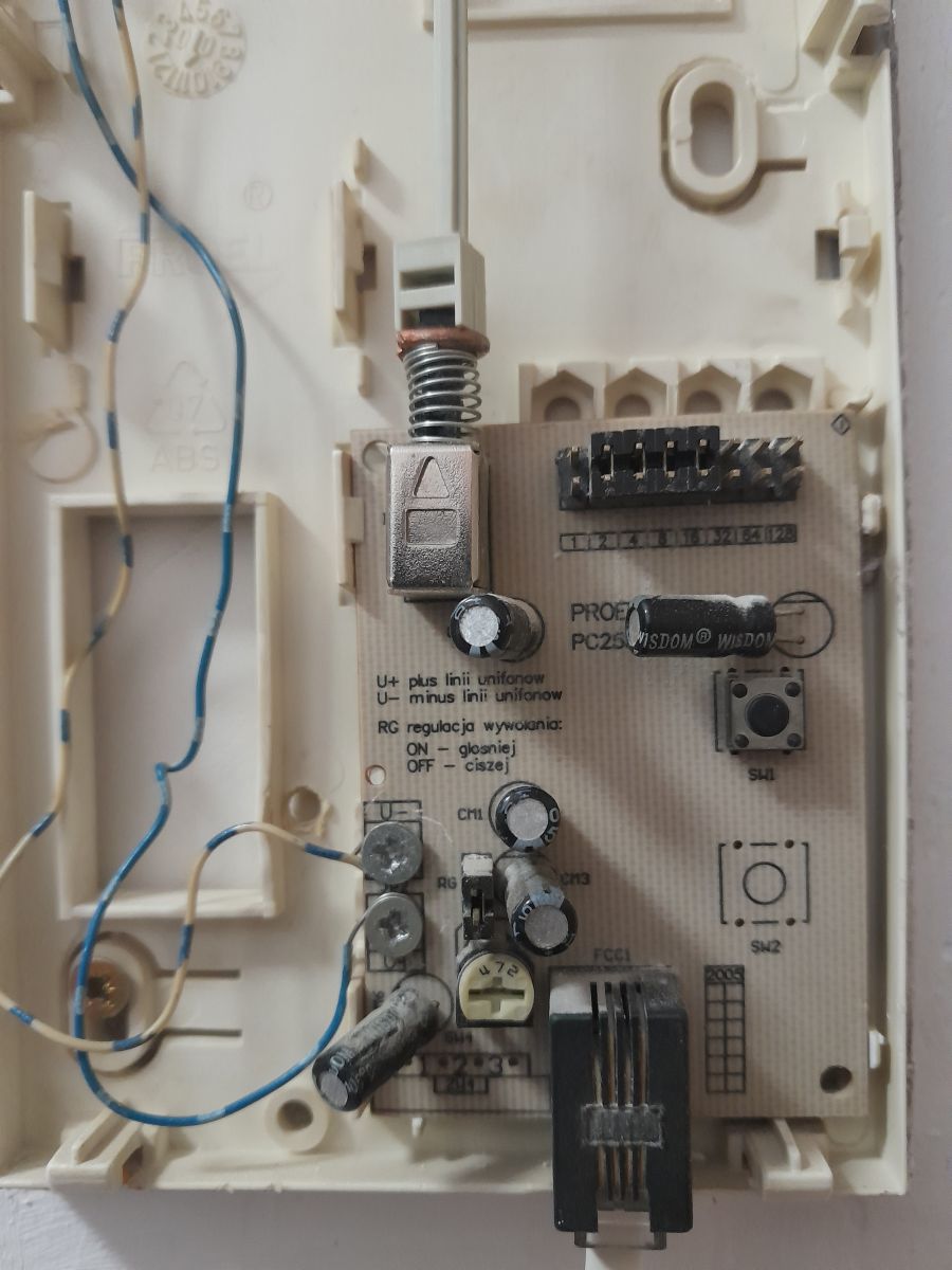

    I have a question, was the old one connected correctly, as I have two wires left?

    Could someone advise me, what to do with this before calling in some professional?

    Flat number set correctly?

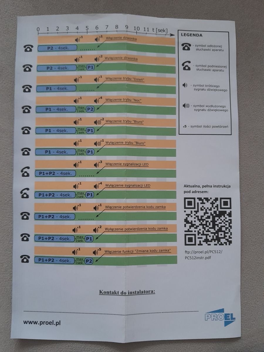

    The intercom new had instructions with the access address via QR code but I cannot open it. Intercom user manual with QR code and symbol legend. .

    This is a user manual, not an installer manual. For it to have a chance of working you must enter the flat number (it must know that you are calling it and not your neighbour). On the old one on the jumpers was the number 30, is this the flat number you have?
    Look at chapter 4 in the manual.

    Yes, the flat is number 30 and that is how the call is made. In the old one there was supposedly a signal in the flat but it was not possible to make a connection and open the door when a friend replaced the handset the signal disappeared completely.
    The two wires that were and are connected are sufficient for this intercom to work properly?
  • #9 20949904
    Zbych034
    Posts: 4698
    Help: 550
    Rate: 1418
    Yes two wires are enough. Set the address of the handset (read the manual point 4) and only then check.
