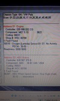

    I have a Vw polo III 6n2 2000. 1.4 MPI
    I still have a lambda probe error when I plugged in VAGA, There is an error, code: 16518 - Oxygen (Lamda) Sensor B1 S1: No Activity.
    Prose for help, it's the first mistake - the second one is now out of date.
    Which probe is not working properly? In addition, when I take the measuring blocks in this program - VAG-COM RELEASE 409-1, without changing the value and start the car, the car goes out, temp. 0.00 = 0.00. Why does it go out when I take "measuring blocks"? I delete the error, i.e. CHECK, but max 2 days and it lights up again. There is a chance that the sensor is good, only some wire is broken?

    Okay, if in the picture what I attached Controler: 030 906 032 CG - this is the probe number?
    If I had to buy, I found a used one and only look for such a number?
  • #5 16328025
    grala1
    VAG group specialist
    Posts: 9815
    Help: 1495
    Rate: 5049
    This is the engine driver number.
    You will find the probe number only on it or on the website after VIN.
    Buy only from the higher shelf.
    Bosch should probably be there.

    The engine you have AUD or ANW. The first probe is broadband. I have never encountered any substitutes.
  • #8 16328854
    jacek074
    Level 30  
    Posts: 884
    Help: 187
    Rate: 722
    After the driver number it comes out as an AUD engine. The first probe for this engine has no. 030 906 262 J

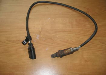

    yes yes the AUD motor and probe have 4 wires
  • #11 16329899
    grala1
    Posts: 9815
    Help: 1495
    Rate: 5049
    So if it has 4 it's normal and not broadband and you can check it with the meter as I wrote.
    Two white, black and gray cord.

    Give a photo of this probe's cube, maybe the installation has been modified. In AUD, the first probe should be broadband, the probe number I sent, selected from the elsa for this engine.
  • #15 16330945
    Kosaa123
    Posts: 27
    Rate: 24
    Something like that is
