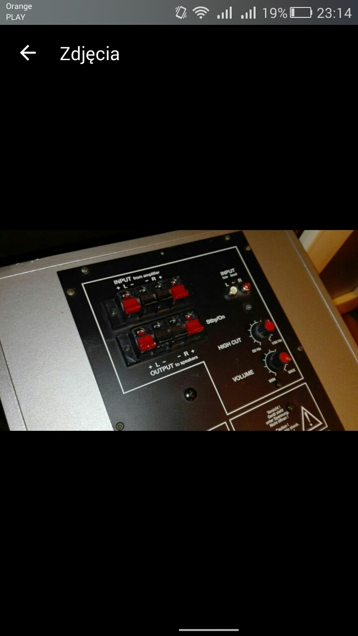

    Gentlemen, thanks for the answers so far, I attach photos, please look and make sure that I can connect this sub with no worries :-)

    #5 16328179
    sylweksylwina
    Posts: 13197
    Help: 1877
    Rate: 2341
    This is, so to speak, the grommet, the loudspeakers load the amplifier, and through the appropriate sub-dividers it "borrows" the audio signal. The amplifier will "see" the impedance of the speakers.

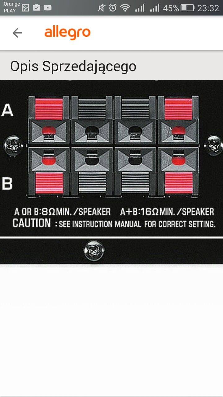

    Hello, one more question :)
    since there is no danger to connect the amplifier to the high-level subwoofer input (input from amplifier), I understand that it is possible to connect a subwoofer to the "B" output - this way you do not do a "pass" through the sub, only reach it with the signal directly from the amp - from the "A" output to directly power the speakers? Later, of course, have "A" + "B" turned on in the amp, I mean the solution as in the attached picture at the link: https://obrazki.elektroda.pl/ 2050288700_1488893507.jpg
    Thank you in advance.
    greetings

    #7 16329393
    Włodzimierz Wojtiuk
    Level 32  
    Posts: 1421
    Help: 231
    Rate: 272
    sylwester1970 wrote:
    Later, of course, have "A" + "B" turned on in ampla I mean the solution as in the attached picture
    Connecting 6 Ohm Active Universe Subwoofer to 8-16 Ohm Stereo Amplifier: Impedance Safety
    Electrically, the same (as long as A + B is a normal parallel connection), i.e. you can.

  • #8 16330259
    sylweksylwina
    Posts: 13197
    Help: 1877
    Rate: 2341
    And here is the problem, it is not known whether the amplifier connects in parallel or in series. Usually on the back of the amplifier there is a mention of the minimum impedance for sets A and B, A or B etc. It can be concluded after this whether the combined sets are in series or in parallel. Well, no one knows what amplifier it is.
  • #9 16330490
    sylwester1970
    Posts: 11
    This is a new basic Yamaha rs 202d ampli ... I think I have to look at it from the back because I don't know what it says ...
  • #10 16330514
    sylweksylwina
    Posts: 13197
    Help: 1877
    Rate: 2341
    By. instructions with sets A and B on, the minimum impedance is 16 Ohm per column. It turns out that they are connected in parallel so everything should work properly when connecting the subwoofer to the outputs of the second set.
  • #11 16330534
    sylwester1970
    Posts: 11
    Thanks. I found for sure still a photo of the back panel ... I hope. It is the end of my dilemmas ;) Take a look please ...
    • Connecting 6 Ohm Active Universe Subwoofer to 8-16 Ohm Stereo Amplifier: Impedance Safety Screenshot_2017-03-07-23-32-59.jpeg (355.81 KB) You must be logged in to download this attachment.
    #12 16330547
    sylweksylwina
    Posts: 13197
    Help: 1877
    Rate: 2341
    The instructions were enough, it coincides with the instructions. 2 sets of 16 Ohm in parallel give a net impedance of 8 Ohms. Plug in and check. It should work.
