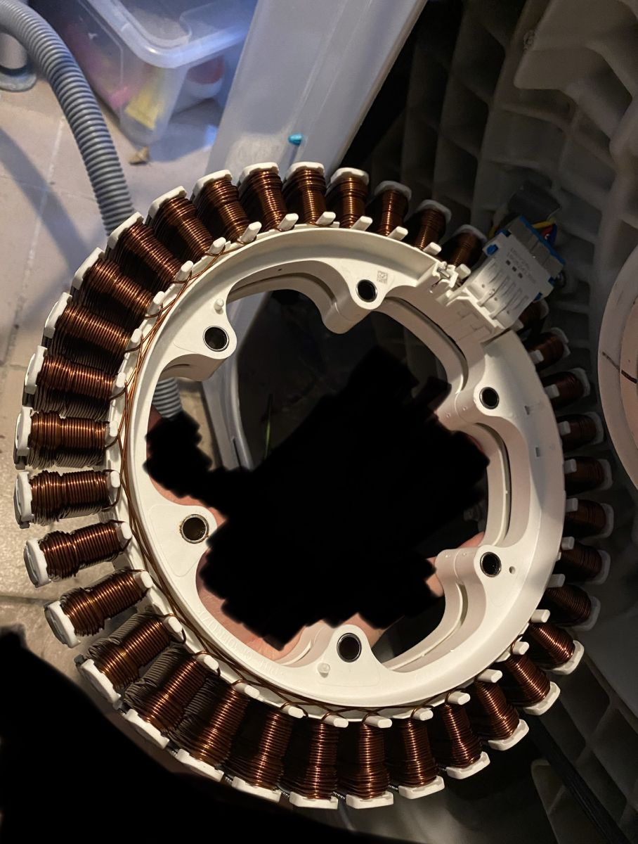

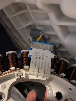

  • Hall sensor absent on replacement stator
    #5 20321543
    dawidosboss
    Posts: 35
    Rate: 7
    I know that the answer has already been given in this topic and everything would be ok, but after downloading the engine and disassembling it, I do not see the Hall sensor. In the photo you can see that there is a place for it, but it is not there and there is no plug either. My question is does every LG washing machine have this sensor and is it located in the same place?
    LG F12B9QD Washing Machine: Dealing with LE Error and Motor Overload Issues LG F12B9QD Washing Machine: Dealing with LE Error and Motor Overload Issues
    Here's what the original stator looks like:
    https://north.pl/karta/motor-stojan-for-washing machines-for-lg-f4j6tg0w,2E9-S2-C2M2-CV5.html
    And there is no Hall sensor there either. So where should I look for the reason that the engine does not turn under load?

    #6 20321552
    2139622
    Posts: 86
    Rate: 74
    It was a long time ago, but from what I remember the sensor was mounted somewhere outside the engine. You didn't have to disassemble the engine to get to it. It should also be in this washer dryer due to the fact that it is a BLDC motor, so the controller should know the position of the impeller. Although they are in the BLDC application without such a sensor (feedback), but in the washing machine I suspect that it should rather be found.
    In my case, after starting the washing machine program, the drum rotated about 5-10 degrees and stopped. There were two attempts and it was throwing a motor/drum overload error.

    #8 20321790
    dawidosboss
    Posts: 35
    Rate: 7
    "In my case, after starting a washing machine program, the drum rotated about 5-10 degrees and stopped. There were two attempts and it gave a motor/drum overload error."
    It's exactly the same for me. Only I bought it damaged, but no one knew what was wrong with it. I do not know if anyone has pulled something here before, because I clearly do not have this sensor and the plug that connects to it. There is only one plug for the stator. Can colleagues help me where to look for it, is it connected to the module? I can't find a sensor for this model on north.pl.
    So that's how my problem was solved after changing the engine to another one. It turned out that water from the leaking drum was dripping onto the motor winding and it was damaged.
    In fact, in this model, the Hall sensor is not present at the stator, only in the module.
    Regards

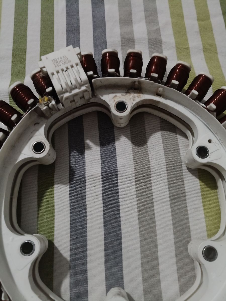

    #9 20612576
    forceout
    >>20321543
    Hi
    I got same situation in my LG WD-S16VBD. I don’t see hall sensor as demonstration in Youtube video. People said maybe LG changed to use sensorless solution
