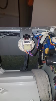

    The water level sensor was not able to measure the water level.
    Fault removal:
    Remove the upper cover (2 x Phillips screw on top of the washing machine and slide the cover backwards).
    Check the membrane pressure sensor, rubber tube (very important), electrical wires.
    In my case, a rubber tube (from drum vibration) has come out of the sensor's connector. I put it back and secured it with the band.
    The whole repair lasted 5 minutes.

    In my case, the hydrostat was damaged. But the exchange also lasted 5 minutes :)
