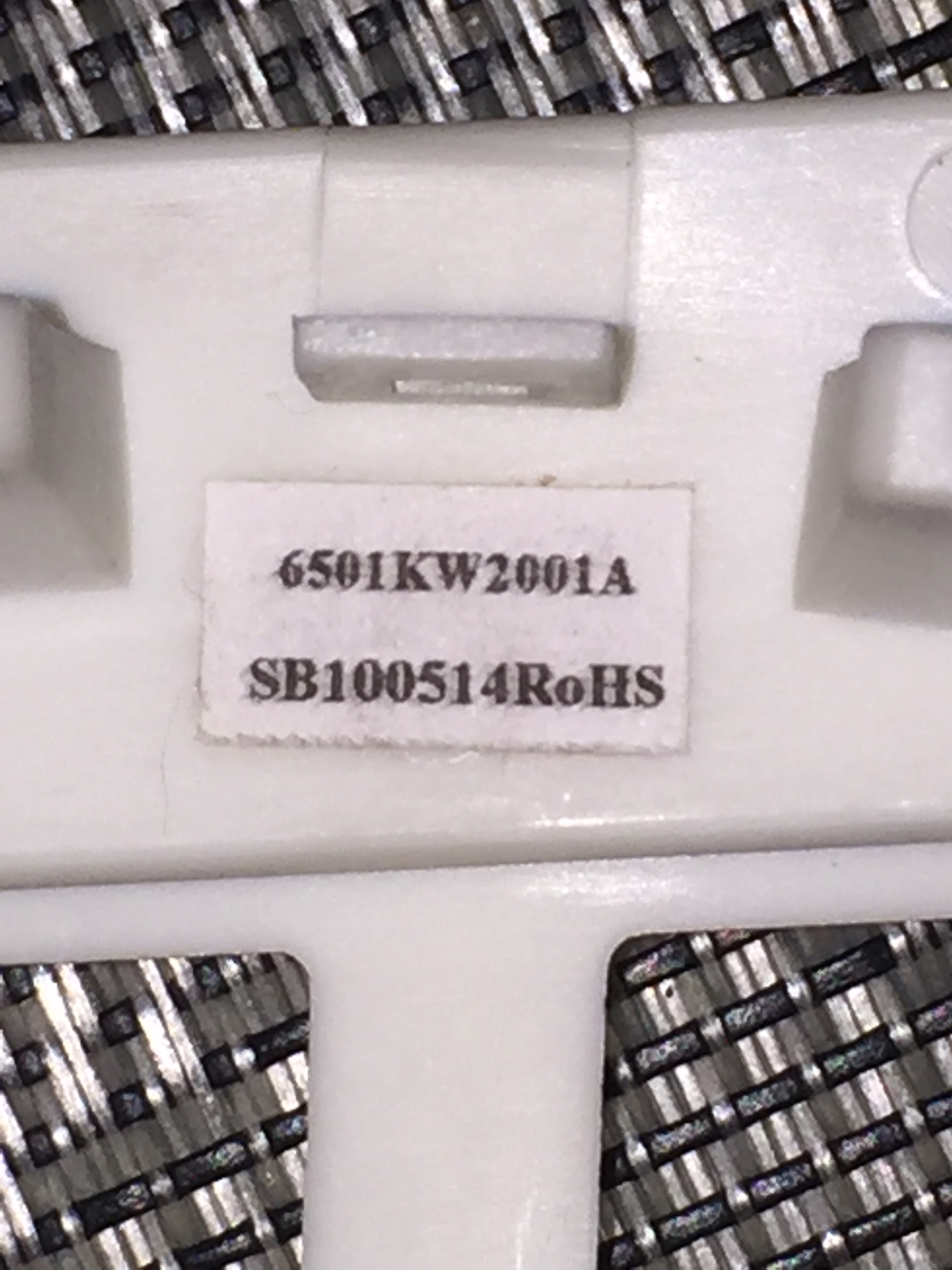

    I have a problem with the washing machine above. Could I ask you to express your expert opinion on the subject?
    It throws an LE error, but will that be a problem with the popular engine hall sensor problem? When watching other videos on YT, washing machines with this problem behave a bit differently.
    I will only add that the drum spins without much resistance. It wasn't some slow process of going bad, suddenly she started to squeal like a movie while she was working and that's it.
    I pursue the topic further. I got to the hall:
    LG F1222ND Washing Machine Engine Power Loss: Possible Hall Sensor Issue and LE Error
    Only where I get it now on Christmas Eve ;) if this sensor is the problem.
    After detaching the hall sensor, there is no difference, it works the same as in the video.
    However, it works when empty with an already attached sensor.
    The engine is so weak that after throwing in the clothes of a month-old baby after soaking, there is no force to turn the drum ;) but on 2 clothes it already works. Holidays will probably work 24/24 :D

    My friend, I still have some things to do with you, my washing machine works empty, when I hold the button responsible for spinning, the display shows the drum rotation. And now the question is whether the hall sensor is not also a rotation sensor? If so, it works fine for me. Could I ask you to check it at home?

    Replaced the hall sensor, nothing helped. I found a WD 10390NDK washing machine with a broken bearing nearby. Identical in appearance, also with the direct drive motor. Maybe someone knows if the lumber from that one will fit into my washing machine?

    The seller turned out to be an old colleague, I bought the module for 0.7 stumbras.
    The washing machine started, it works, nothing sizzles or creaks. I only did one test wash and the changes noticed:
    1. Another melody to signal the end of washing :D :D :D
    2. Water to the drum is not fed uniformly, as it was done before, only portioned on the principle of 1 second gives 2 seconds break, only after a few such cycles it starts to pour normally.
    3. After holding the "spin" button it does not show the drum speed
    4. I have a strange feeling that there is less water in the drum when washing, but maybe it's just an illusion, or maybe because that washing machine was 5 kg and mine was 6?
    In addition, it spins, rotates and vibrates, i.e. probably approx :)

    Replacing the module even from another washing machine apparently solved the problem. Thank you :)
