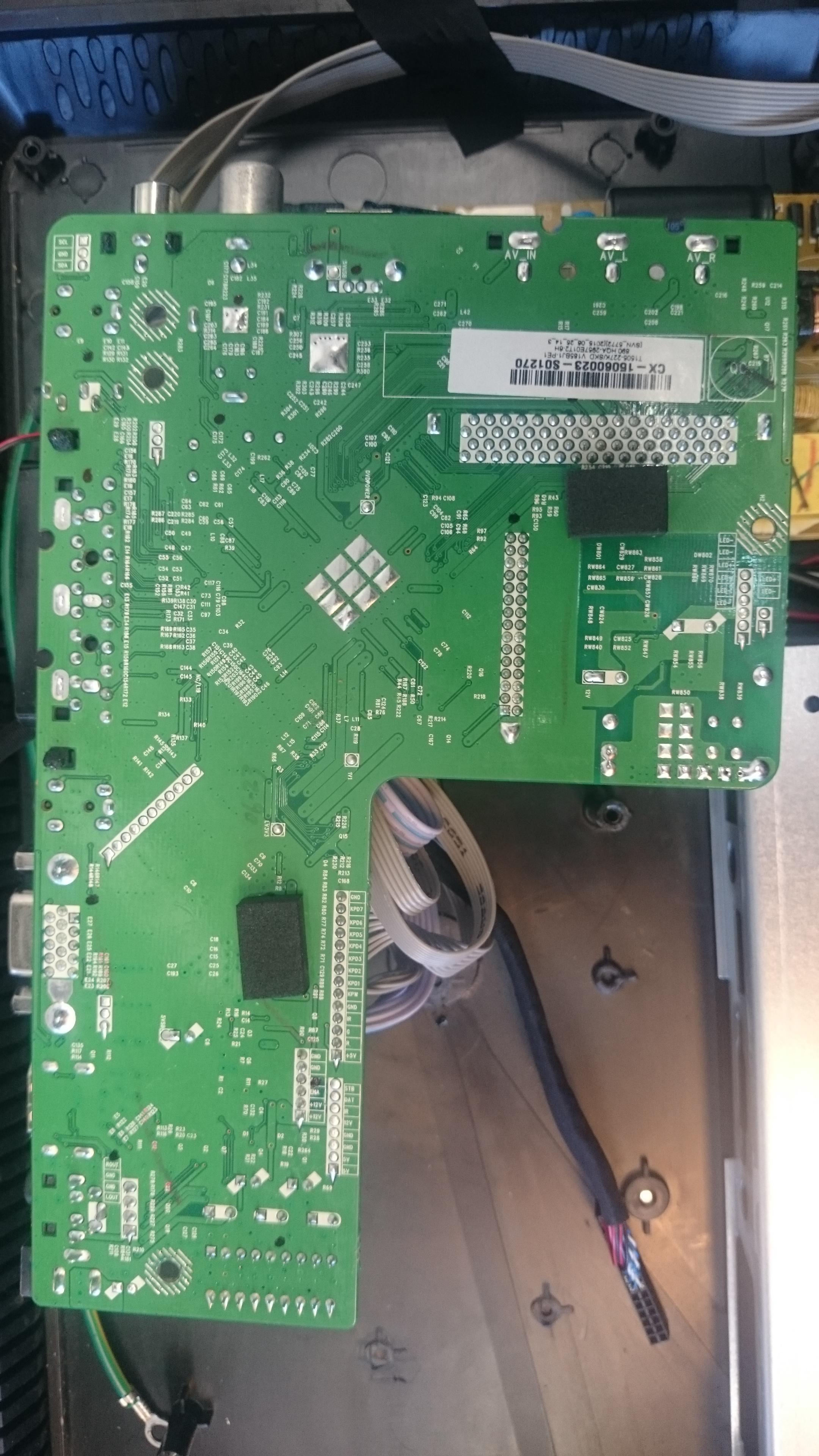

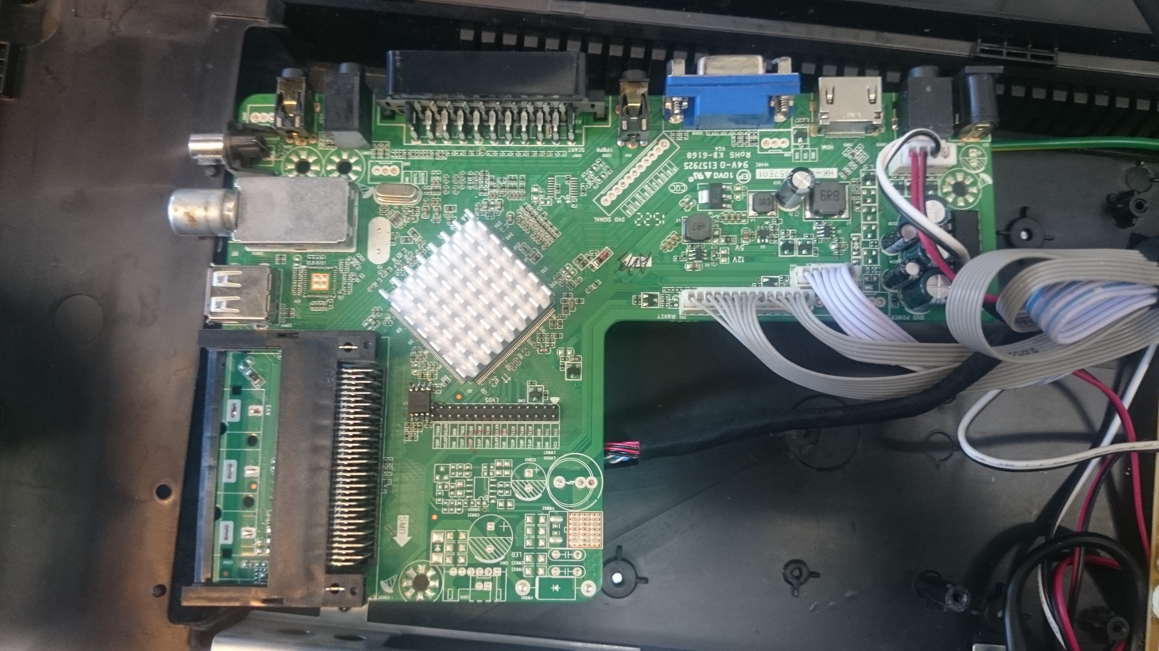

  • #5 16344979
    andre1111
    Posts: 23
    The above load does not fit after uploading with the programmer (memory chip 25Q64)
    After uploading to USB, it also does not update
    The manta logo appears on the TV every now and then - restart)
    Does anyone have a different load?
    best regards
  • #6 16345029
    Piotr2608
    Posts: 5386
    Help: 851
    Rate: 4487
    Up to 8MB of memory does not fit 4MB batch? What is the problem with programming the memory?
    ZimTech Piotr Zimny
    Przy Bażantarni 13/31A, Warszawa, 02-793 | Tel.: 666-XXX-XXX (Show) | Company Website: https://zimtech.com.pl
  • #7 16345105
    andre1111
    Posts: 23
    There is no problem with programming - only after programming the TV does not turn on at all.
    best regards
  • #8 16346971
    andre1111
    Posts: 23
    The case looks like this:
    after uploading the batch from LCD 2403, the TV turned on normally, but the screen was upside down and the colors were wrong (also clearly the batch's fault)
    I also found an 8mb batch from 1903, but there was a different disc model in it and after uploading the tv did not turn on
    So that it continues to look for the right load:
    Pictures of my album:
    Manta LED1903: Seeking Batch/Update, CV9203L-A Board & CX185LEDM Matrix - Payment OfferedDSC_12..JPG (3.25 MB)You must be logged in to download this attachment. Manta LED1903: Seeking Batch/Update, CV9203L-A Board & CX185LEDM Matrix - Payment OfferedDSC_12..JPG (857.46 kB)You must be logged in to download this attachment.
    best regards :)
