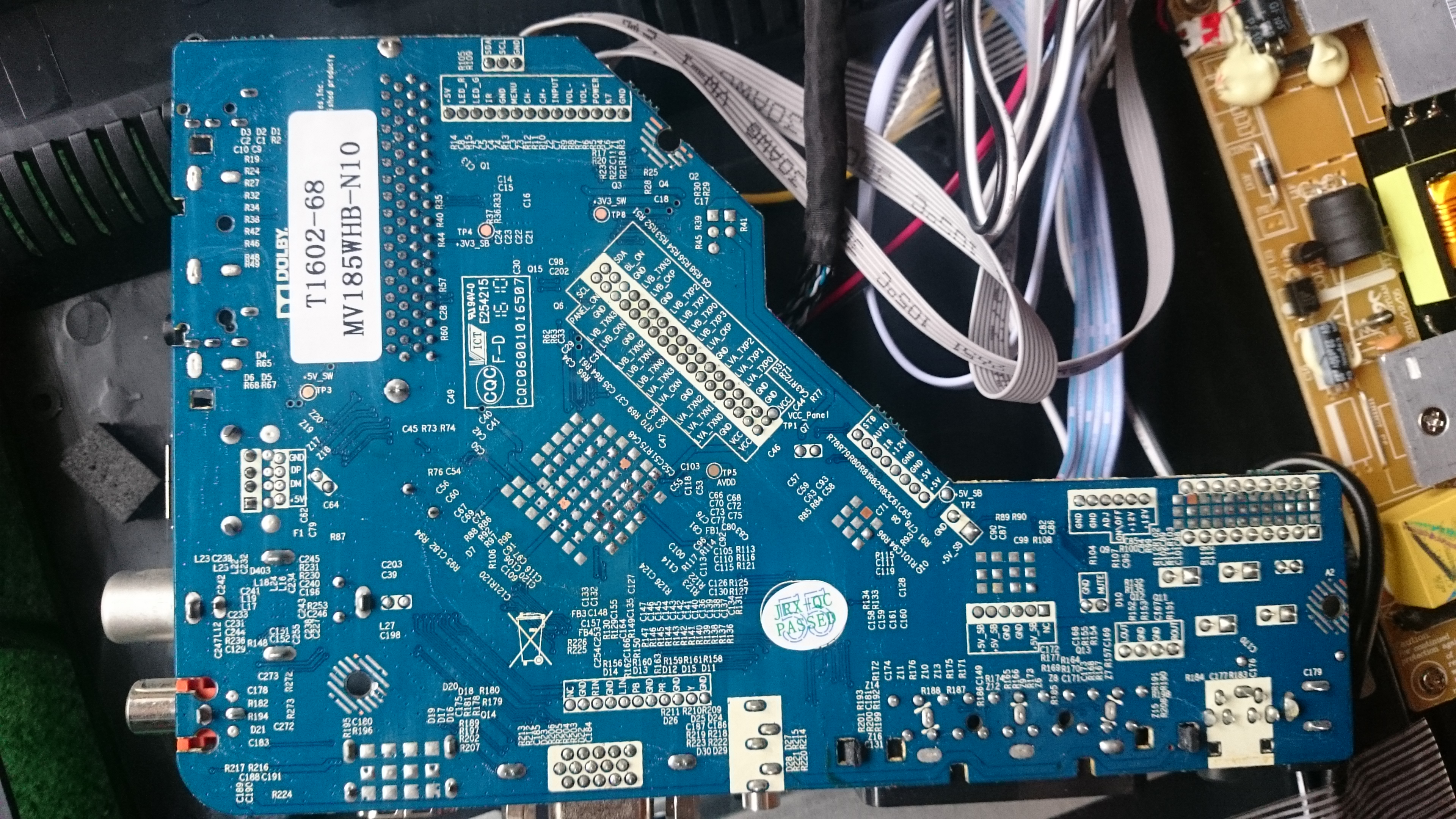

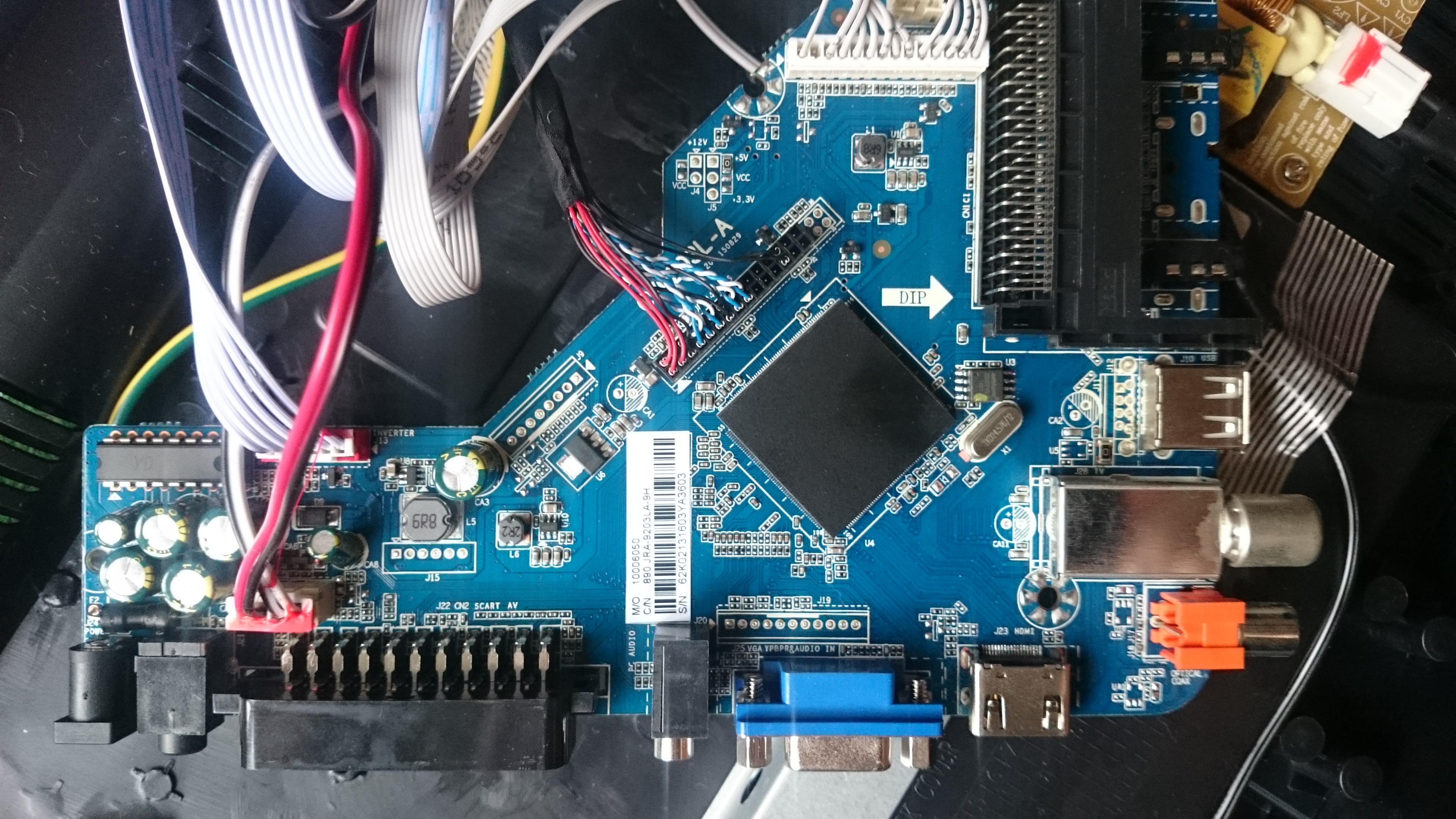

    Hello. Looking for SPI U3 / W25Q32FV memory chip, CV9203L-A motherboard, CX185LEDM matrix. The electrode offers several solutions, but none of them works. The red standby LED is lit and there is no response to the remote control.
    • TV LED MANTA LED1903: Seeking SPI U3/W25Q32FV Memory Chip, CV9203L-A Motherboard, CX185LEDM Matrix DSC_2898.JPG (3.54 MB) You must be logged in to download this attachment.
    • TV LED MANTA LED1903: Seeking SPI U3/W25Q32FV Memory Chip, CV9203L-A Motherboard, CX185LEDM Matrix DSC_2899.JPG (3.86 MB) You must be logged in to download this attachment.

  • #3 16721554
    Piasecki Bogusław
    Posts: 1368
    Help: 158
    Rate: 317
    Input installed - the TV starts only from the keyboard and I have a sound, no backlight matrix and video content.

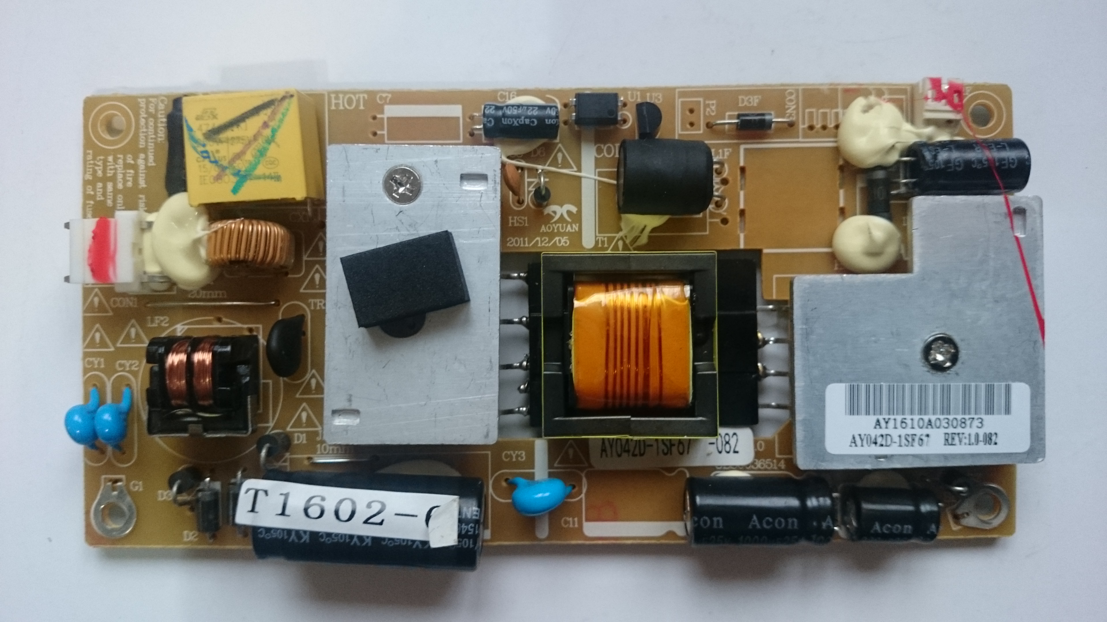

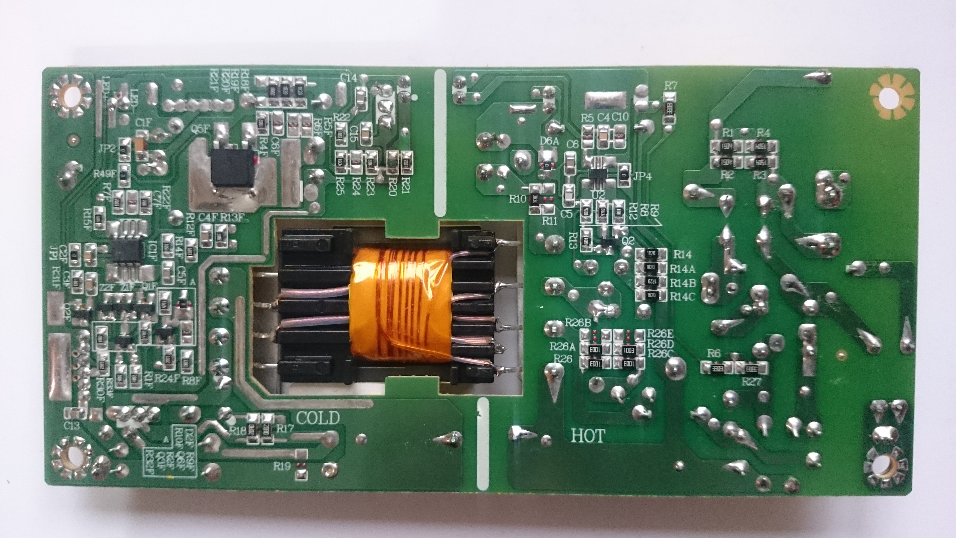

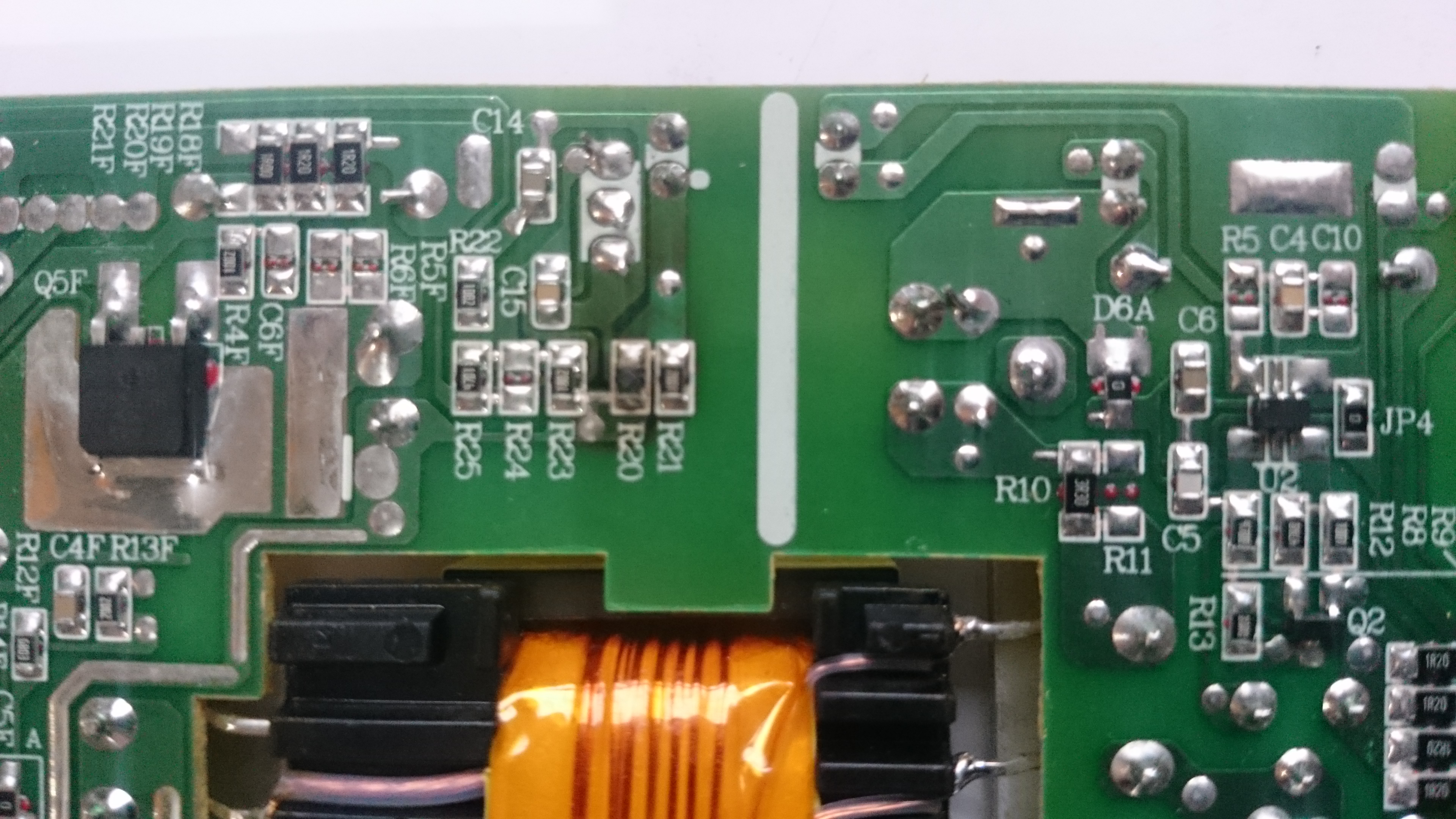

  • #8 16908520
    Piasecki Bogusław
    Posts: 1368
    Help: 158
    Rate: 317
    It can not work properly, because the R20 power supply is damaged in the AY042D-ASF67 power supply.
