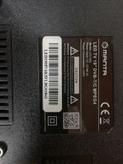

    Manta LED1905, the logo appears and goes into standby.
    Need a memory or software flash drive.

    I understand that this is a USB stick because SPI is 25Q64.

    Hello. I am also looking for a TV Manta LED1905v3 batch.
    Motherboard HK-RT.TRT2957E01
    MV185WHB matrix
    25Q64 memory
    After writing an email to serwis(_at_)manta.pl I got the answer that they do not provide software. I see that FTP Manta has started but you need a login and password.
    Anyone have a charge for the above model? I already have a new memory and programmer.
    Thank you in advance for your answer.
    greetings

  • #11 16935291
    janusz4387
    Posts: 14
    Hello, I have a similar problem with led1905. I saved my memory with a batch
    from manta led3204 HK-T.RT2957P61 board, TV works but the image is inverted by 180 degrees,
    and the keyboard has swapped functions. Please, if someone has a charge for manta led1905
    HK-T.RT2957E01 motherboard for sharing,
    or sending an e-mail> janusz4386(_at_)wp.pl <
    very urgent, best regards janusz4387.

    macius125
    Top Service. After purchasing the appropriate memory, the TV works. I had such an adventure that it was impossible to program the memory. It was the same all the time. After downloading the appropriate memory from the Chinese TV works. Thanks for the batch. I gave Plusik. As if what I have a few relevant layouts. I can also program. And send for the brewery ;-) greetings

  • #17 17092927
    Top Serwis
    Posts: 1521
    Help: 66
    Rate: 242
    TV repaired by replacing the memory.
