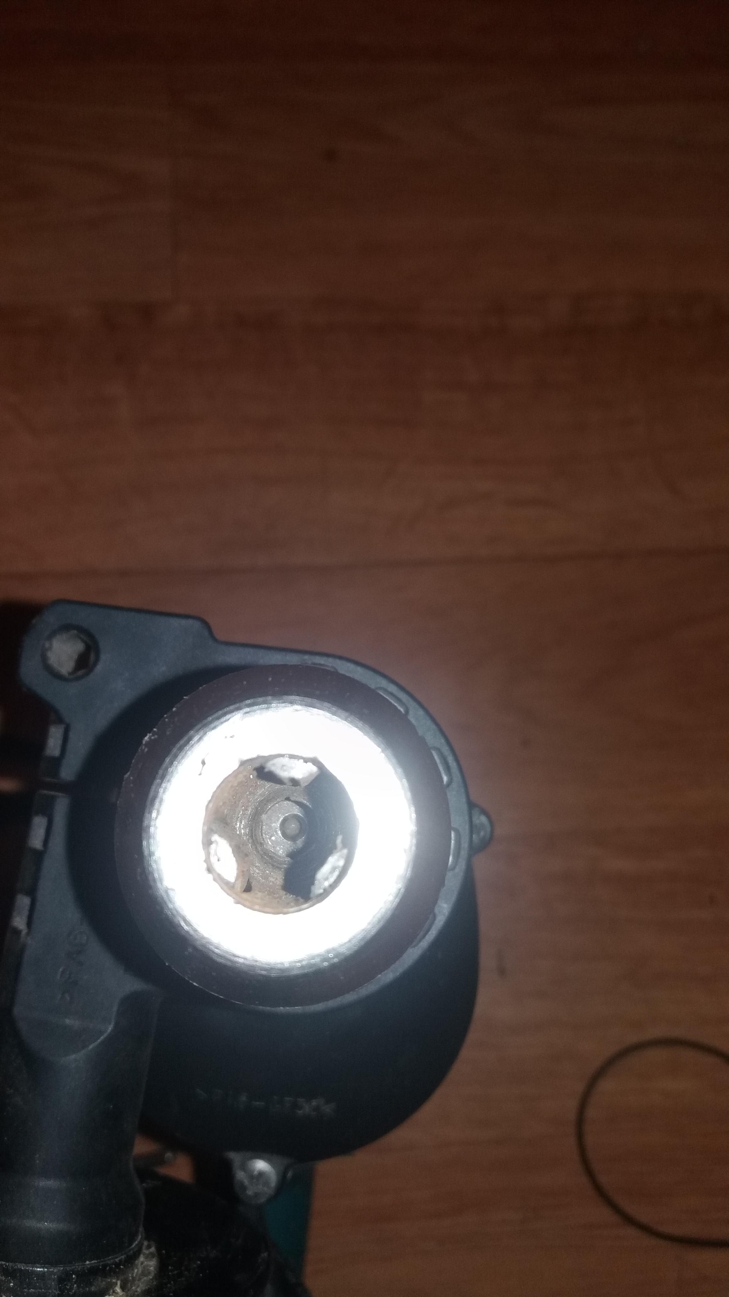

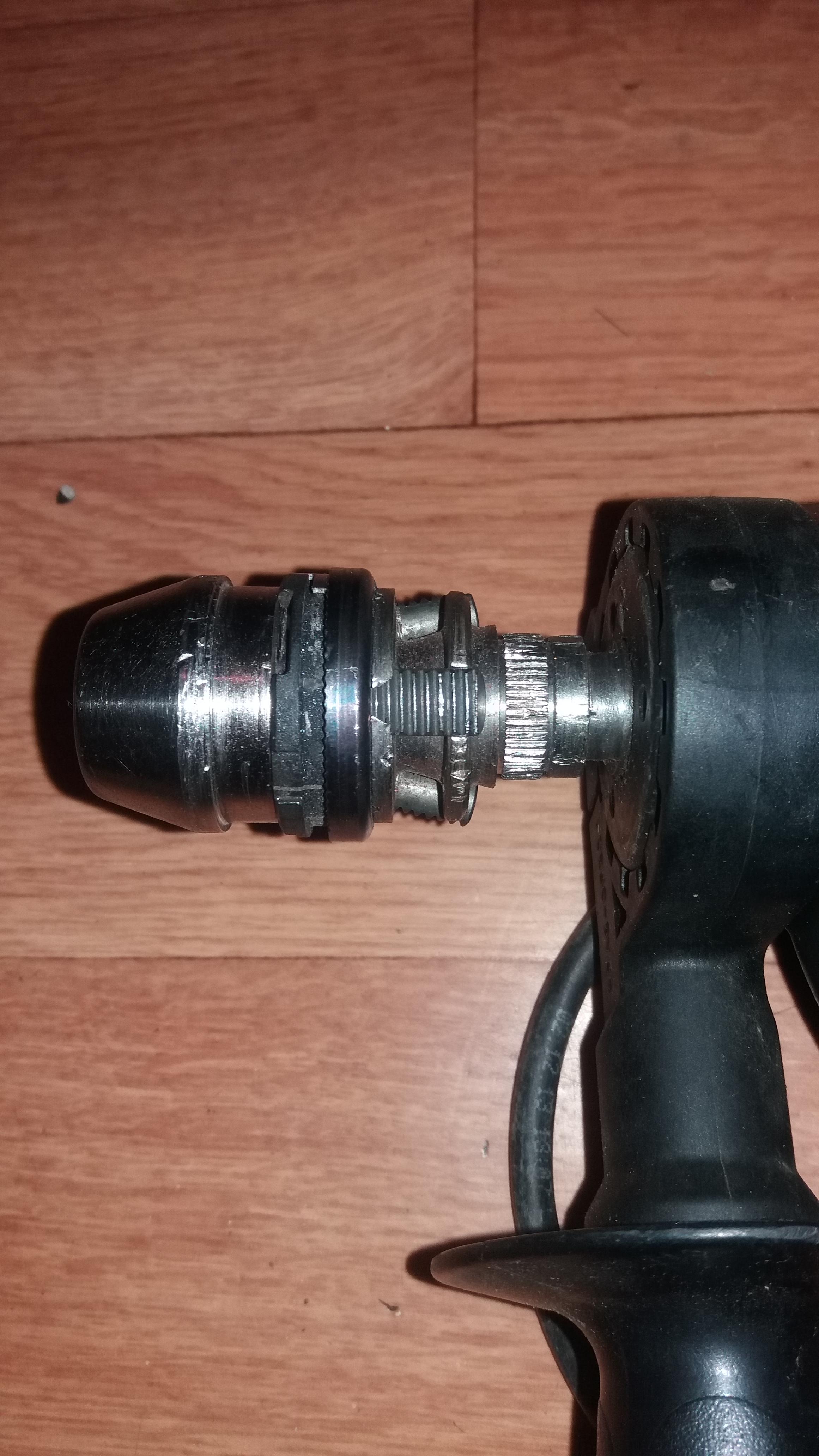

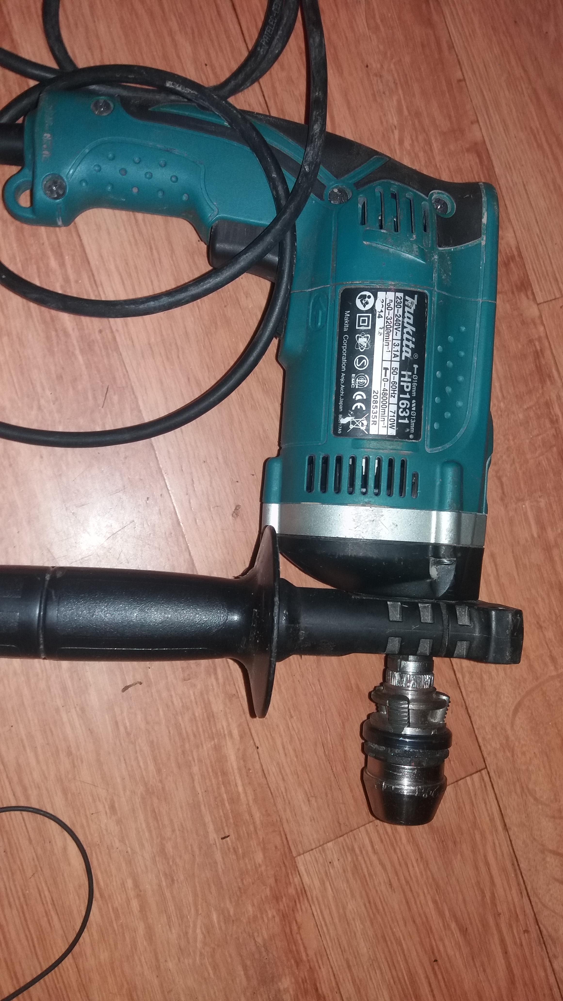

    Hello, I have a makita HP1631 drill and I have a problem with unscrewing the drill chuck
    please help quickly !!!!

    Get it, I'll unscrew.
    After all, you can see the indentations for the key - 17 or 19, you catch the remnants of the handle in a vice and turn it to the left.
