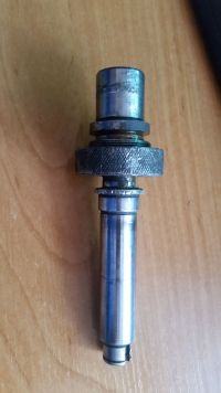

    Hello. He needs help taking the drill chuck off Celmy's drill and swapping it out for a newer one. I managed to dismantle part of the handle, but I have no idea what to do next. The shaft does not give up when I try to knock it out, and it also does not twist. The current handle is up to the diameter of the Fi 10 drill, which makes it much more difficult to work with larger diameters.

    If I am not mistaken, because it may be a different type of drill, there is a screw with a left-hand thread in the middle of the handle, you need to unscrew it.

    Unfortunately, there is no screw inside. There is only a center after turning the shaft. It looks like you have to kill him, but he doesn't want to go down for the hell: /

    Anyway, I managed to break the handle by force. It was mounted on a cone. Subject to be closed
